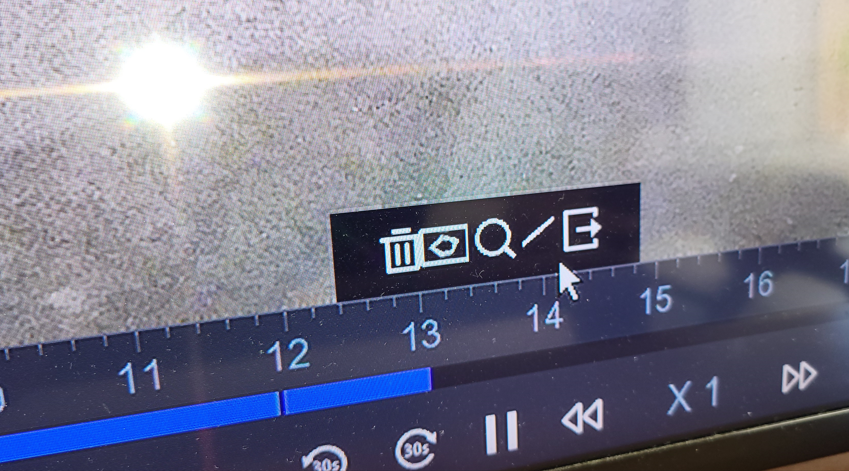

The Rules selection buttons on Playback-Normal-Smart search (by rules) are once again occasionally mixed and no search can be performed.
Normal playback Rules smart search Motion Detection search is missing.
Event playback space Rules smart search Speed Up, Speed Down controls x2 x4 x8 x16 controls are missing.
In Search tab after searching e.g. Event for one camera and want to go back search another, there is no option to close the previous window or go back and you must select another option e.g. Human and then go back to search for second camera Events.

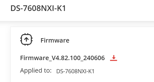

Everyone who wants to Update with this Firmware must know that this firmware cannot be rollback. Not even to 4.82.xx previous firmwares.
Also the Playback-Normal search issue with search by rule buttons became worse and daily issue. Sometimes I need to reboot....
