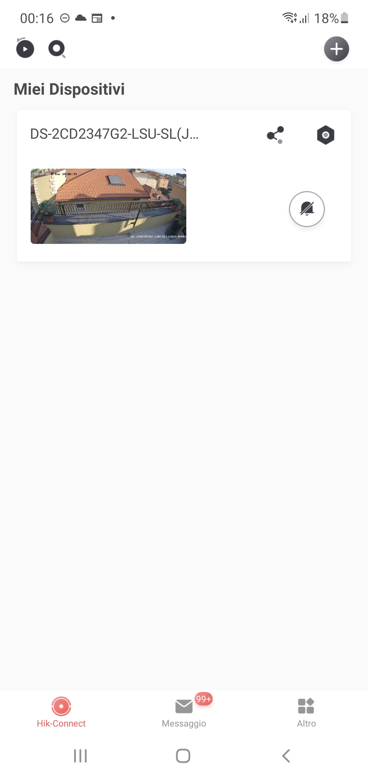

HI, I have bought the Acusense ColorVU LSU/IS camera because accoding to the Hikvision flyer they have "Active strobe light and audio alarm to warn intruders off".
I am not expert.. but looking in internet now I understand that to arm/disarm this function, you should install a so called "live guard" firmware which works just if you buy also a NVR (which I can not because I have no space for it.. I just have a SD card in the camera).
I think the information on the HikVision flyer is very misleading...!!
is there any other way to arm/disarm the Audio Alarm when I enter back my home ? Well.. of course I could switch on the PC everytime I come back home to disenable the siren from the browser but it is really not a practical solution :(

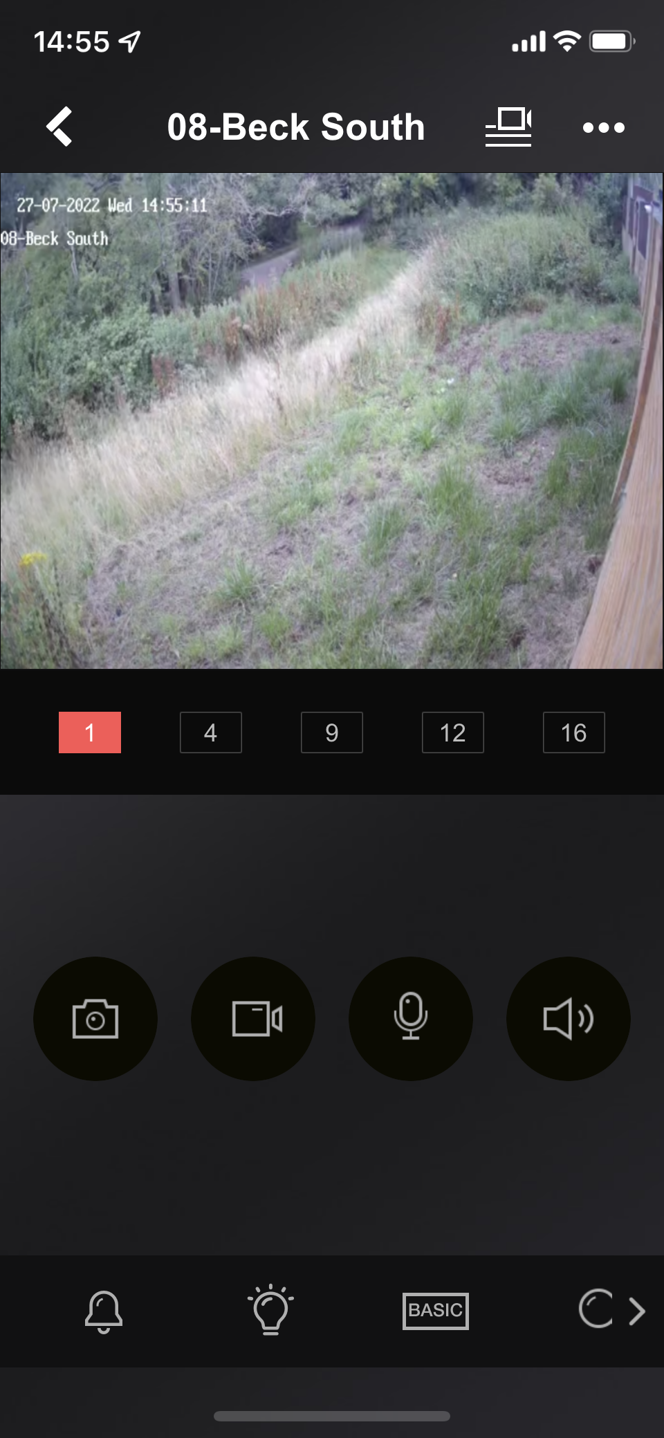

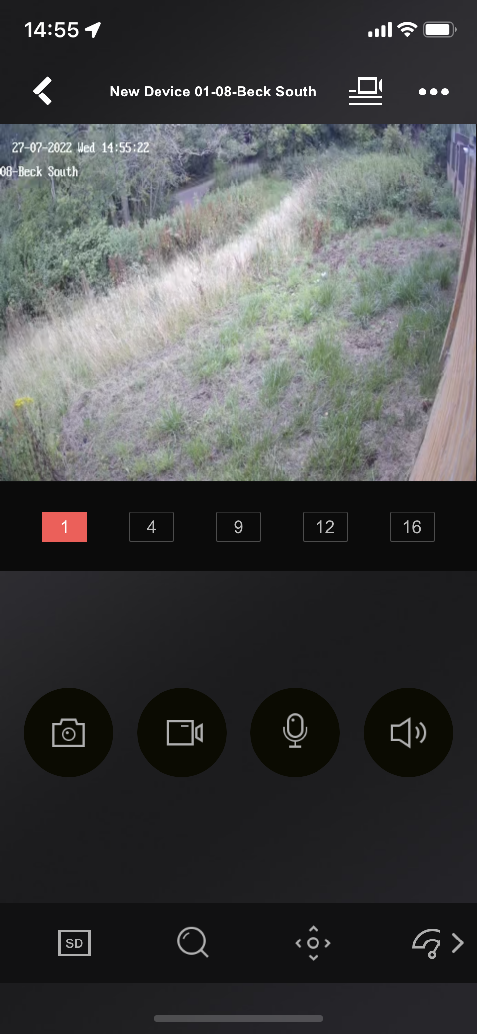

The other requirement is that the camera is registered with the Hik-Connect service and your Hik-Connect app is logged into the Hik-Connect service. Push notifications and the ability to manually trigger the siren or strobe are dependent on the Hik-Connect service. See the two images below of my system. In the first image I'm connected to my system using the Hik-Connect service and you can see in the lower left corner the two icons that manually trigger the strobe and audible warning. In the second image, I'm connected directly using the systems IP address and you can see the icons needed are missing. There's no way around this. To get full functionality - push notifications, manual activation of siren/strobe, event clips etc you have to use Hik-Connect.

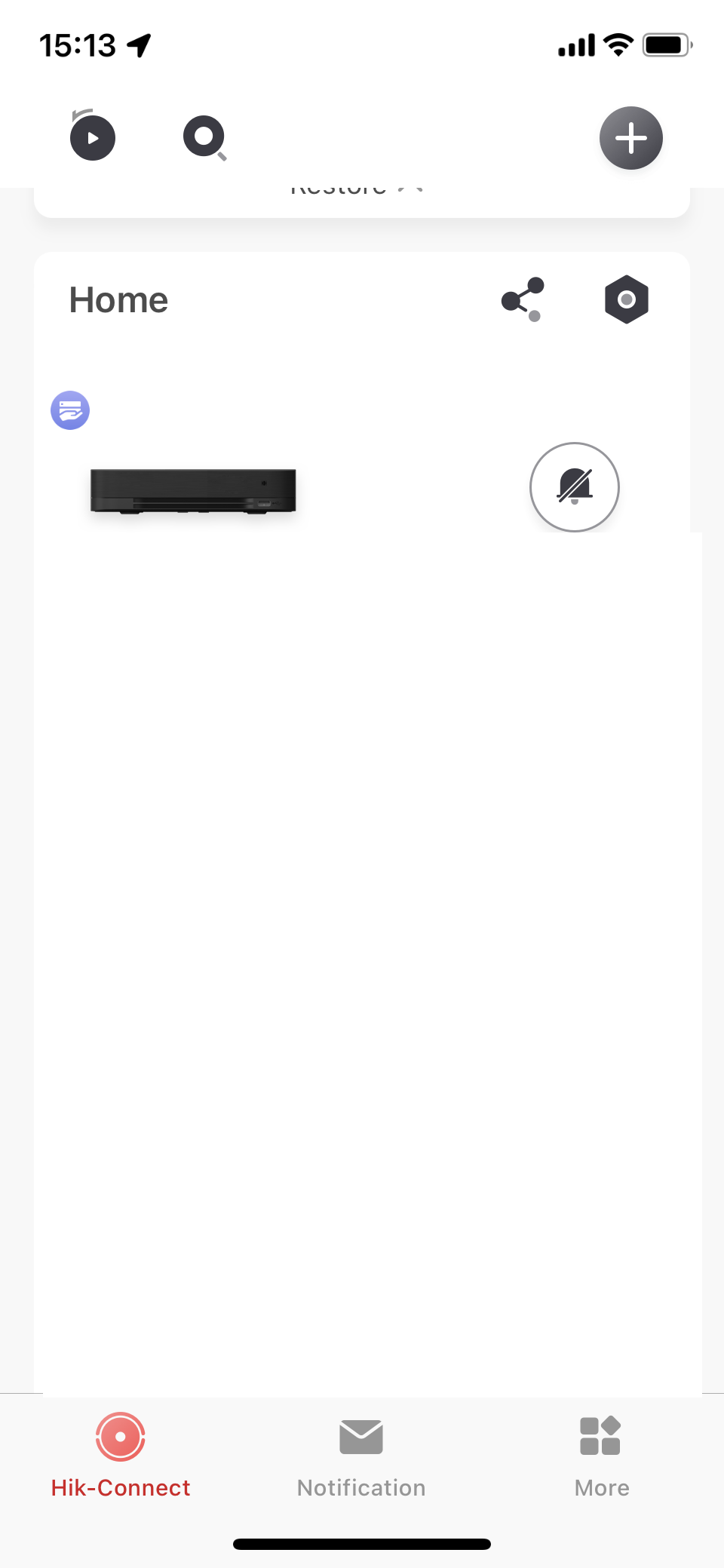

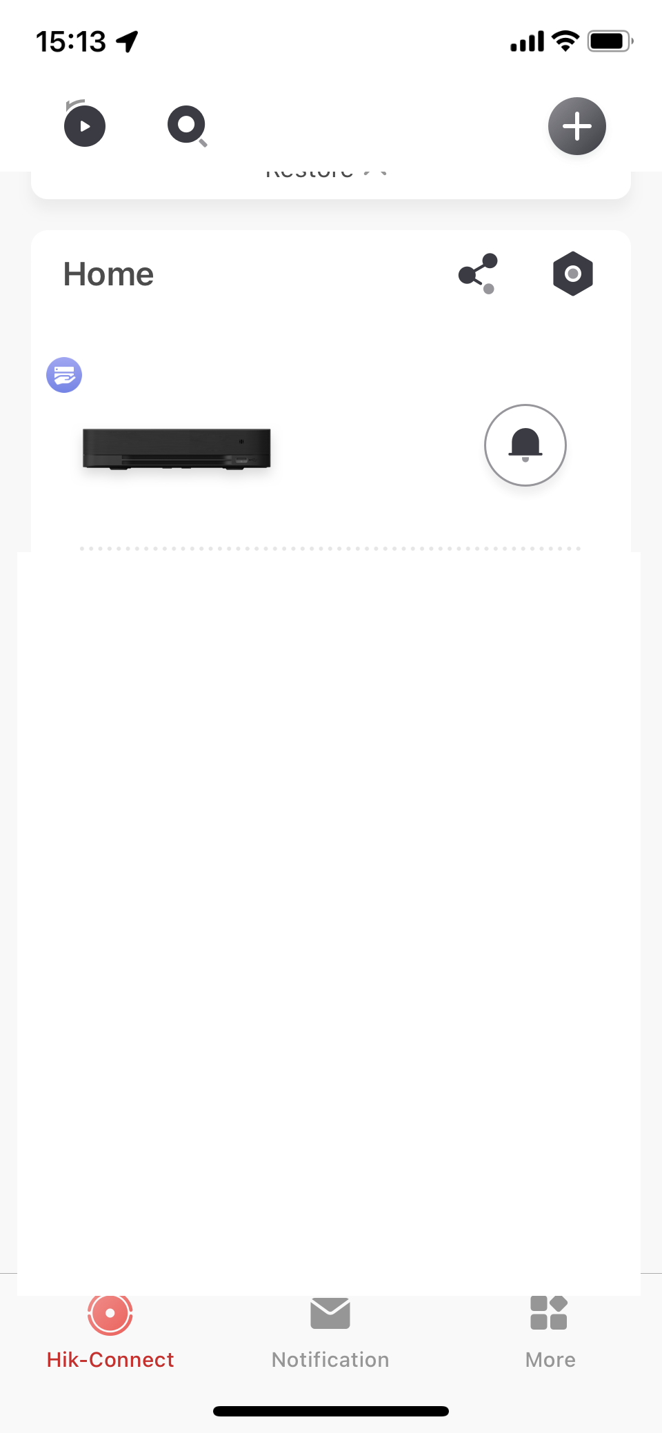

Edit: Just re read your original post. I was referring to manually triggering the alarms but you are wanting to disable the alarms. I don't use the audio alarms but clicking the bell icon next to your camera in the app should enable/disable both push notifications and audio alarms with one click. But again this is only available if you are connected using the Hik-Connect service and the bell icon won't be present if not.
- With the bell showing normal you will receive events and push notifications to your phone and audio and light alarms are enabled on the camera.
- With the bell showing a cross through it you will receive events to your phone but not push notifications and the audio and light alarms are disabled on the camera.
Thanks for your reply !! clicking the bell icon next to my camera in the app just enable/disable push notifications ...siren will keep working making "impossible" for me to enter back home

Hi guys, i am sorry...you are actually right.
The siren and the strobe light can be disarmed with the bell icon as you suggested ! I thought I tested but I did not and I was in someway mislead by the video in life guard website that say the NVR is needed.
For info I have firmware v5.7.10build220608 and Hikconnect 4.23
