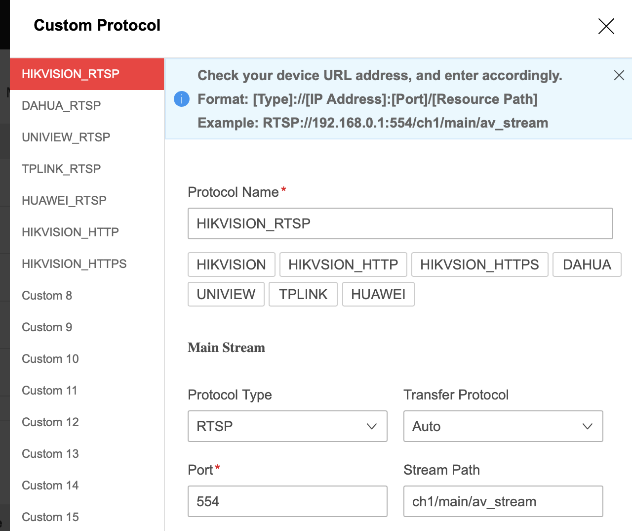

Though technically possible, I'd say adding remote cameras to a local NVR over t'internet I likely to be a non starter unless you have a symmetric fibre service.
There are a couple of ways it could be achieved:
1 - A site to site VPN
2 - Adding the cameras via RTSP. Depending on the NVR, you can add a camera using custom RTSP url and you can set the port in that url to whatever you want. At the remote end you would either alter each cameras RTSP port and do a one to one port mapping in the router, or you could use port triggering to map each alternate RTSP port to 554 on each camera.
