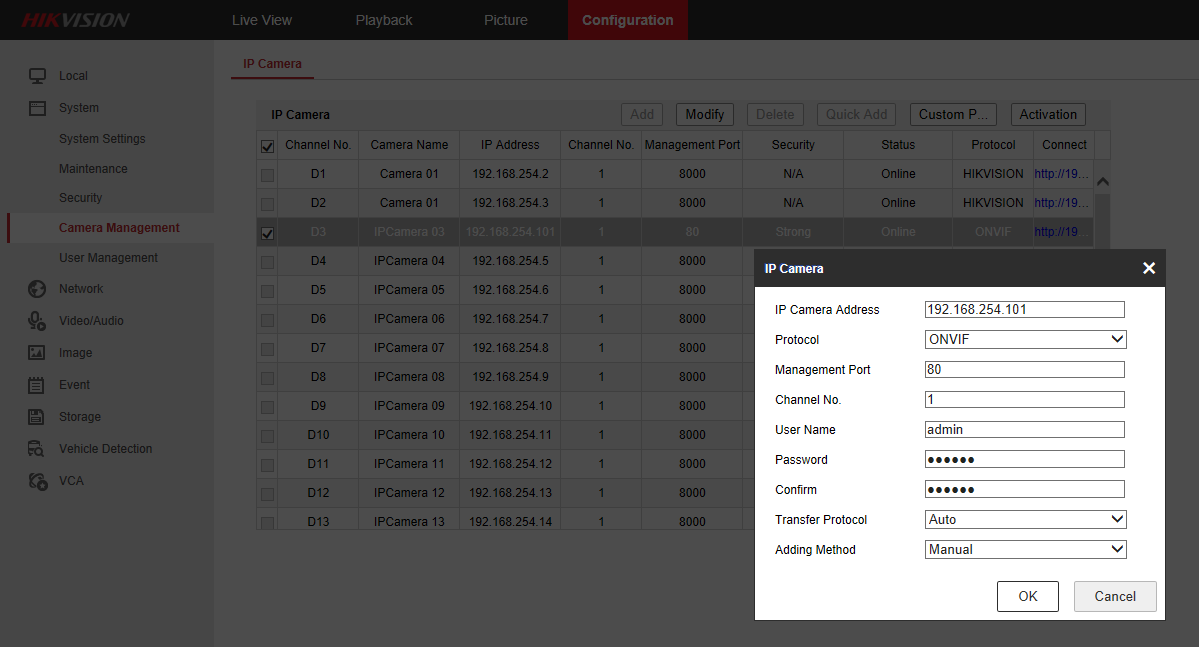

  11. Navigate to Configuration -> Camera Management.
  12. Select the row in the camera list for your newly added camera. Initially you are likely to see a password error message.
  13. Click Modify. Change the 'Adding Method' from 'Plug-and-Play' to 'Manual'. Type-in the camera's password (twice) - which we set in an earlier step to be the same as your NVR's password. Click OK.

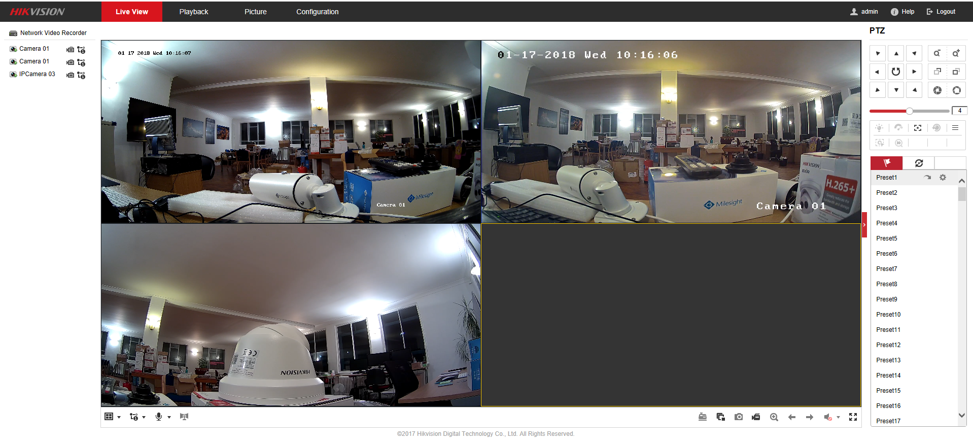

  14. The NVR should now connect to the camera via ONVIF and you should be able to see a live stream from the camera in the NVR's Live View.
