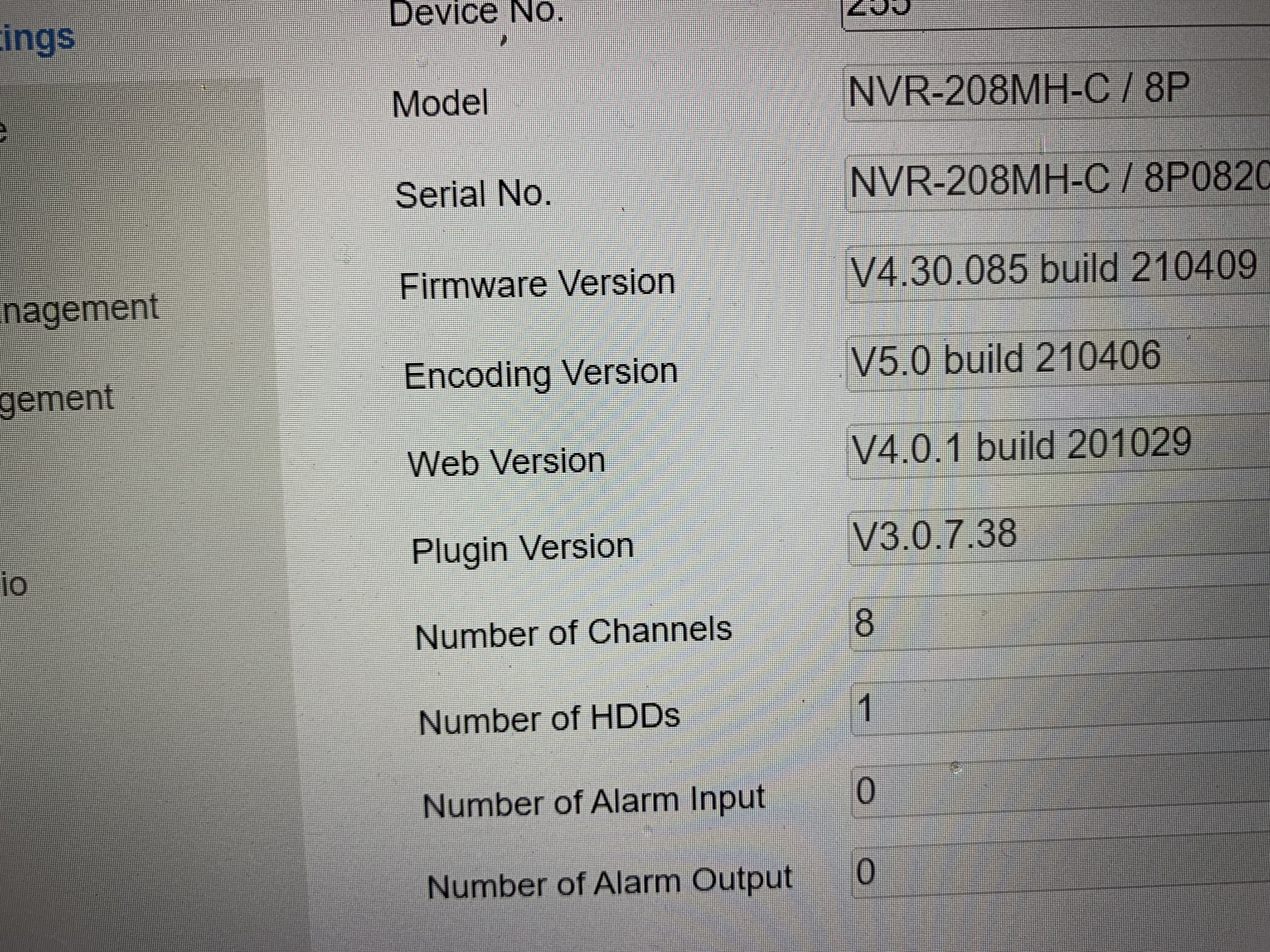

Can you go to Configuration > System > System Settings > Basic Information and share a screenshot of the model & firmware information on that page?
I was thinking more likely a mismatch between the cameras and the nvr than the wrong firmware . I’ve never updated the camera firmware, only the NVR’s.
Attached , thanks
Okay,
Maybe try downgrading the NVR firmware to v4.30.061 and see if that fixes the virtual host links.
