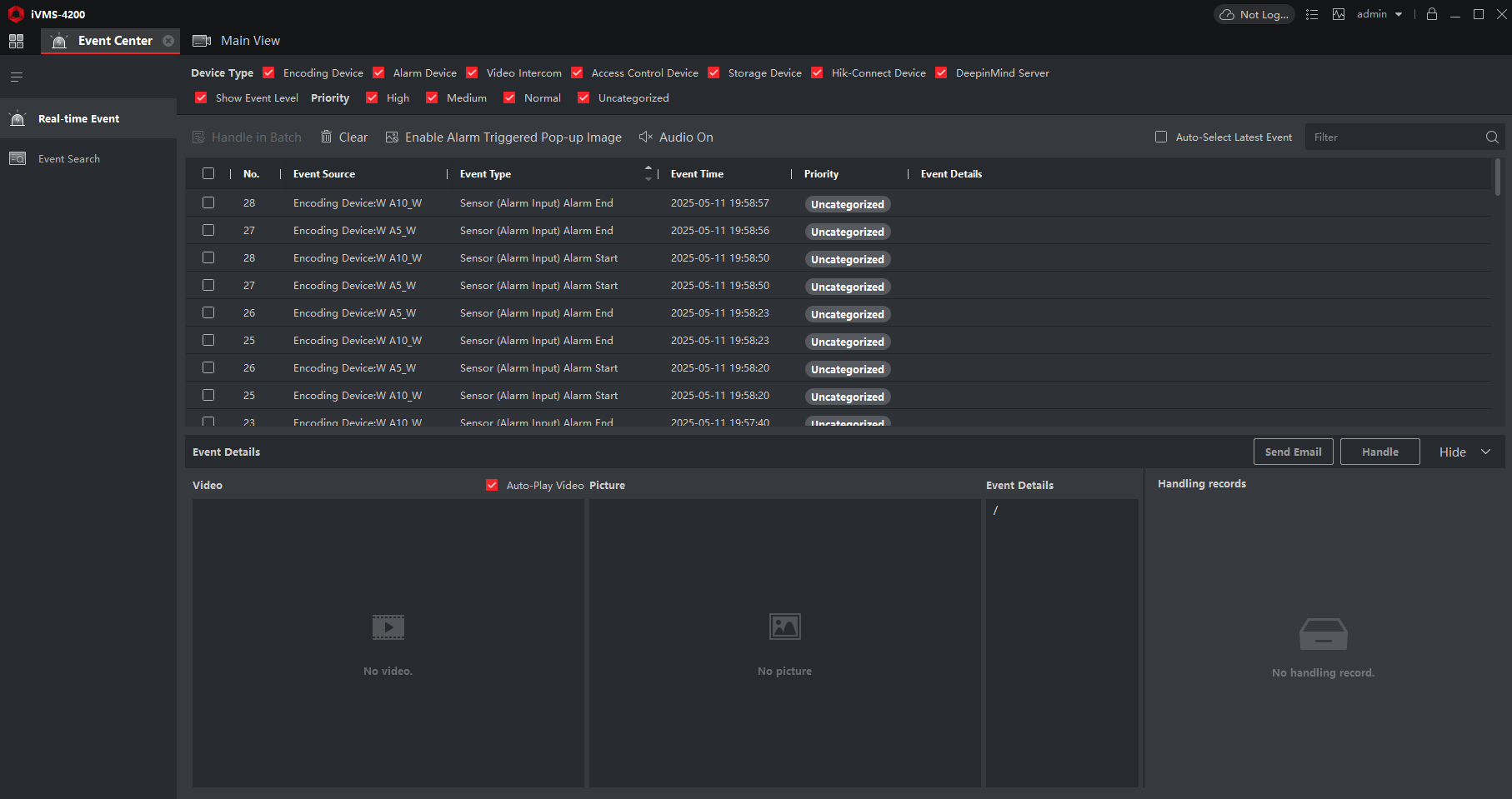

On my OEM hikvision ear326, I am trying to connect a sensor to alarm input. The problem is, regardless if I use normally open or closed options, when I trigger the alarm and leave the circuit in the triggerred state, and linkage as notify surveillance center, my IMVS events are showing a random stopping and starting of the events, every minute at least but random time in between. Any ideas if its something wrong with the nvr or just settings issues?
I want the event to trigger (start) and not change until I physically open the circuit. Heres a screenshot of whats happening now in my Ivms event center real time page, I have alarm inputs 5 and 10 enabled, set on Normally closed, and not even a wire connected to Close, so theres no way there could be an alarm end event

Time to take out multimeter and see if multimeter gets same result on sensor output. Alarm input should not behave randomly on its own.
