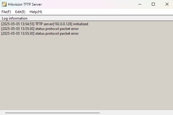

No, I got busy with work. Today I tried again the issue is I can't login into web portal - neither default nor my password is working. I tried tftp method but I get error message when I boot alarm system. On SADP tool the alarm IP shows as the static one I configured so maybe that's why tftp isn't working.
@Kyle Can you please check with Hikvision about how to fix it? I'm really struggling and don't wanna hard reset the device and lose all alarm/sensor/zone configuration.
