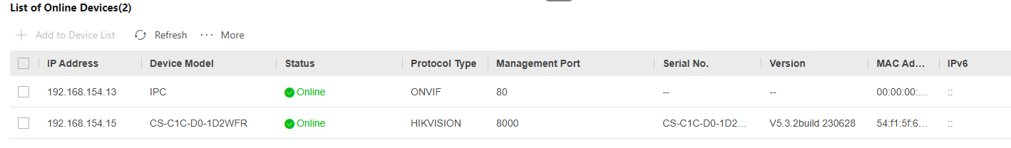

In the past I have used indoor Wi-Fi Ez-Viz cameras connected to my Hikvision NVR (I have since stopped recording from these because I no longer found it necessary).
The Ez-Viz cameras are cheap and since Ez-Viz is related to Hikvision, they support the Hikvision protocol... you can see one on my network here that could be connected... when I did have it connected, I could record 24/7 and motion alerts (not smart events, just basic motion) would be sent to the NVR:
