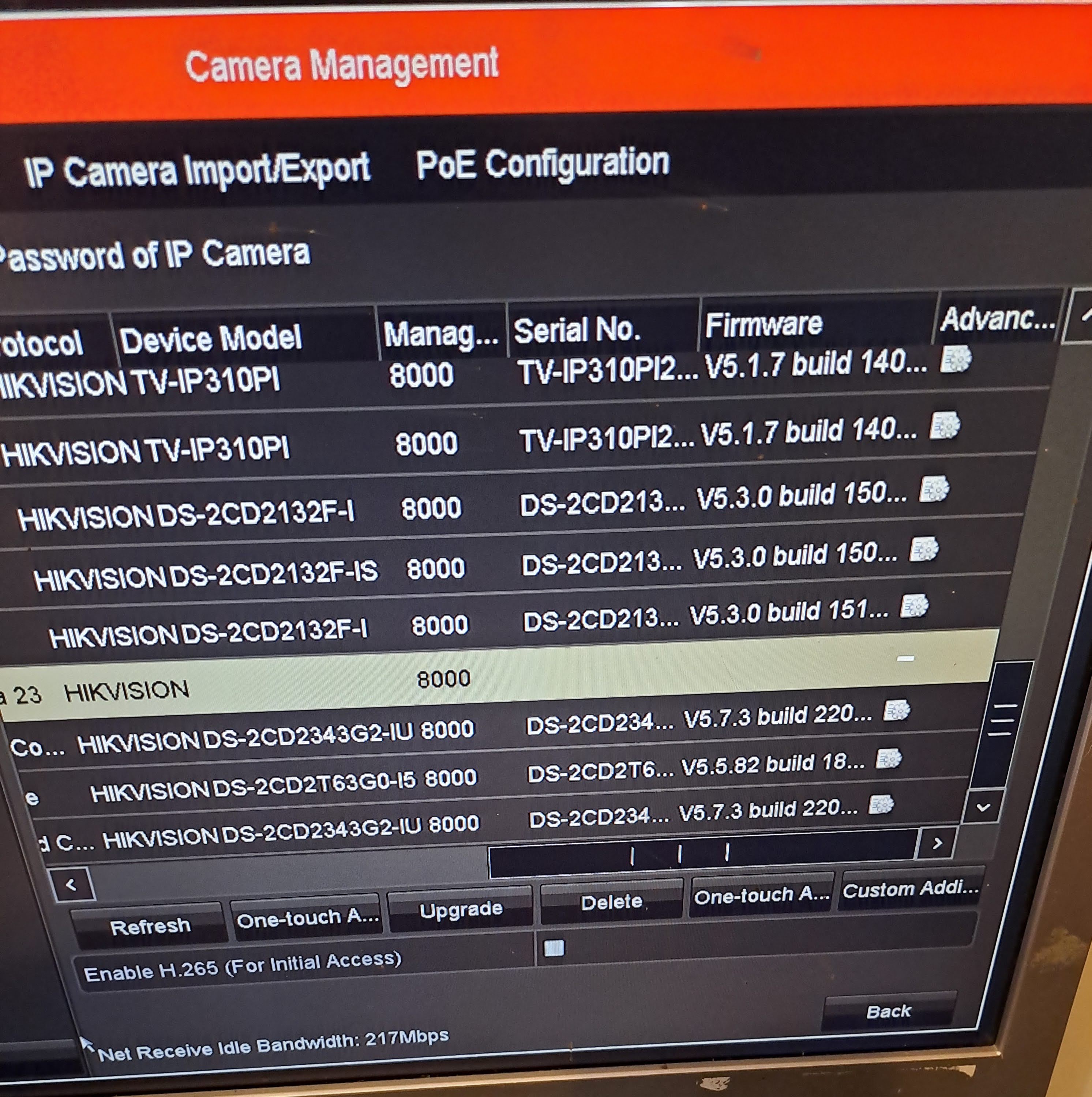

On the NVR Camera Menu, the status of the camera is displayed as ‘Unknown Error’.
However, the ‘Device Model’, ‘Serial Number’, ‘Firmware’ and ‘Advanced’ are all blank

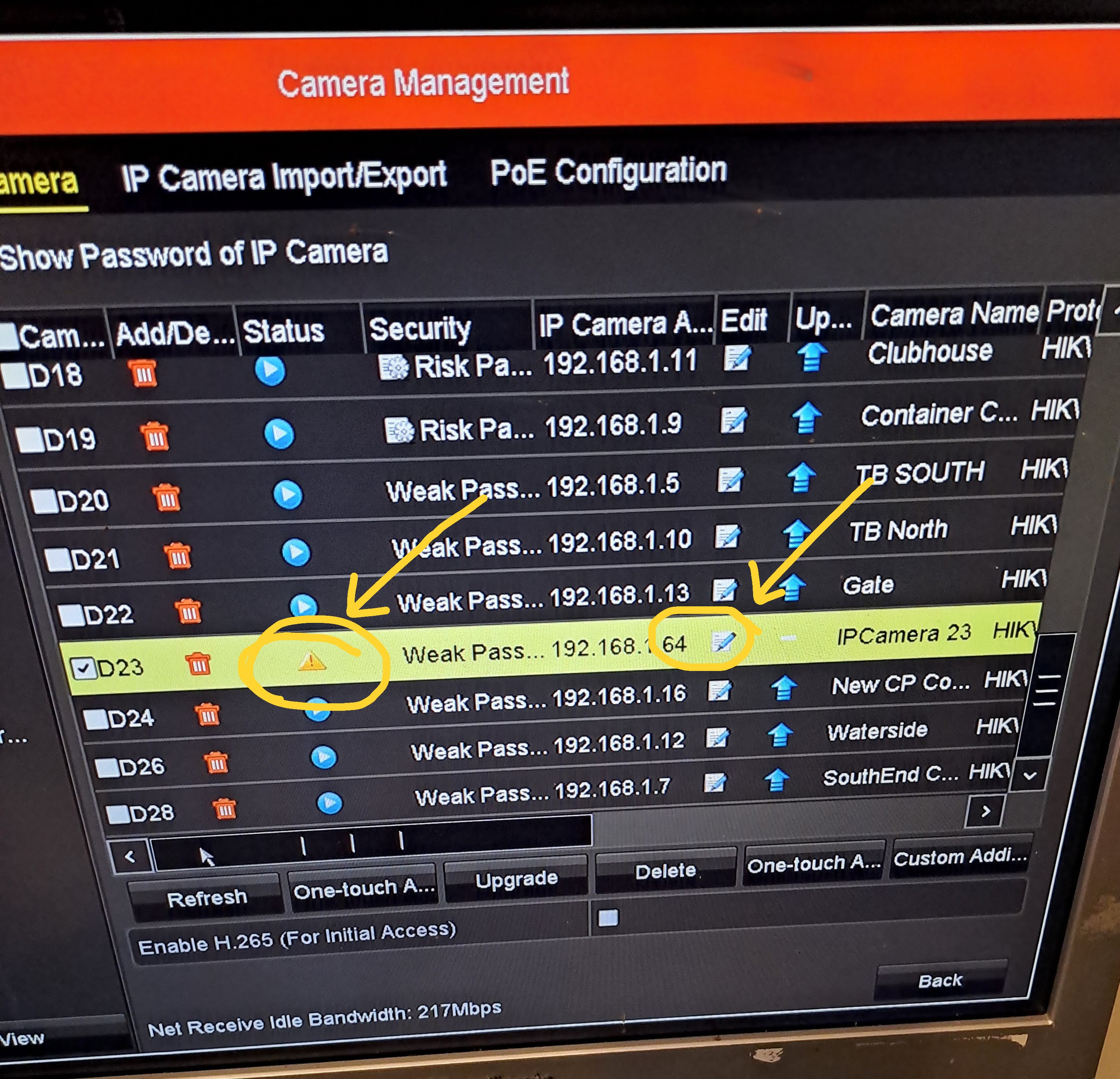

Try clicking on the "Status" and "Edit" icons for clues... post screenshots if you don't see anything obvious (also try clicking on the "Edit" icon for a working camera and see if there are differences?):

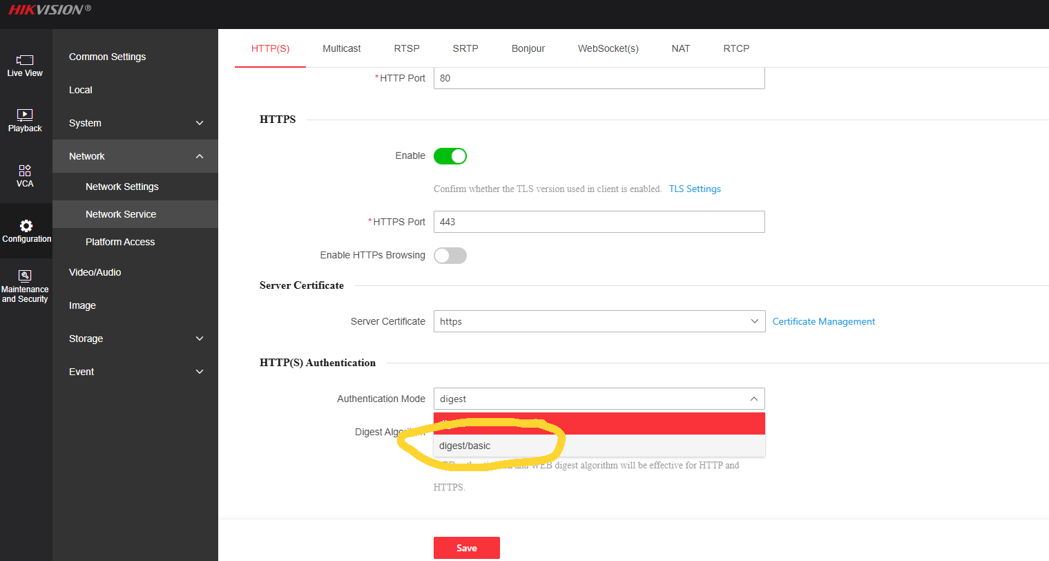

  • Change the authentication in the camera from Digest to Digest/Basic
Thanks for your response Johnfitzy.

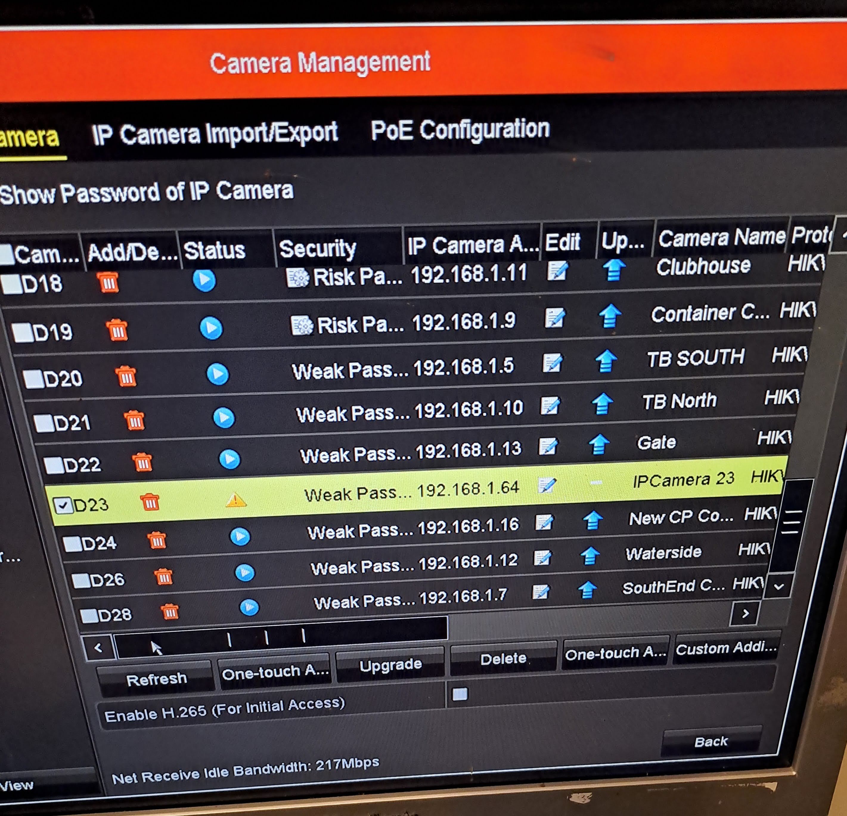

The STATUS just says 'Unknown Error'

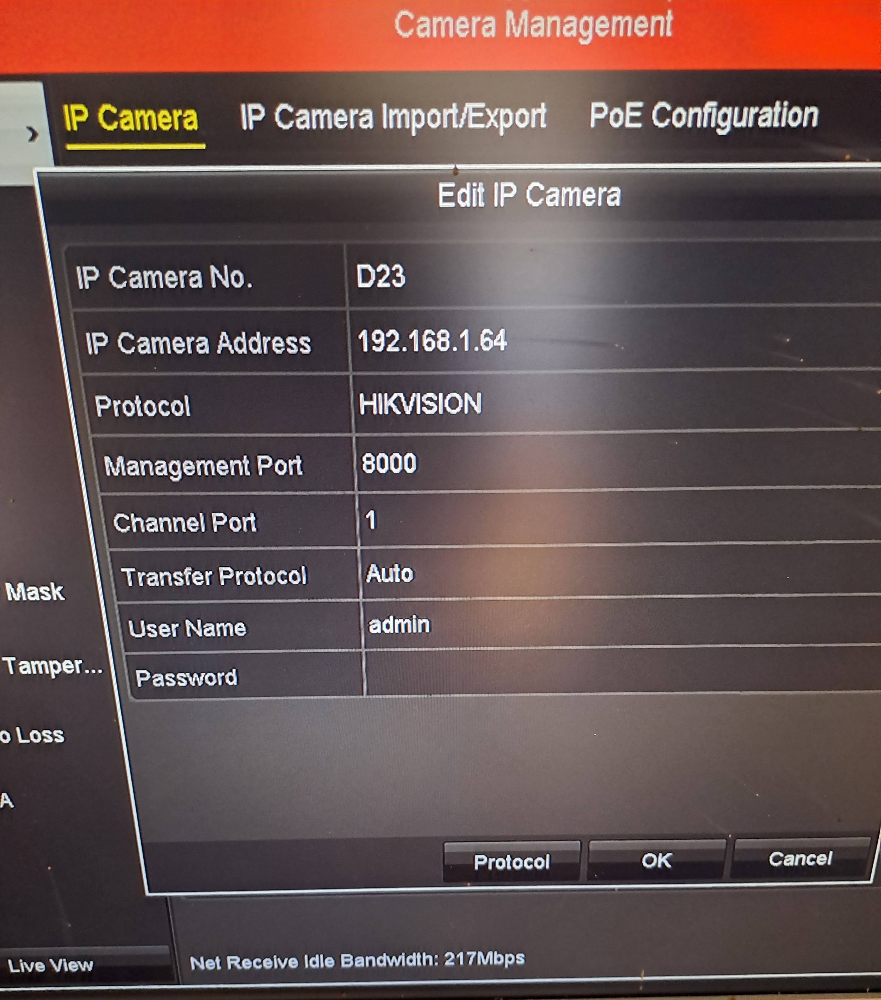

The EDIT is the same as other cameras, as below.
I have changed the IP address since taking the picture below just in case there was some conflict. Have also deleted the camera and re Added it.
Still no success.
Steve
I see on Steve's screenshots "Enable H.265 (For Initial Access)" so the NVR does support H.265.
Some models only had partial support for H265 - the E1 and E2 models from memory. Still, without a full model number and firmware version for the NVR a crystal ball is needed to know whether the new model camera on it's default settings is compatible...

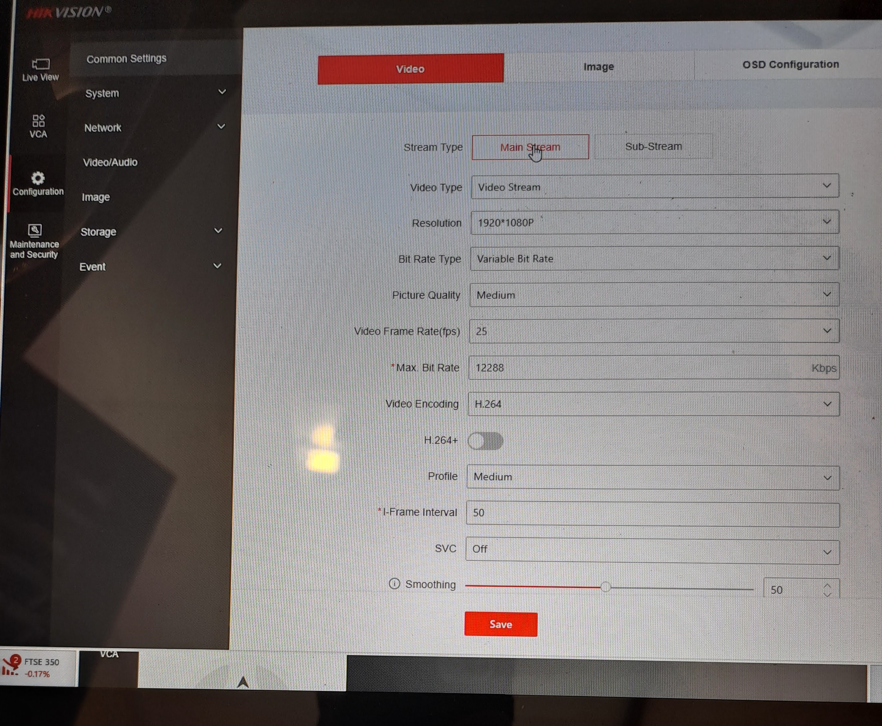

As suggested, I have reduced the max resolution,
the video encoding is H.264 on both main and sub-stream
and I have changed the authentication to Digest/Basic.
Without success

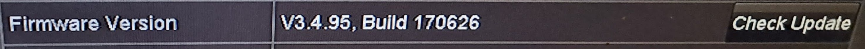

I can see the NVR is running version 3 firmware and my guess is that the NVR doesn't fully support the newer camera that's been added
What firmware is the NVR running? Maybe it needs to be updated to a newer (or newest) version to support the newer camera?

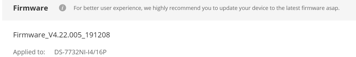

I checked the firmware today and it reported it has the latest
Johnfitzy - I did use a check for updates button! It certainly was not 4.22. I think it was 3.7
Where can I source 4.22 please?
I have just checked hikvision.com/uk/support/download/firmware/ and DS-7732NI-I4/16P is not listed!
Here is a link to the Hikvision UK Portal for firmware for your I Series [76 77 96 NI-I]:
https://www.hikvisioneurope.com/uk/.../04 Back Ends/NVR/01 I Series [76 77 96 NI-I]
I think this is the correct page for your NVR, but I am not sure... and also, I don't think you can just upgrade to the latest version... I think you may need to load some of the earlier V4 firmware's before you load the latest V4.61.030...

Going back to the original issue, the DS7732NI-I4/16P is new enough that it's fine with the 4K resolution, H265 and authentication of the newer model camera so those settings can be put back as they were.
As it's such an old firmware you currently have, updating to the latest (and last) I series firmware is advised and you'll need to go through multiple (but not all) versions to get to the latest one. It's worth clearing the browser history each time to ensure the NVRs web UI loads correctly when there are changes (incorrectly formatted pages, fonts and 'page not found' errors can be experienced otherwise). That's especially critical during the update that transitions from V3 to the first V4 version as the UI is completely different.
