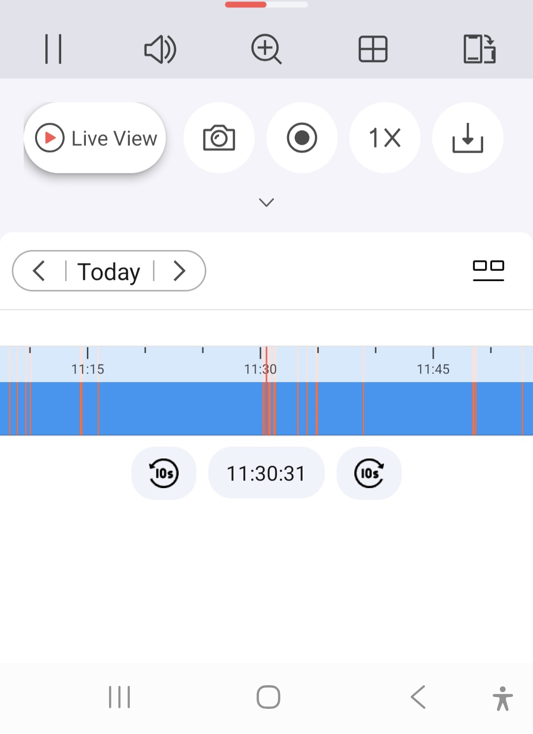

Hi,
I am trying to set uo recording but i would likr constant recoring with motion events on the time lime as per photo below. I can only seem to get constant recording blue line without the red motion lines. Anyone can tell me how to get constant recording with motion?
Cheers
Enable
Hi,
Cheers
Leave the recording schedule on the NVR as it is, then just enable motion detection for that channel on the NVR.
