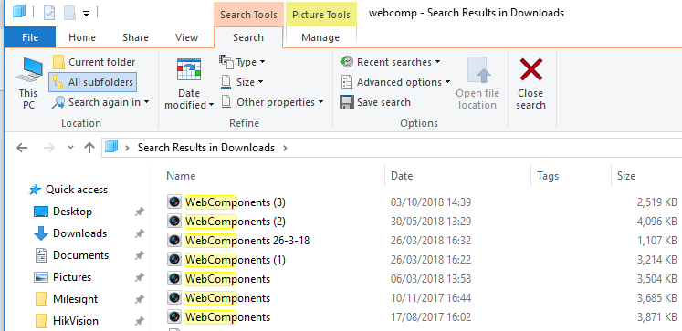

Often when there are Hikvision product firmware updates you will need to download and install a new web components file.
The pop-up that you spotted was the camera or NVR offering this to you.
You may have downloaded it but not yet installed it.
It will normally show in your Downloads folder, and look similar to the below.
Like me, you may have many different versions, saved on different dates:
You need to install the most recently (newest) version that you have.
You MUST close all browsers before installing it e.g. Chrome, Internet Explorer, etc.
If problems persist, I would recommend installing it immediately after a restart of your PC.
To install it, just double-click the WebComponents file and follow the prompts.
