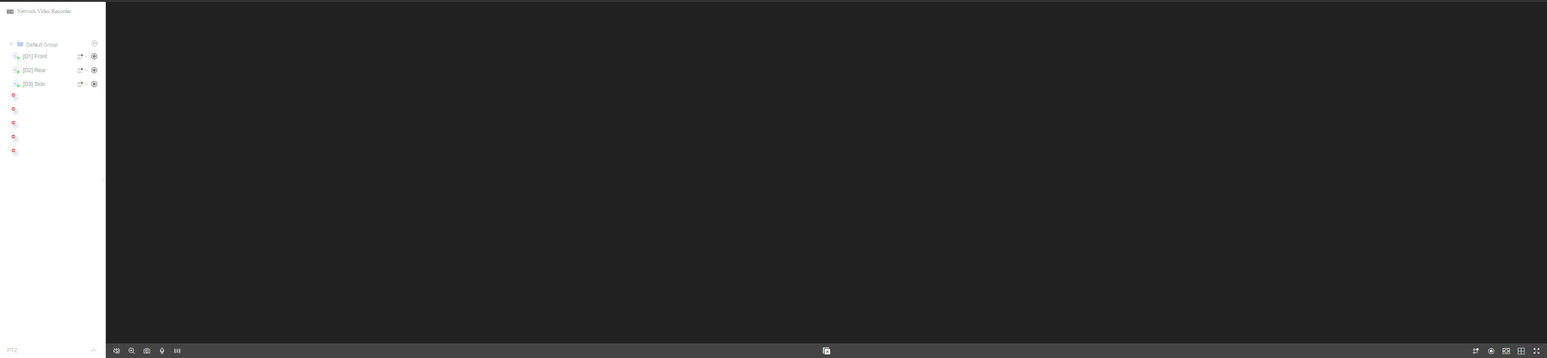

Hi,
Anyone else seen this, I presume it's caused by a Chromium update as the issue is present in Chrome and Edge but not in Firefox.
The Live View and Play Back pages don't display the camera grid at all, just a blank grey screen.
If you change to fullscreen it shows the grid and the live camera feeds.
Or if you double click where the video feed would be, it opens that feed in full screen and is streaming fine.
Or if you single click where the video feed would be, it changes the camera being selected on the left side menu

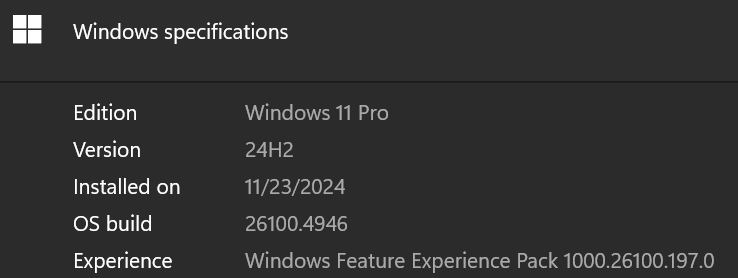

OS: Win11 26100.4946

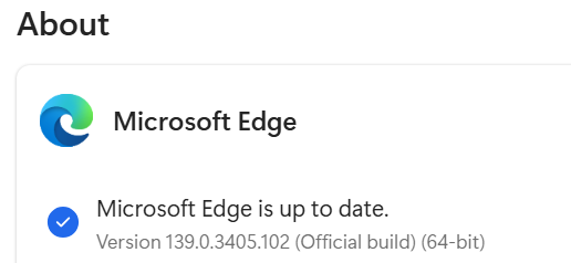

Not sure why, I think I have the latest Edge and everything Hikvision related continues to work fine:
