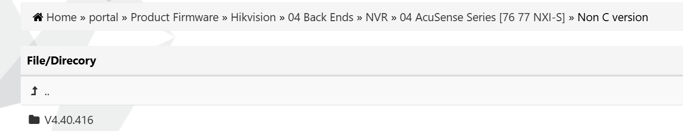

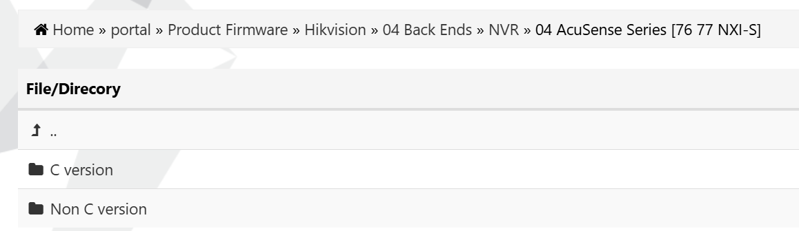

I took a look at the UK Portal for DS-7608NXI-I2/8P/S... there are 2 versions listed there... C and non-C:
The version you currently have is only listed under the non-C so you must have the non-C version and the firmware you are running is probably the latest already:

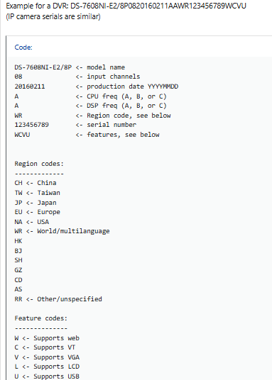

As far as I can tell I have the C variant. The serial number contains CC, DS-7608NXI-I2 / 8P/S0820210119CCRRF...

If you have a C version, I think it should have "(C)" after the model number on the physical serial number sticker on the machine.
That CC does not mean it is a C version... here's how to interpret the serial number:

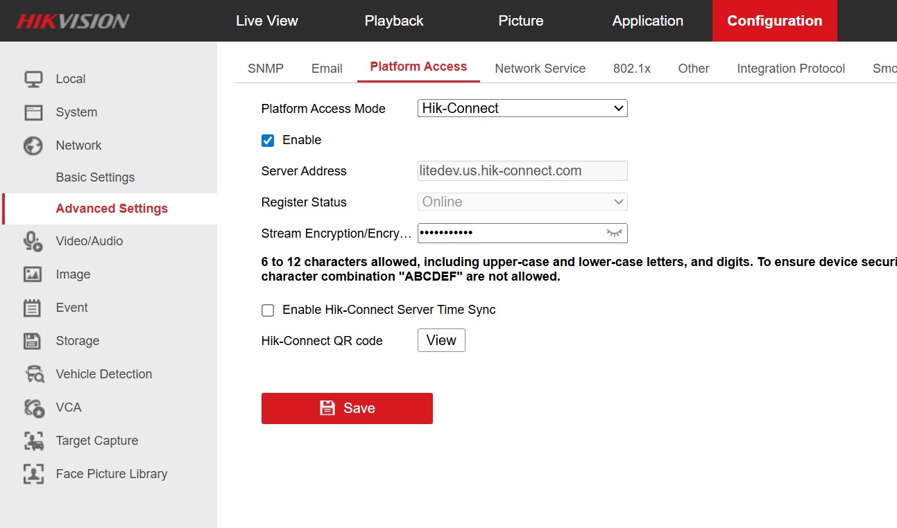

Maybe it's this:
Also, ensure that "Adaptive Bitrate Streaming" is not checked on the "Network/Platform Access/Hik-connect/More Options" page of the NVR... if it is checked, when you use the "Basic" setting in Hik-connect, it may change/lower the sub-stream resolution settings.

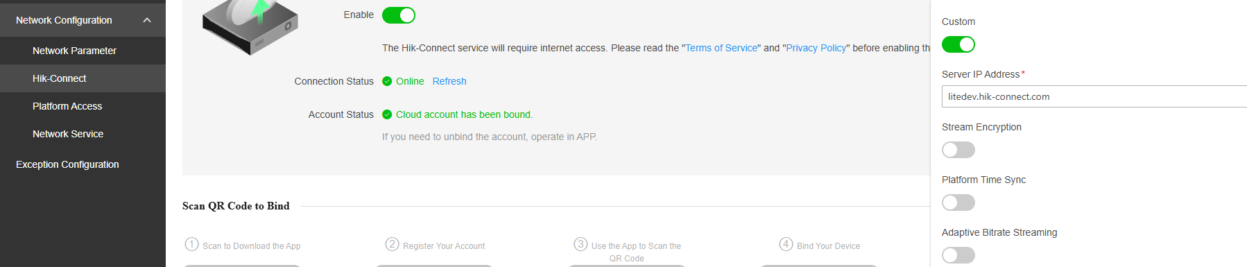

Thanks, I can't find it in the NVR settings.

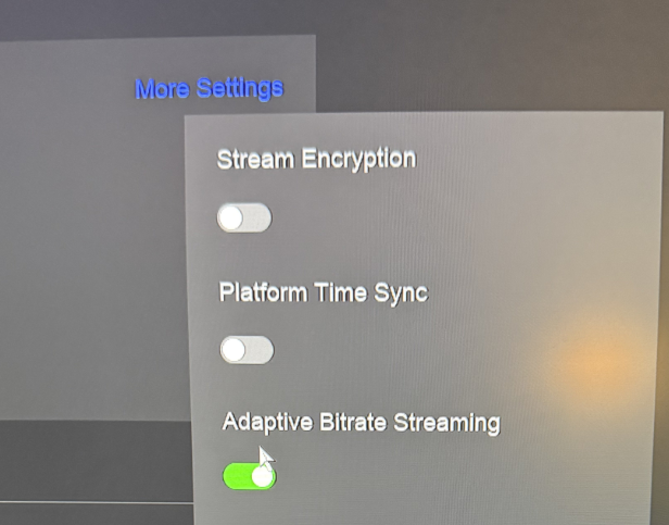

I had the same problem a while back and it was @JB1970 who advised me to turn off "Adaptive Bitrate Streaming"... but I can't seem to find the thread, and I don't know what NVR/firmware I was using at the time...
I do remember it was only the sub-stream resolution/bitrate that was changed with this setting on... each time I would view the "Basic" stream in Hik-connect, the sub-stream downgraded... very annoying...
Here's the setting on a fairly recent M series running V5 firmware...

Adaptive bitrate streaming is also an option in V4 firmwares. I can’t recall whether it’s in the Platform Access page or elsewhere but it’ll be turned on by default and should be switched off.
