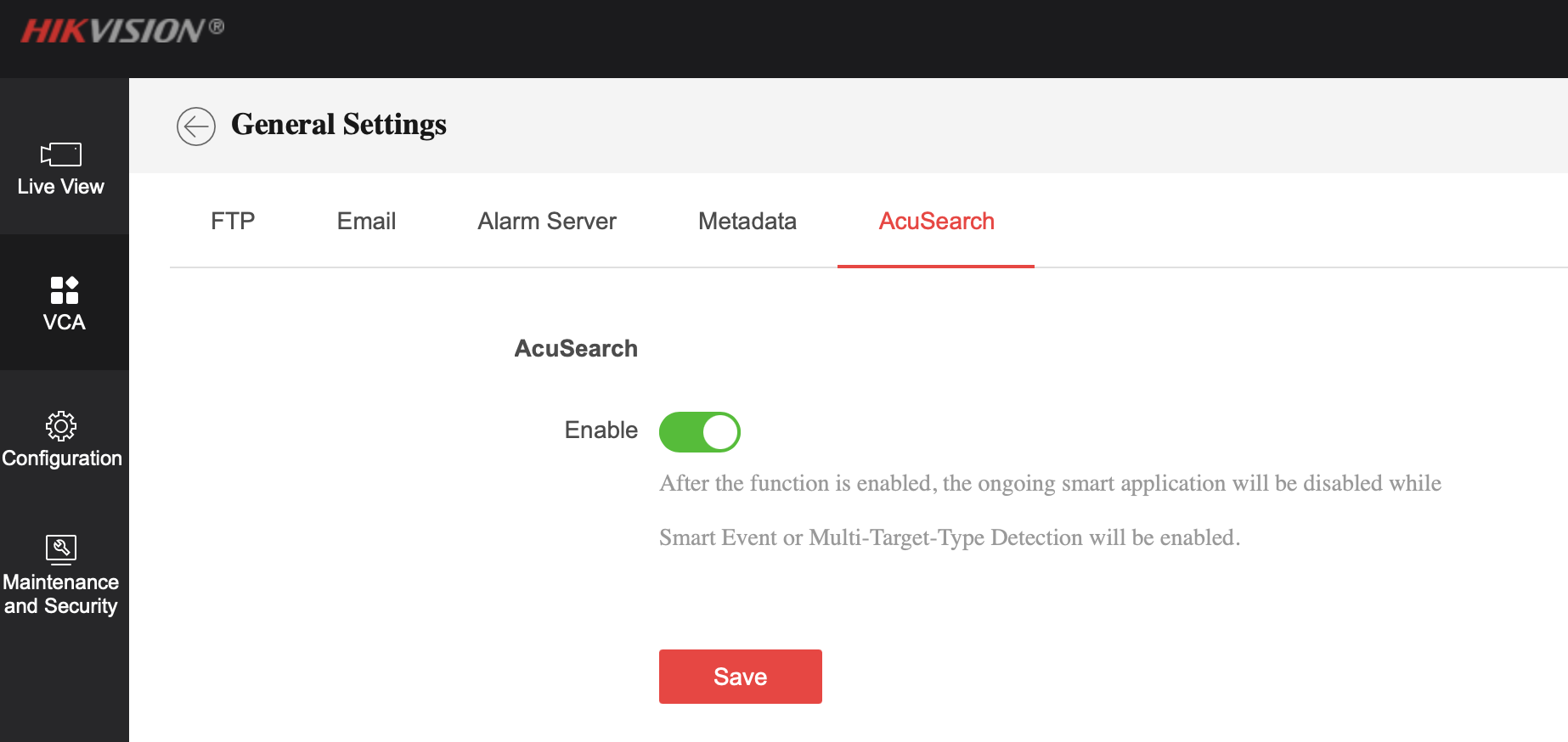

The Panoramic version that you have (DS-2CD2387G2P-LSU/SL) uses a different firmware version to the standard camera. For it to be compatible, it must have the 'AcuSearch' feature available in the menu and turned on. You can find that by logging into the camera directly and going to:
VCA > General Settings > AcuSearch
That needs to be on as shown. If you don't have that option, make sure your camera is on the latest available firmware.
In the latest firmware version, which I have V5.7.20_250423, the AcuSearsch function is not available.

Are you looking in the menu of the camera directly (it can't be seen in the NVR menu)? If so, I guess that the panoramic version does not support AcuSearch as your firmware is recent.
Yes, that's what I see directly in the camera and not in the NVR.

There are a few sources but it seems you already have the latest and that camera doesn't have the feature.

We've spoken to our Hikvision support contact about this, they have confirmed that the G2P models do not work with the AcuSearch feature on the VPro NVRs.
