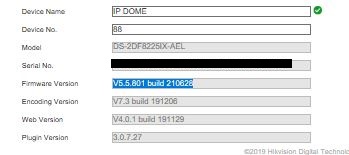

I'm part of a team operating Hikvision IP Dome cams, watching for wildlife in Africa. As such we might load several cameras, in separate tabs/browsers, using the webGUI. One of the cams seems to be triggering 'Login Timeouts', precisely every 15 minutes, requiring the user to have to log in again. Unfortunately, when this happens, it also frequently takes down other cameras, even if on another browser! It can happen whether using IE11, Edge + IEMode or Chrome + IE Tab.
Can anyone offer any suggestions as to why this is happening and how to prevent it, or extend the time to a longer period if that can't be done?

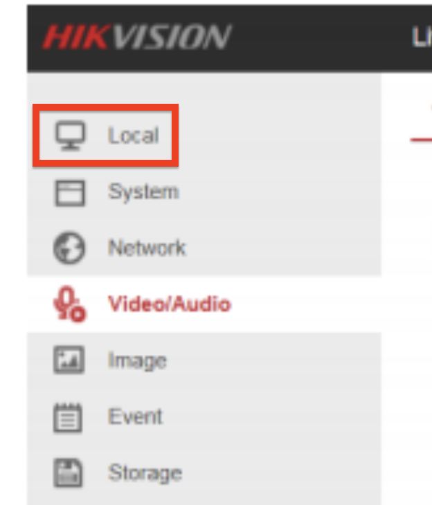

Hi Salamat,
On the Hikvision web GUI main page there should be a Local tab, can you set auto logout there?

I've had a look at Local, and no timeout settings there, unfortunately. Researched through the manual for every mention of 'time' and there's nothing about timeouts! :-(

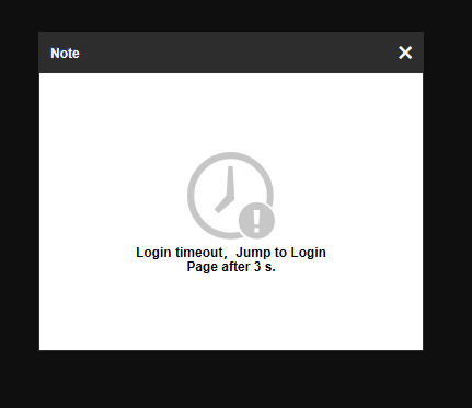

Was there any fix or workaround for HIKvision web interface auto log out times being edited somewhere? My APR Hikvision camera gives me this all day long as I check in and out with it and i would so love to be able edit it somewhere for a longer session. Can anyone help? I run a DS-2CD7A26G0/P-IZS camera with no DVR, just an SD card.
If you're logged in and viewing the stream it'll stay up. However if your connection is idle (viewing a config page and not interacting with it) or you disconnect the session, it's going to require you to login again. That would be the norm and it's basic security so won't change.
Thank you for that explanation, i understand now that if i as much as click anywhere outside the browser then that is likely a signal my session will countdown to its time out, or even simply interacting with another program will cause that as well. That's a bit clearer now and i'll try and work within those parameters from now on. Thanks again.
