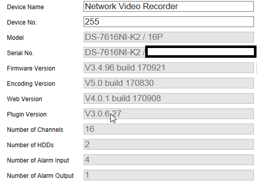

I am trying to get new firmware for my NVR DS-7616NI-K2 / 16P but I find the listings in the portal from the guide a bit ambiguous. I cannot find one that has my exact model.
Also my firmware is well out of date is it ok to go straight to the latest or is it a multi-step?
The firmware for the cameras is also original I assume. Will they still play nice if I just do the NVR first?

You will see from that list that the firmware you are currently running is older than even the oldest version available in the portal, so to avoid glitches/issues with the NVR software we would recommend updating to the latest firmware version in steps.
Below is the list of the firmware versions we recommend updating to in descending order:
