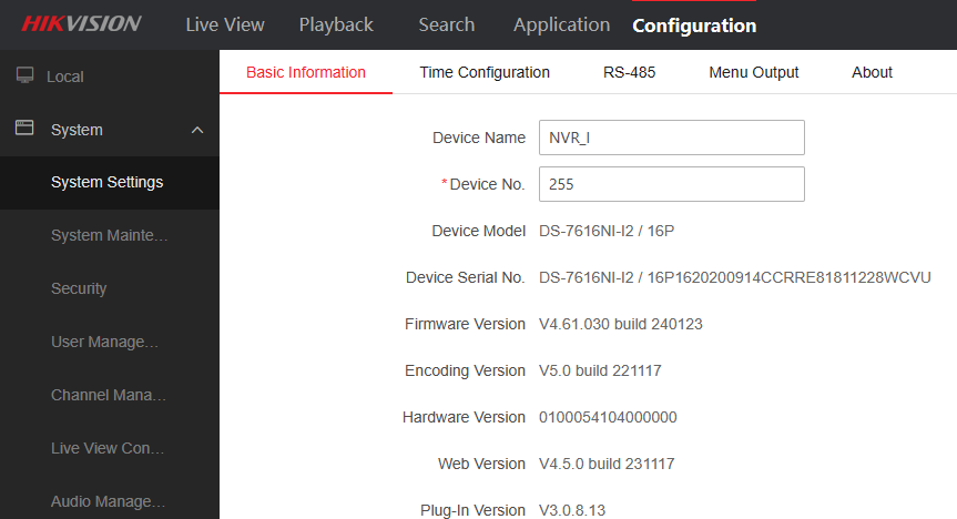

I loaded the V4.61.030 Build 240123 firmware on my DS-7616NI-I2/16P...
it loads and boots up... I only have 1 test camera connected and have not checked anything...
If it helps anybody considering upgrading...
I then went back to V4.61.025 Build 220905... wanted to see if you could... you can, but the system needs to be set up from scratch again... I always make sure to unbind the NVR from my Hik-connect account, and turn off Hik-connect on the NVR before I downgrade any NVR firmware... I think it helps to avoid getting the NVR "blacklisted"... happened to me in the past but a couple of back-and-forth emails with support@hikvision.com gets it cleared... they seem pretty good with that.
