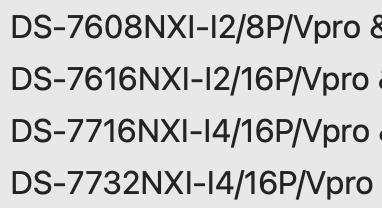

No idea what we'll get in UK....Apparently these are available next week:
But no mention of the non /P models and definitely no M version :-(
