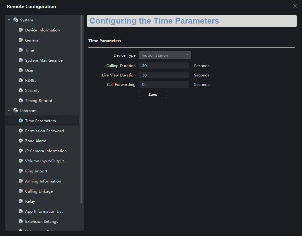

There is setting called Forwarding time or something like that. Set it to 0 if it isnt. This means after how much seconds it will forward the call toward application
There is no such setting that concerns delay for HikConnect on Indoor Stations.
