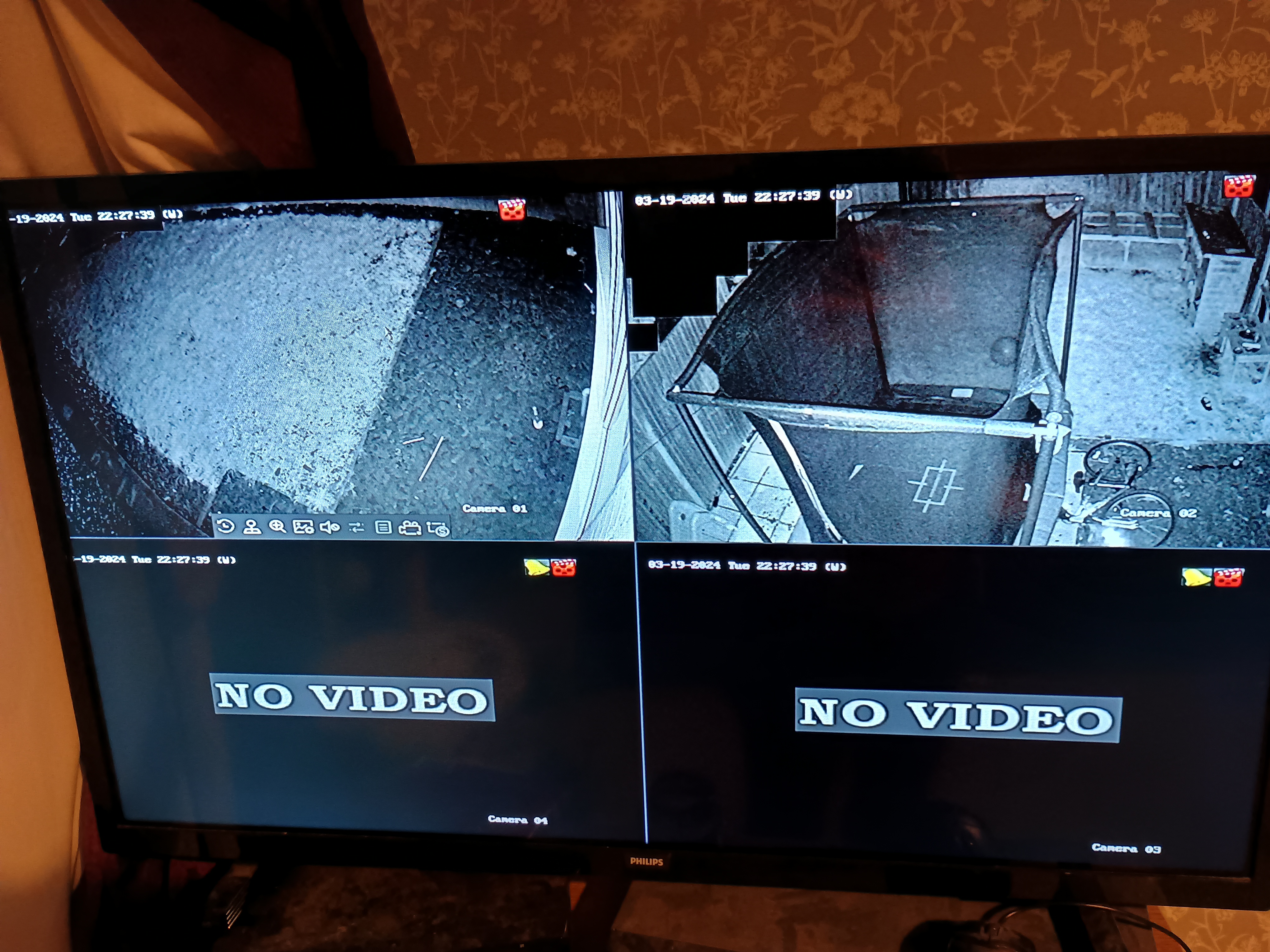

This is my camera screen
I don't actually know where to go from here
I mean that's the screen on my Tele
I don't know where to even go from there

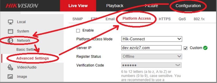

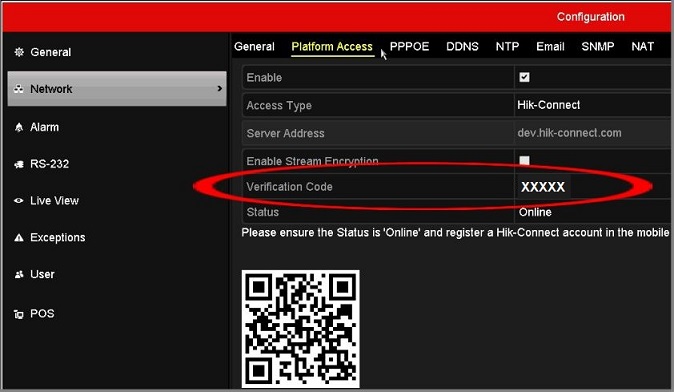

To find the verification code from your screen above, you need to log in, then go to Main Menu > Configuration > Network > Platform access.
There you will find your device verification code.
To find the verification code via a browser, you need to log into your NVR then go to Configuration > Network > Platform Access.
There you will find your device verification code. (Sometimes referred to as 'Stream Encryption/Encryption Key')
