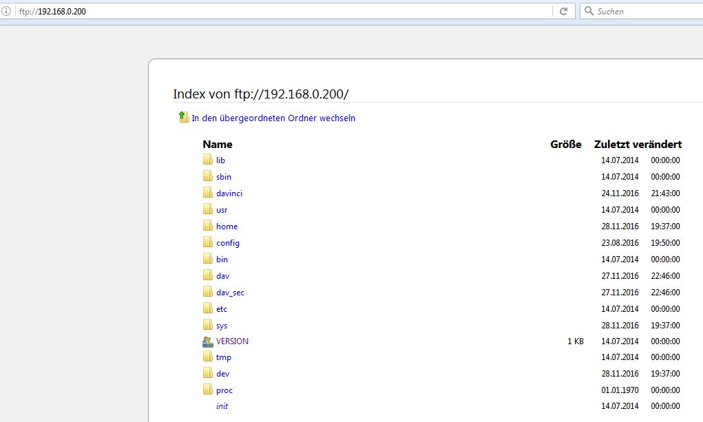

my Dome camera ran fine but i have done a software update via Webserve. Now the camera doesent work any more :-(
I can not say which software version was the old one.
I have updated : the file: DS-2xx2_5.4.0_160530 (digicap.dav) from the hikvison homepage. The update process ran fine. But now i can not find the Web server. (192.168.0.200:8000).
-> SADP Sofware find the device
-> router find the device
-> ip Scanner find the device, with FTP link to device-> i can see folder and files
-> webserver is not reachable !!!!
-> i have pushed the rest button , without success
could somebody help me to solve this problem...
Thanks and best regards from Germany....Olaf

Hi Olaf,
Unfortunately, SADP is showing your camera's firmware version as v4.0.8 which is the recovery version - think of it like the camera booting in safe mode.
This usually indicates a bricked camera, and typically happens if you update a Chinese-region model with international firmware.
Your best bet would be to contact whoever sold you the camera for support.
