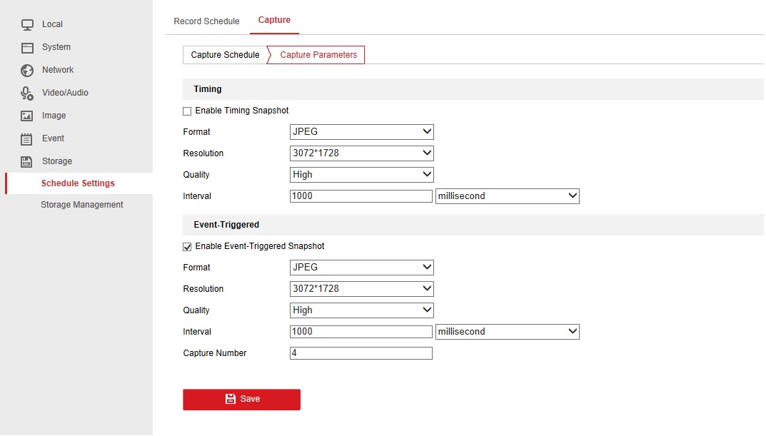

Anyone know if there is a way to set the resolutin of the images sent with smart event email notificaitons on DS-2CD2146G2-ISU cameras?
I've one site with 4 G3 models and one G5. The G3 cameras are all on the same firmware (I'll have to check) and the G5 is on a not quite latest revision.
However, all have the main stream set to 1920 x 1080 and that is the resolution the "snapshot" images sent with smart event notificaitons are sent at.
I've a second site with two DS-2CD2146G2-ISU G5 cameras, both on the latest firmware.
For some reason all the smart event notifications they send have image attachements at 1280 x 720 resolution and I've no idea why.
The main stream resolutin is set the same as the other site - 1920 x 1080.
The site with the 5 cameras uses a Foscam NVR purely for recording. It plays no part in the notifications at all as it connects to the cameras via ONVIF.
The second site, with the new G5 cameras, has a DS-7604NI-K1-4P(C) NVR but, again, (as far as I know) I'm only using that for recording. It has no email settings at all set up. I've done all that on the cameras directly along with the smart event configuration.
Anyone any ideas why these two new cameras are sending images at this odd resolutin and any suggestions as to how to change it to 1920 x 1080
