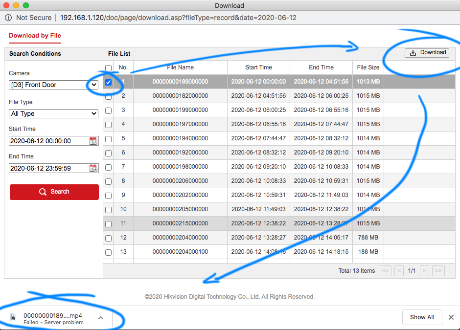

I'm running a DS-7604NI-K1 / 4P(B)), with firmware version V3.4.110 build 200212. I've now discovered that I am unable to download any playback video.

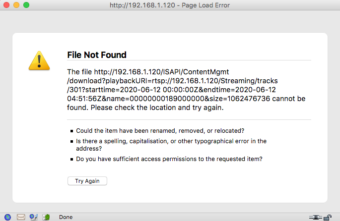

Ive tried on Mac & PC, IVMS-4200, chrome, safari, SeaMonkey (Mac), Firefox, and Internet Explorer (on PC). here's one of teh error messages:
File Not Found
The file http://192.168.1.120/ISAPI/ContentM...120/Streaming/tracks/301?starttime=2020-06-12 00:00:00Z&endtime=2020-06-12 04:51:56Z&name=00000000189000000&size=1062476736 cannot be found. Please check the location and try again.
Any advice?

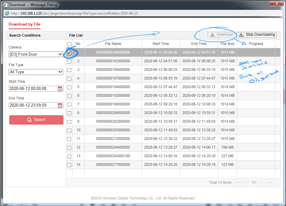

Upgraded it.... no difference. still the same, but when downloading the playback file, theres no error message, it just says 'downloading' and it does nothing, just sits there.
