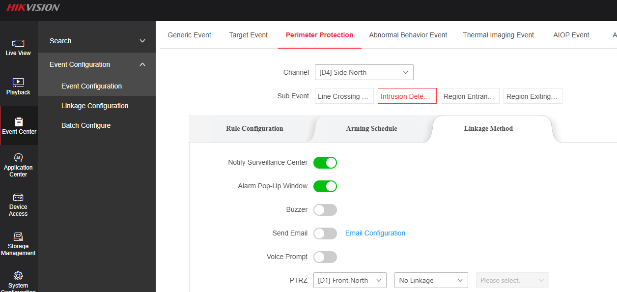

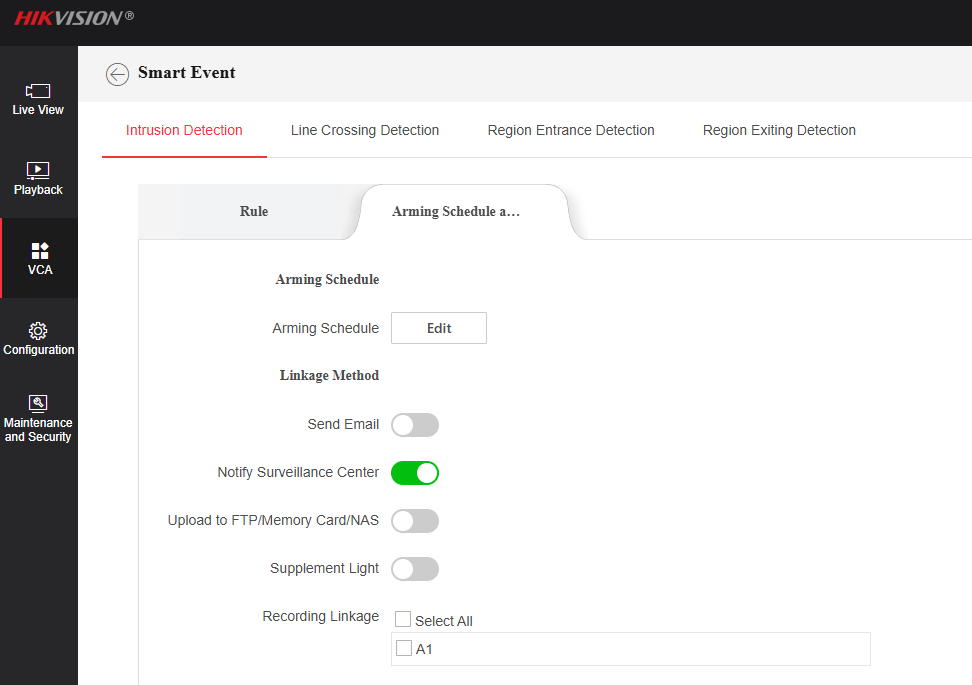

3) unticked alert surveillance center on the events
4) re-ticked alert surveillance center on the events
