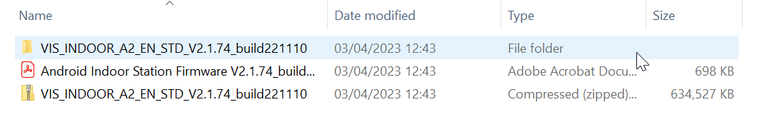

Hi @NoFate - how are you extracting the contents of the .zip folder?

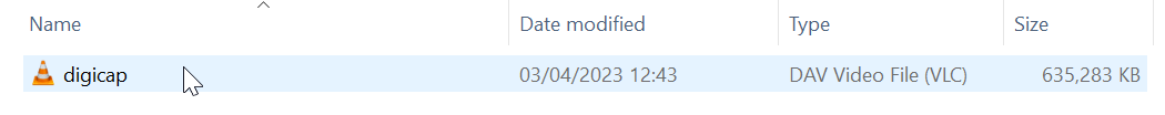

I've just downloaded the firmware (it's actually V2.1.74 despite it being titled 2.1.76 in the portal), and there was a second .zip folder within that with a digicap.dav firmware file within:

No, on UK portal, it actually downloads 2.1.76, and after extracting the zip, there is a huge 1.6gb factory image file with .IMG extension...
2.1.74 is indeed a digicap
Sorry, I hadn't realised that I had downloaded the wrong file - just tried again and am seeing the same .img file.
I'll ask Hikvision for some input, as this doesn't seem right.
It was a mistake, Hikvision has just confirmed that there hasn't been a newer version released than V2.1.74, thanks for flagging this.
It should be removed shortly :)
