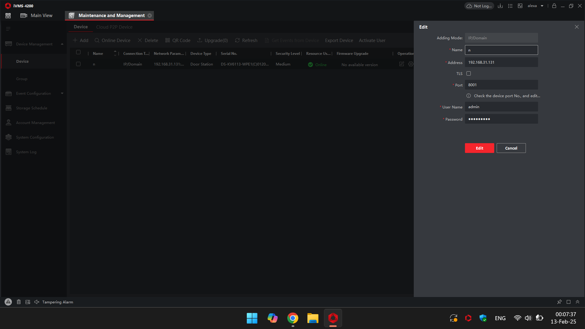

Hi, i have a mentioned villa staton. It is connected via POE switch to internet. For opening the door and HikConnect it is working very well. But. When i tried to change port HTTP to anything other than 80, it doesn't do it. I tried to change HTTP to 81, Server port to 8001. Server port is changed to 8001 (it works in ivms on 8001), but HTTP is still port 80. You can see that ip address i used is without port, meaning it is port 80. But when go to settings it is displayed as HTTP port 81. If i can't change the HTTP port how can i access the device from outside network? Also since it doesn't have onvif, how can i connect this station with NVR at another location?

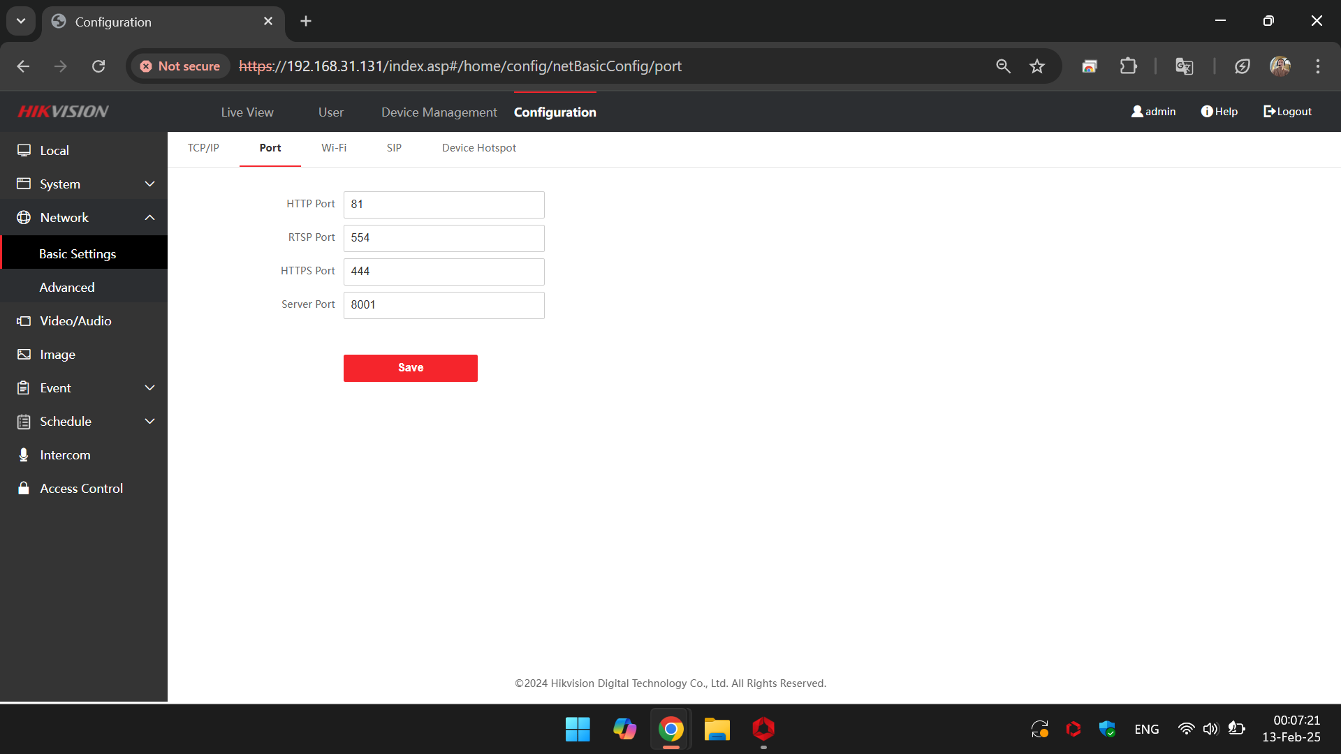

It's not clear what you're using. The address bar shows https so it shouldn't be using 80 or 81
