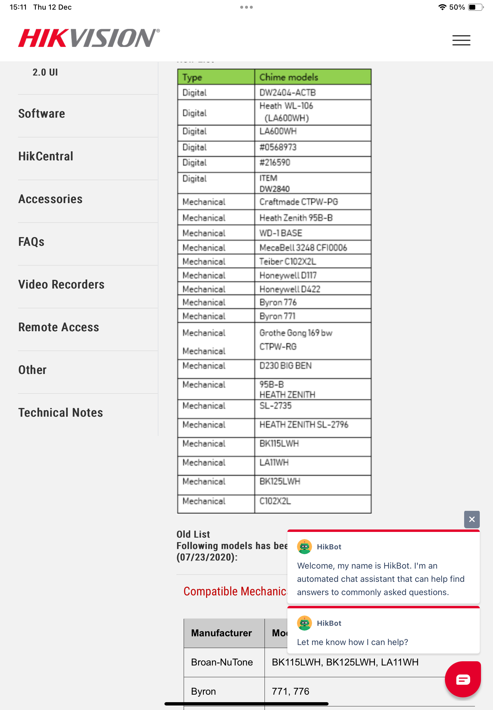

JB1970, I noticed that you had some success with a Byron wireless bell push, while searching I came across this on the USA Hikvision Portal showing compatible chimes, I know it’s a different model of bell push but 2 models of Byron chimes appear.
It might be worth a punt, but there are 2 models available, a 7v one and an 8 v one.

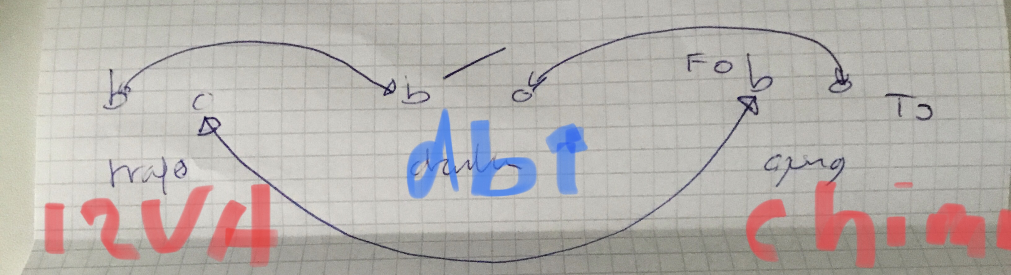

Sorry for adding a question here.
Bought the ds-kv6113-wpe1(c) to replace my ezviz db1 in which at first the normal doorbell was connected.
This situation works as pressing the db1 doorbell,the mechanicaL chime will ring.
I would like to replace the db1 with the ds-kv6113-wpe and power with the 2 powercords as below. Will then the chime still rings? (As i heard about the separate chime connection and selection?
Power comes from a12va transformator in the central metercupboard.
Only for additonal info, not part of the question, I also have a byron by32 convertor attached to the chime to extend the chime signal in a mobile chime further away in the house.
All works as a charm, expect the db1 that is failing with spooky calls without actually some body at the door.
Upvote 0
in addition to previous, the above situation works for the chime only, when connected to the blue and green cables on the DS-KV6113 (after selecting the mechanial chime in the menu). I was able to pull an extra cable for POE powering, so this is working as expected.
