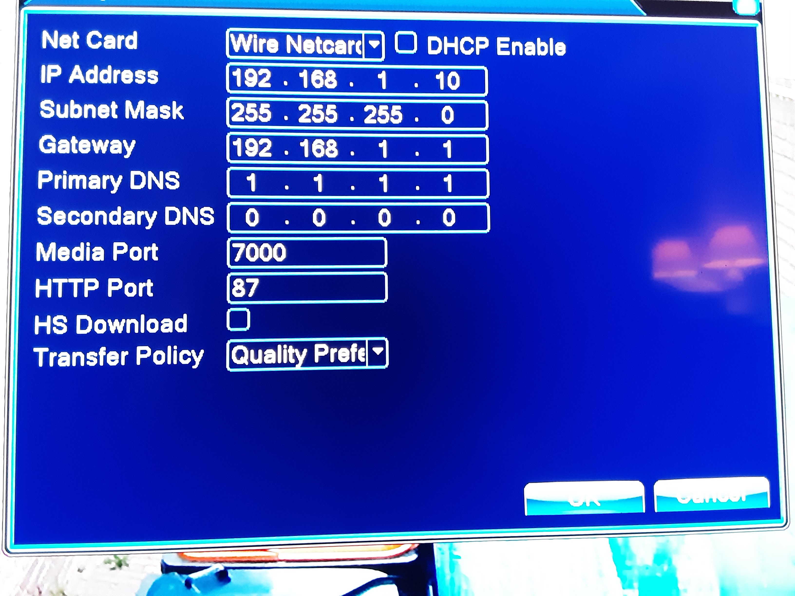

I right click for settings, click on network and i get these settings.
Ip Address : 192.168.1.10
Subnet mask : 255.255.255.0
Gateway : 192.168.1.1
Primary dns : 1.1.1.1
Secondary dns : 0.0.0.0
Media port : 7000
Http : 87
I have tried checking the DHCP box but nothing changes. I have tried all sorts of ip addresses and ports but every time it resets i start the whole circle again back to the same settings.

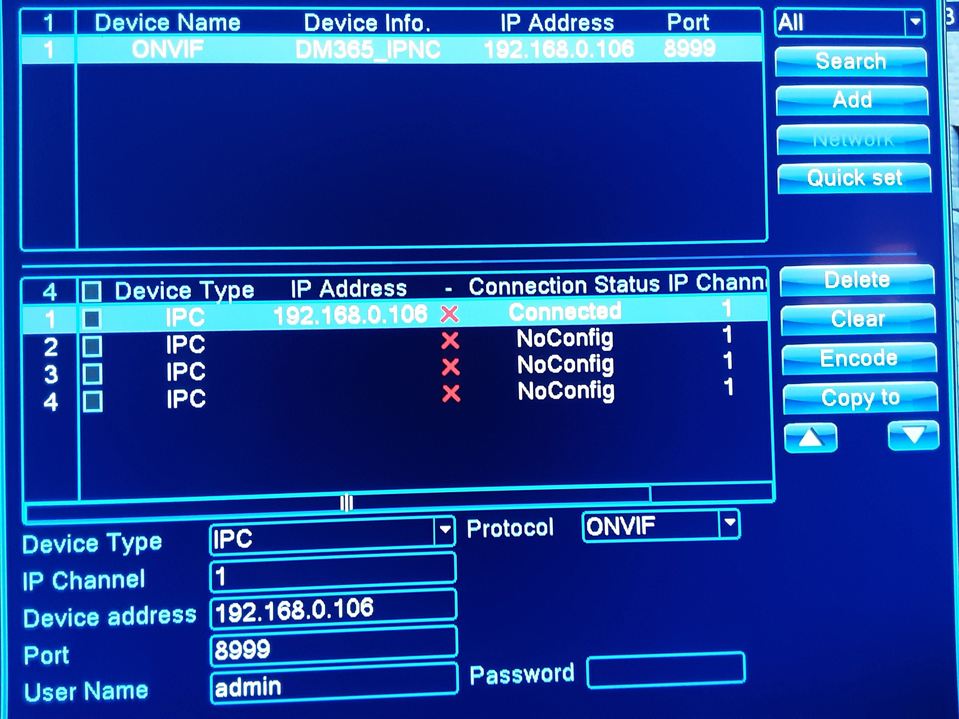

Now a small mercy is that after just changing the ip address to 192.168.0.150 (no restart) gateway to 192.168.0.1 and both DNS to 0.0.0.0 i click ok and then go into 'Quick set'.
It searches and finds the camera ip address and port 8999. I now get footage from the camera.

This morning the dreaded black offline screen was back so i have entered the ip address again using 192.168.0.106, gateway 192.168.0.1 and as you suggested primary dns 8.8.8.8 and secondary dns 8.8.4.4
I kept the media port 7000 and Http 87 so no restart and i can see the camera working... now we wait to see if the black screen comes back.

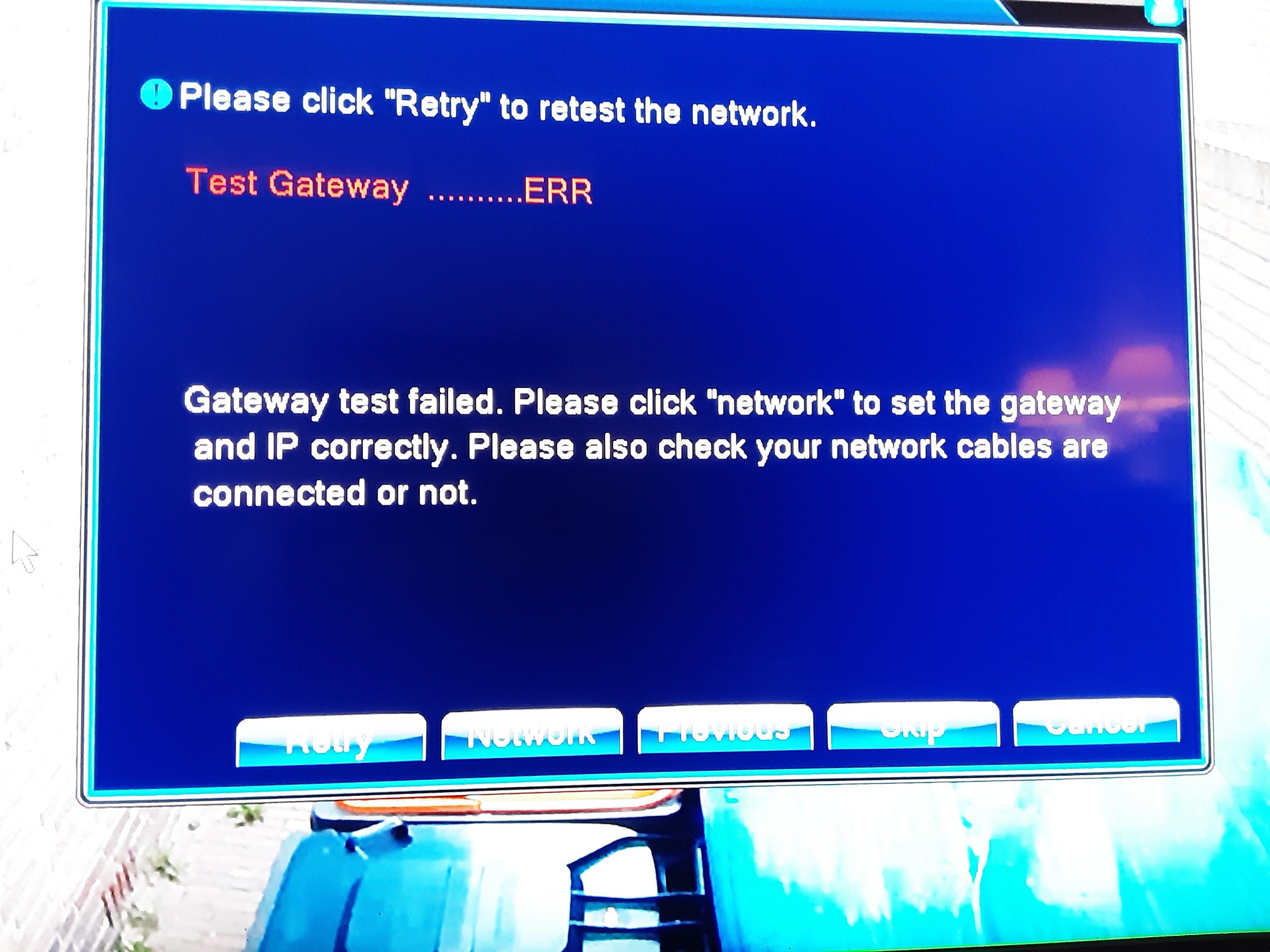

If i use the Wizard/Guide i enter the parameters as above and click test and it stll comes up with Test gateway...ERR but my pc says thats my gateway.
Any ideas why?

Morning Sue, could you post a screenshot of the problem?
The gateway address belongs to your router. From what I've seen it is 192.168.0.1, that is the usual default for a TP-Link Archer C2.

As i mentioned before normally the Wizard/guide starts up and I get the first screen, the thing I can't get my head around is why it's showing an ip address that is 192.168.1.... when my network is 192.168.0....
As you already know I can't port forward to 192.168.1....
I hope these photos help.

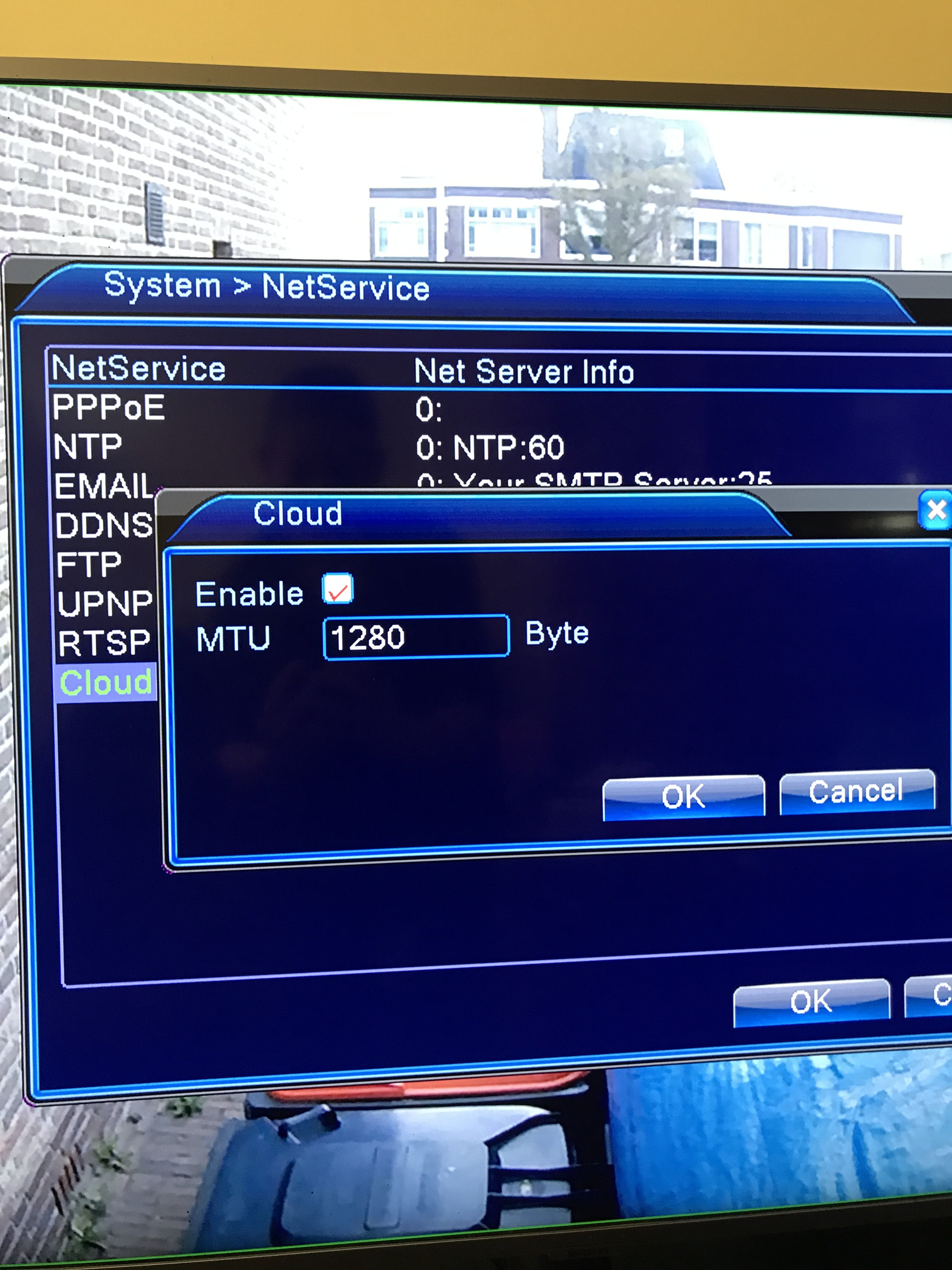

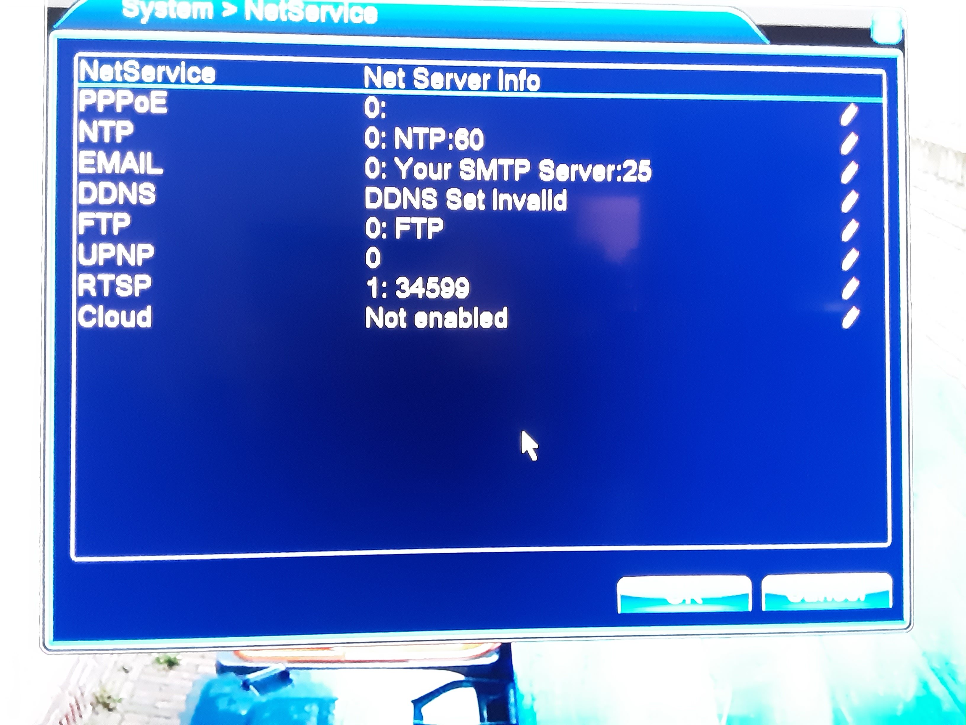

Have you setup any connections to the cloud?
See my attachment, can you post screenshots of the settings for the two I've highlighted? Click the edit "pen" on the righthand side of each.

@sue,
I'm assuming the cloud and DDNS info is from the previous owner.
Cloud
disable (uncheck box) save
DDNS
disable
delete existing data
save. You may have to click the drop down box to the right of DDNS Type and select None, then save
I forgot to flag the UPNP setting. Disable that and save
post another screenshot of the System> Net Services page.

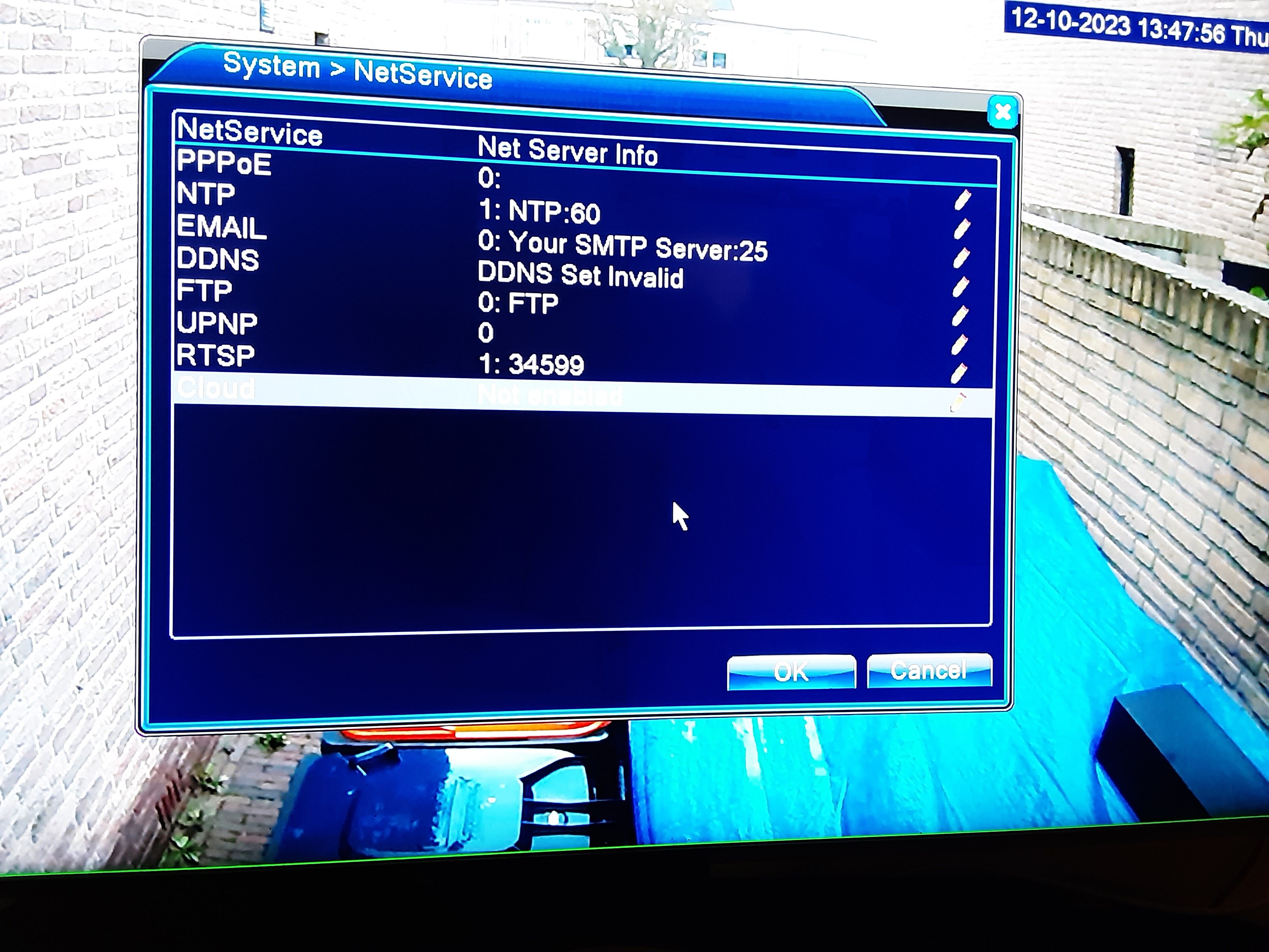

Ok, screen shot of systems page after changing.
I opened the Wizard and checked the dhcp box, the ip, subnet and gateway turn grey and i click ok. On the next screen i click retry to test the network and it still comes up with Test Gateway .......ERR in red.
Should i restart the dvr or change something in the router settings
Should i restart the dvr, change something in the router settings or just leave it alone?

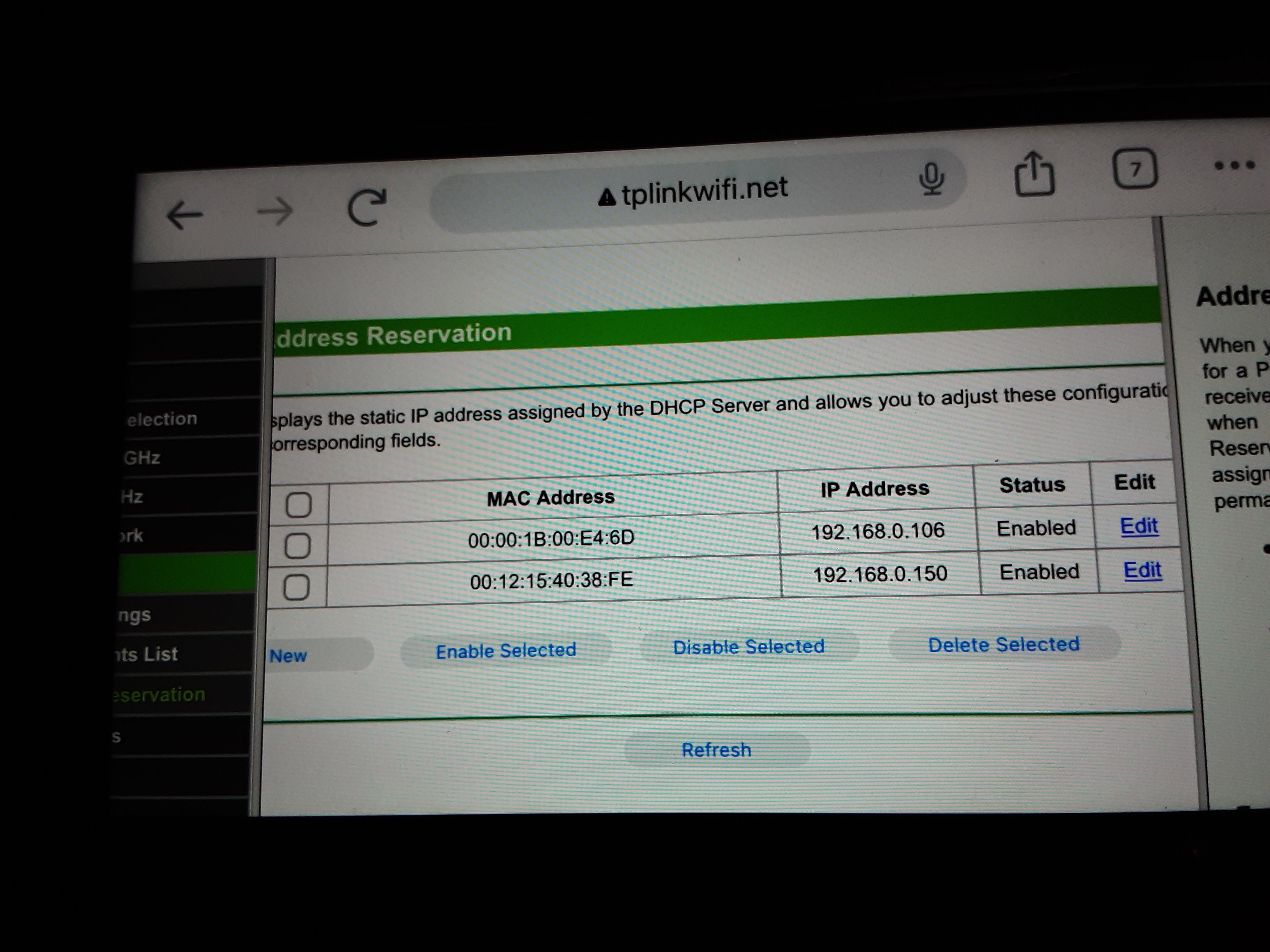

Question,
In my router settings should i 'reserve address' for the camera or dvr and do i need to port forward anything?
Lots of videos mention port forwarding.
Question,
yes, reserve the IP addresses for the DVR and camera, make a note of them. send a screenshot.
On the DVR go to the network page and enter the info needed, send a screenshot if you want.
we'll sort out port forwarding later, baby steps...

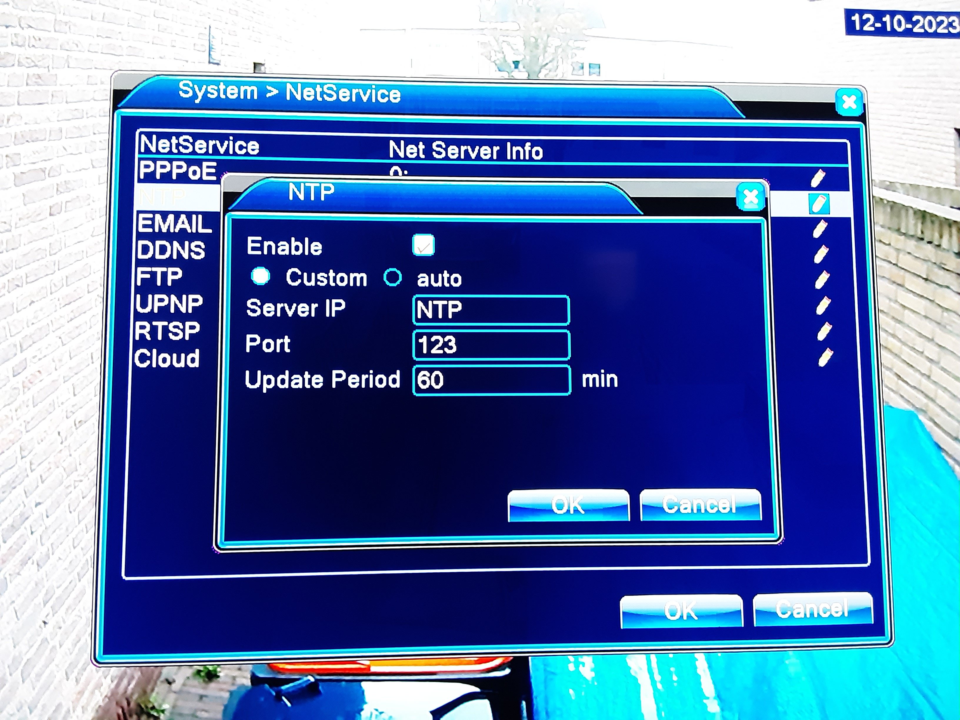

Need to setup on....
DVR
setup NTP
add your DDNS
Camera
Check DDNS add yours
disable UPNP
NTP
Addresses reserved and NTP enabled. It automatically selected custom.

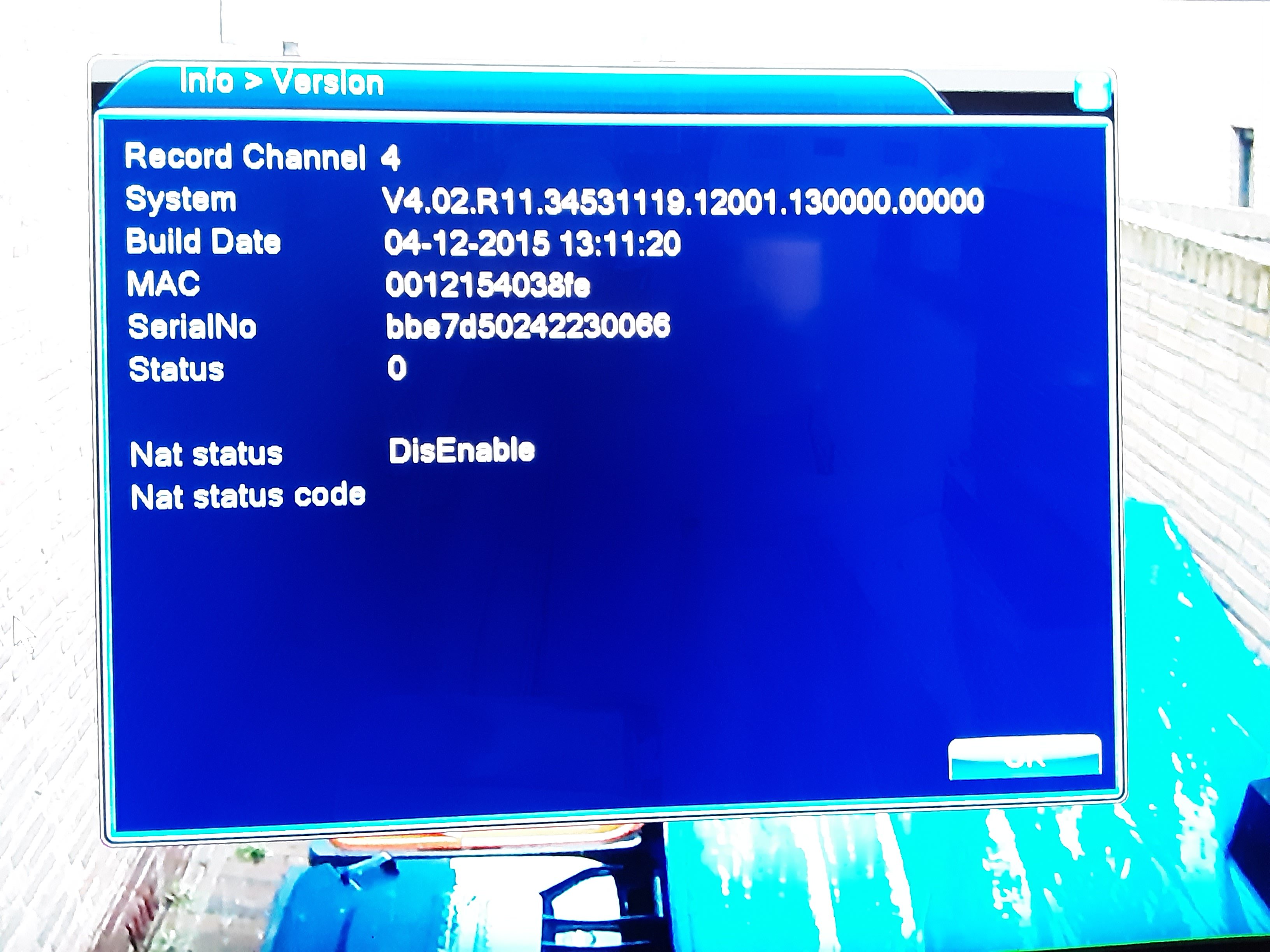

It now says Nat status DisEnable is this correct?
Should i be using No-ip for the ddns?
