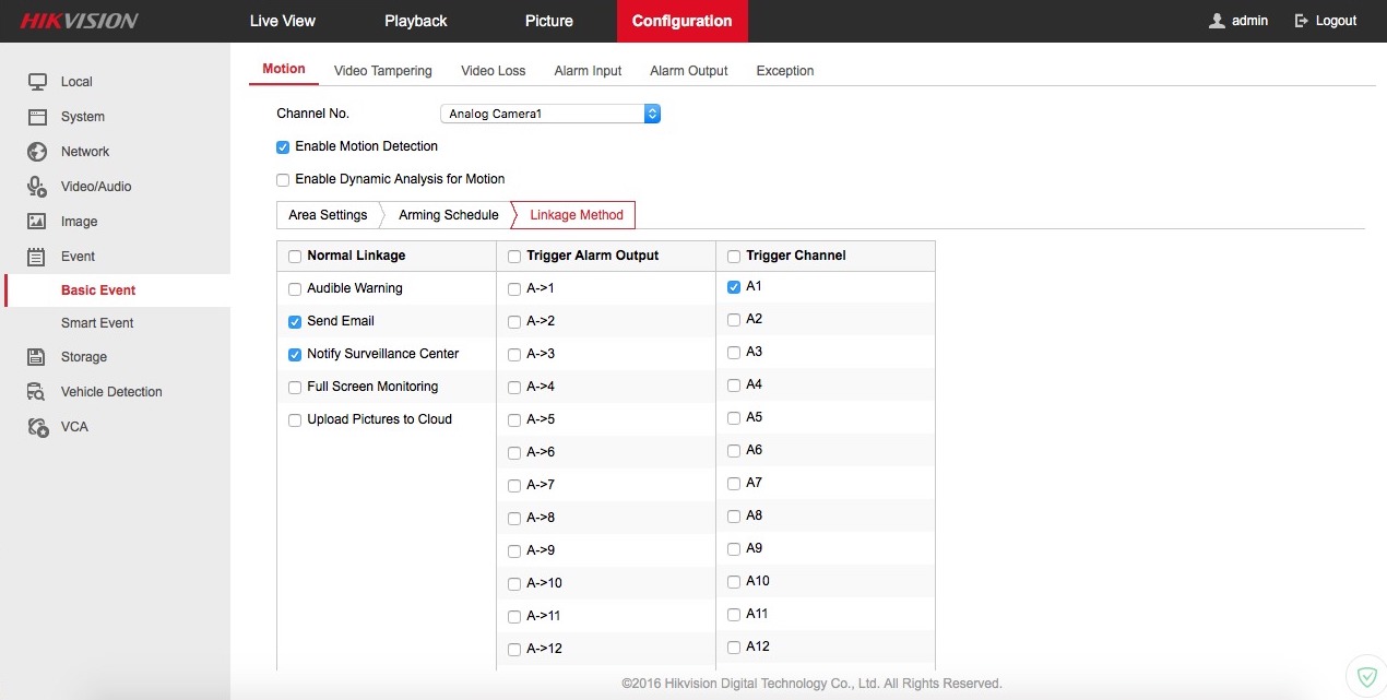

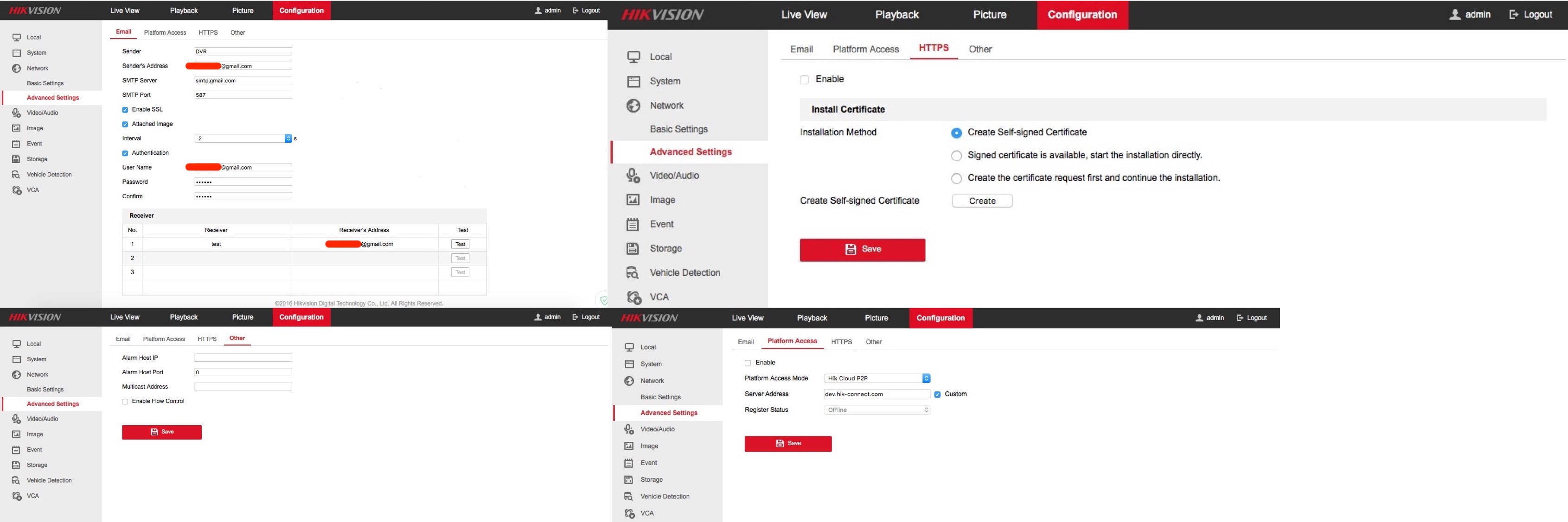

Hi,
I've setup my dvr to send emails to my gmail email whenever any of my 16 cameras detect motion. It was working perfect for a couple of days then suddenly I stopped receiving any emails although I'm sure there is motion happening and also I stopped receiving any notifications on my app. I've sent a test email from the dvr and it arrived to my gmail with success, so I'm not sure what is causing this problem? I'm travelling soon and I need to fix this before I travel. Any advise please?
thanks

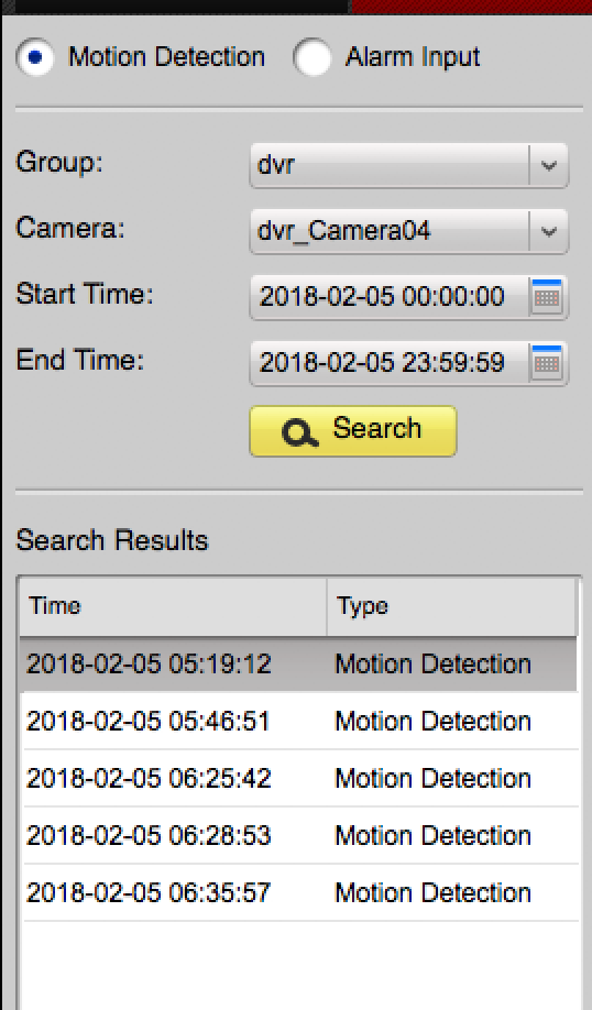

as per your advice, I've checked the log files and there are motions detected for all cameras, which means that the cameras detect motion, the problem is that I no longer get notified by emails or even app notifications when motion is detected. Any advice about step2?
