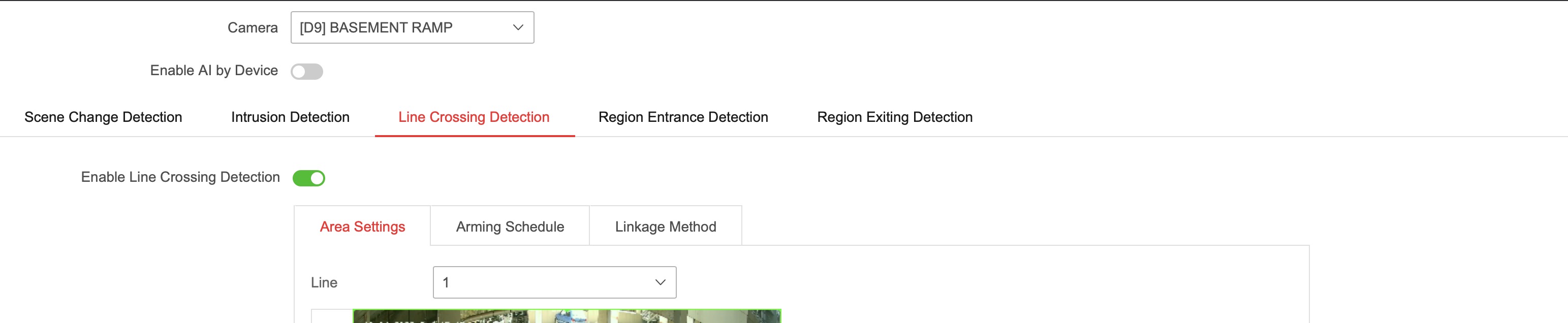

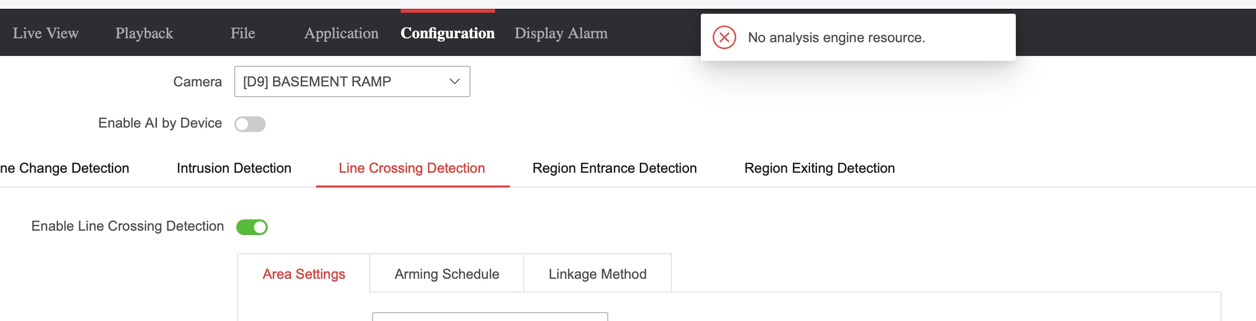

When I try to click "Enable AI by Device" I get the error "No analysis engine resource."

I think I found the issue.
Enable AI by Device is when you have an accusense NVR but not an acusense camera, the NVR can convert up to 4 cameras to acusense by enabling this setting.
All my cameras are acusense already so it happens on the camera and not the NVR

I think you have it the opposite way.
Hikvision told me, if I enable "Enable AI by Device" then the NVR will do the Acusense.
He explained to me that "Enable AI by Device" the device there is the NVR, read differently it should read as "Enable AI by NVR".
The option is there for Acusense and none Acusense cameras, you'll enable that when you are on a none accusense camera.
I also see that same statement is made in the Hikvision UK channel;
Further to this, an Acusense NVR ( Even a 32 channel ) only supports "enable by device/nvr" on up to 4 none accusense cameras.
The issue I experienced is because I in error already had it turned on, on the first 4 cameras. Which isn't needed as they are actually accusense cameras.
