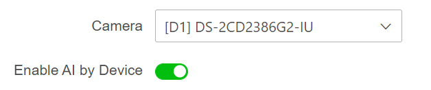

Both the cameras and the NVR have the AcuSense built into them, so make sure that you have "enabled AI by device" for any Smart Event that you're using, as this will use the camera's AI (which is better):

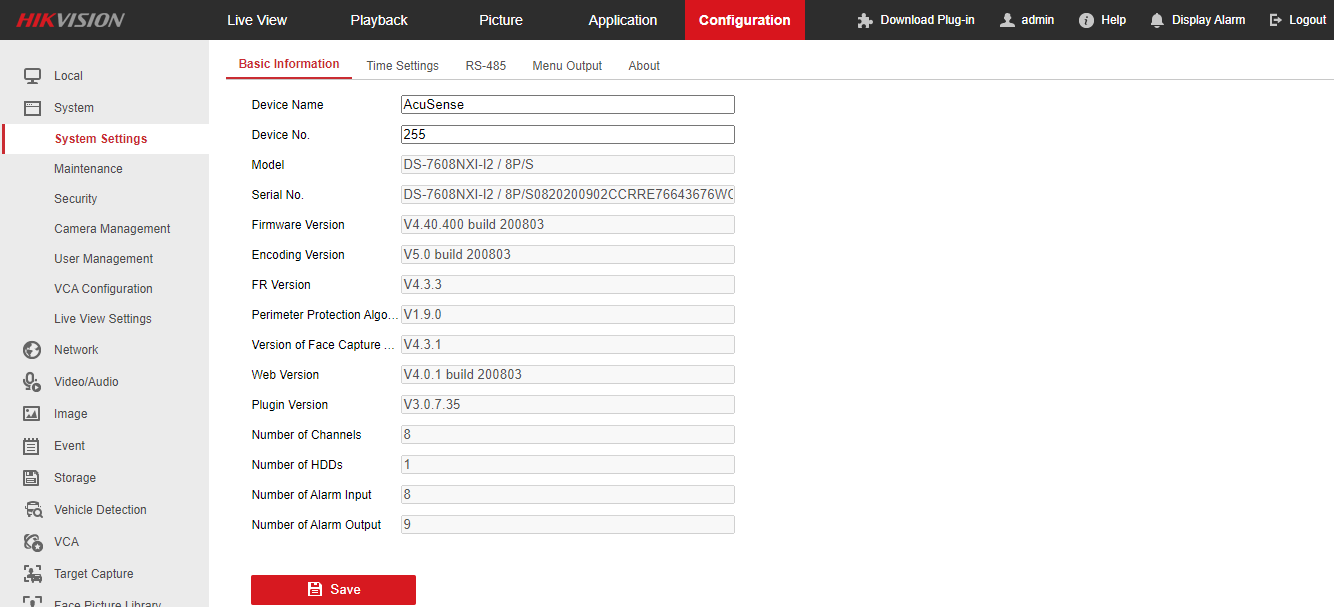

Now I was trying to see which version of NVR I have but not sure where to see if it is with C or without C. Attached the screen shot.
The problem I have is to now upgrade the new firmware, that I guess is the Non-(C) models - V4.40.416

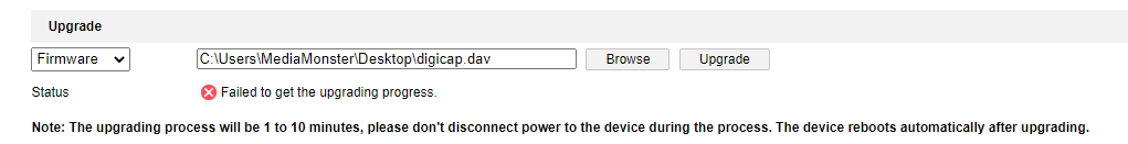

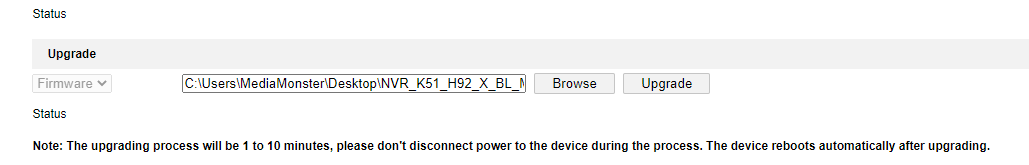

I followed a few online video but didnt work, maybe you have a link to see how to do?
I downloaded it, extracted to a folder, and afetr tried to download from the PC but it seems is not upgrading it...

Same thing happens when I try to upgrade the firmware of the camera.
Log into the camera --> in maintenance add the extracted file ----> Get failed to upgrade

Yes, it should be the non-C firmware for the NVR, perhaps try the version in the European portal for your NVR, which is here - V4.40.416

Also, try again but with the files saved in the "Windows (C:)" folder rather than on your desktop, this used to make a difference.
It could also be a browser issue, so I'd also recommend trying Edge whilst running it in IE mode when connecting to each device:

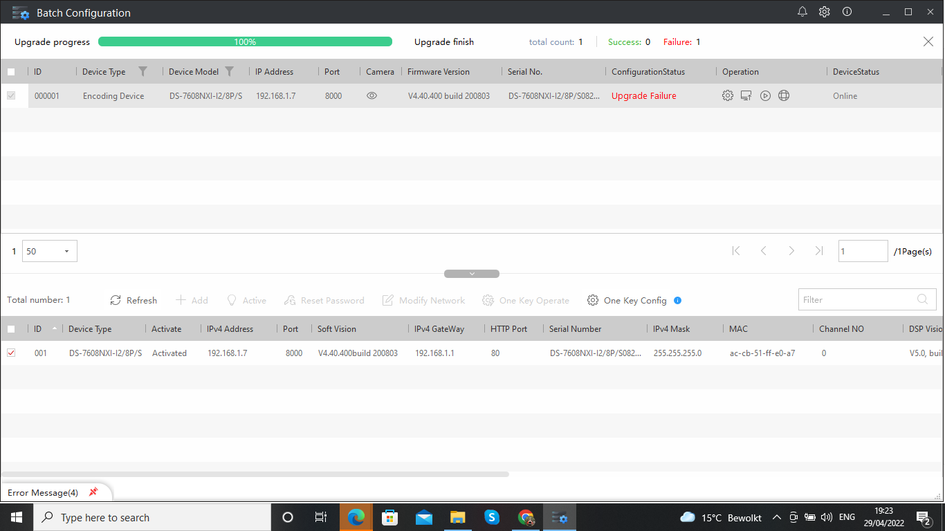

Finally, if none of the above helps, you can use the Batch Configuration Tool to update them using the "upgrade" button at the top of the tool, which should get around any potential browser problems - the camera will need to be connected to your LAN for this though, as the tool will not be able to find it if it's connected directly to your NVR:
Thank you very much Kyle, you are really helping me a lot :)
However Im not lucky, I tried all ways but no way to upgrade the firmware.
Also with the batch file it fails, here the attempt I tried to do with NVR.
No idea what I do wrong :(
Or maybe I have to reboot the NVR? Or other.. no idea :(
Ok Kyle, after rebooting the nvr the upgrade it worked. Still have problems to upgrade the cameras but will try more. Grazie amigo

After the upgrade, I tried to set all the smart events from the NVR as suggested by activating in all cameras the
´Enable by AI Device´
However this was giving problems, as I could set only 1 camera in this way why to the other cameras I was getting the following error message:
´Not enough engine decoding resource´
I could solve this by un-clicking the ´Enable by AI Device´ for the remaining 3 cameras so that I could set the Smart event.
So I have the following situation:
1 camera ----> I left the smart event set with ´Enable by AI Device´
3 cameras ----> I have the smart event set without ´Enable by AI Device´
If I well understood, the ´Enable by AI Device´ it means that event will be analized the Acusense of the NVR ---> Indeed Device = NVR
so in my case I have 1 camera that uses the NVR acusense and the other 3 cameras that uses the acusense of the cameras.
Not sure if I well explained but just to have your point of view if this is the right setting to have as I still get some false alarm, even if it seems less than before.
