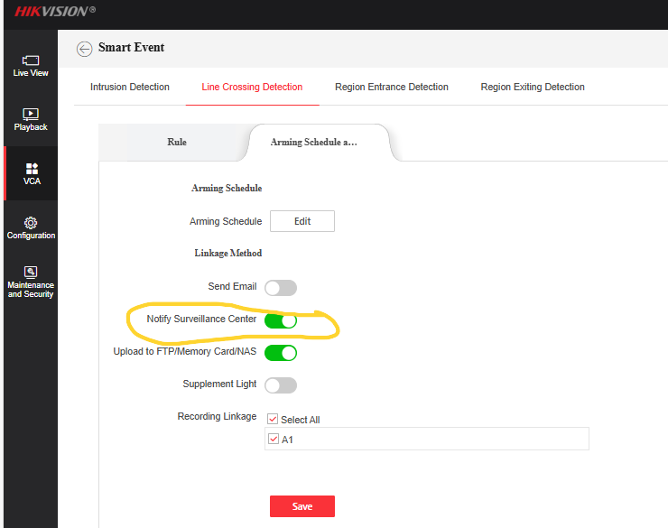

Is "Notify Surveillance Center" for Line Crossing Detection checked? ...
(DS-2CD2346G2-IU), firmware version 5.7.13build 230706

Yes, of course.

No - it won't in this case because there is no problem. Line crossing cannot be set up using Hik-Connect so you won't see teh options in Hik-Connect even if you've set it up in the web UI. You just need to set up line crossing first by logging into the camera with a web browser. Set up the line crossing, make sure that the option in Linkage Actions for Notify Surveillance Center is ticked. Once thats done the alerts will come through to the app.

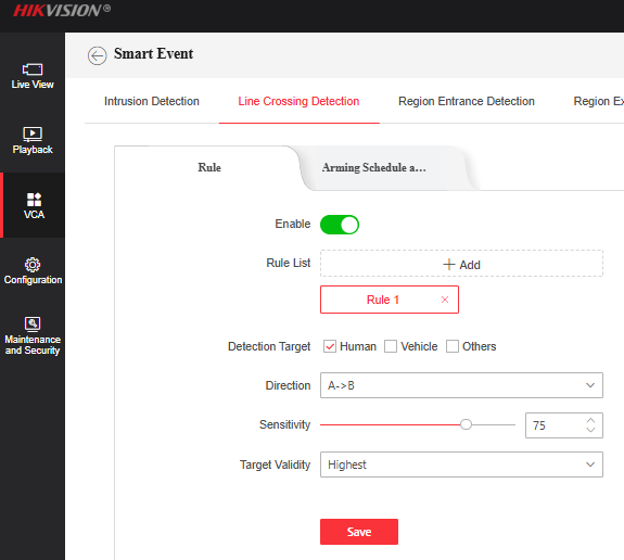

I just made it. No notifications sent.
But i suspect the detection is not working on the camera, because i cannot see any detection in timeline playback.
Do you have a video or guide for help me check my line crossing setup? Can i disabled Motion detection and keep enabled only cross line detection, or both have to be enabled for working?
I cannot send it now, i'm not reach web gui camera now, but yes, configuration is like this.

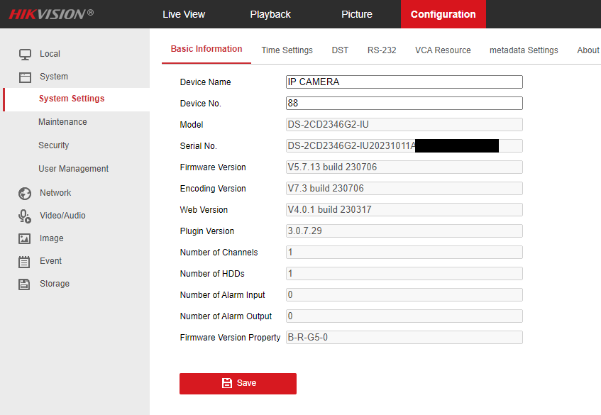

If your camera is a G5 platform, which should be so since there is no v5.7.13 on G3 platforms, then try also firmware v5.7.15 240411. Firmwares v5.7.13 and v5.7.14 had issues with Detection..
Europe and UK firmwares are the same.
Be sure yours is a G5 platform
Is it G5 platform? Should i read Firmware Version Property to get it?
