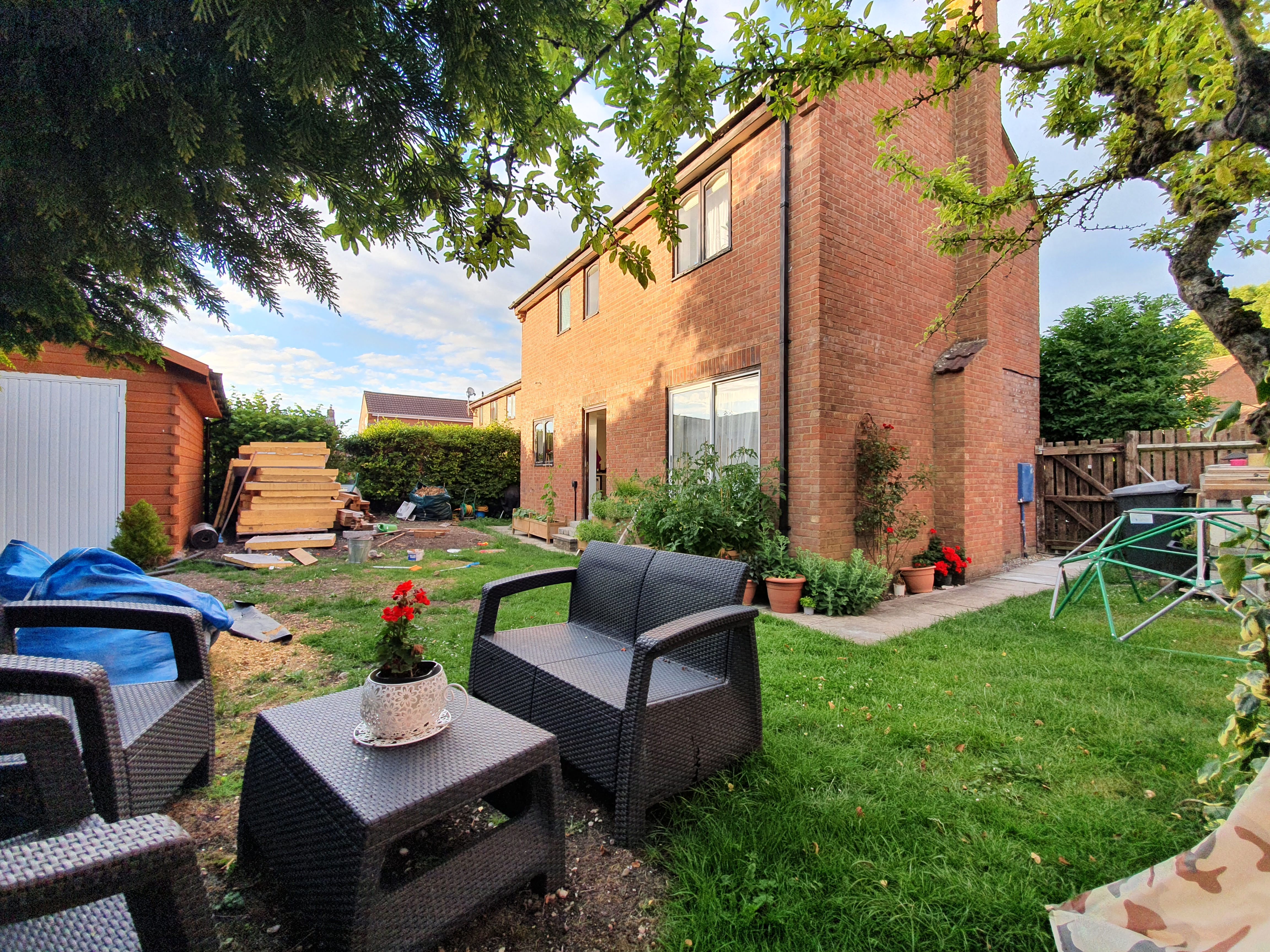

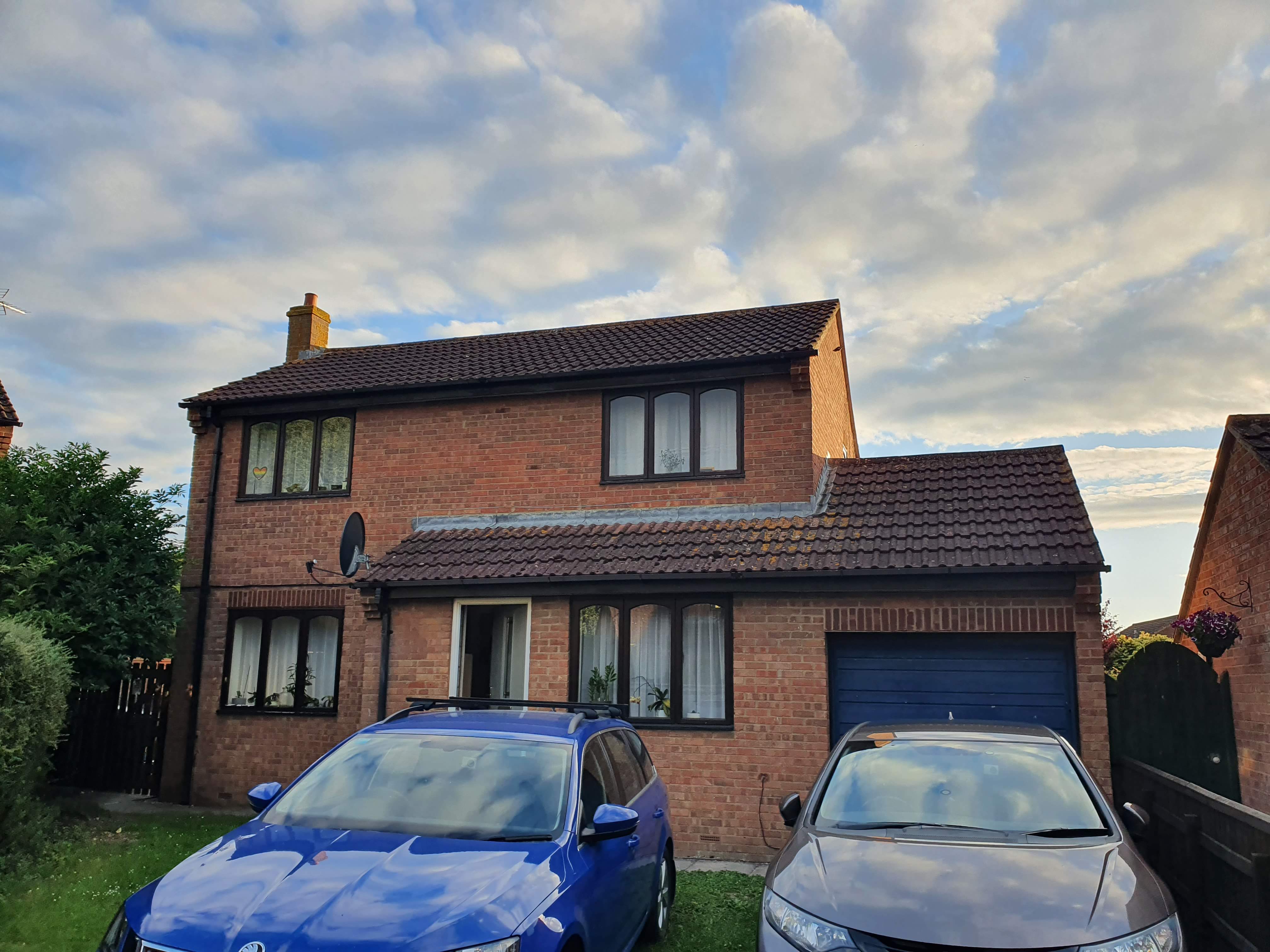

Hi Everyone. I'm about to set up the 4 outside camera system (with additional 4 internal to add later on). I read that Hikvision DS-7608NI-I2-8P is the NVR i should go for so will just need help with choosing the right cameras for my scenario. I'll have 4TB purple WD hard drive but can install bigger one if necessary. I want to have one camera by the door bell to see who's at the front door, another one to overlook the driveway which is about 4m long and 6-8m wide. Possible location of the camera is on the soffit just above the garage door in the corner ? I'd also want one or two in the back garden, it's L shaped so will probably need to go with two for full coverage. One camera need to be fitted inside the garden shed in case someone has managed to break in. I'd like to go with 8MP cameras but if it's not going to give me massive advantage over 4MP camera then I'll go with the latter. For easier installation I'd opt for POE type of cameras.
I will be installing these four floodlight all way around the house as the garden and side of the house are completely dark in the night, front of the house benefits from street light around 20m from the house but will also have one floodlight to right of front door mounted on the soffit.
Can someone please recommend best price/value option to go for. Many thanks for your help.

Hi @matooh
If you are going to have floodlights around the property and you have streetlights out the front then we would recommend using ColorVu cameras as they have improved hardware (larger sensor, bigger aperture, etc...) to achieve colour images at night but they work best when there is additional visible light. The model we would recommend is the DS-2CD2347G1-LU 4MP ColorVu Turret
The ColorVu cameras do have built-in floodlights but these are often not useful in residential scenarios as unlike your security floodlights the built-in lights stay on all night for the period of time that it is too dark for the camera to see without them, but if you do have other visible light in the scene you can disable the built-in floodlight. This forum post includes some screenshots showing the images you can get from a ColorVu camera.
4TB will be enough to give you roughly 14-days recording from 4 cameras, the 7608-I2 NVR does have space for 2 HDDs so you can always add a second 4TB (or larger) HDD once you do add the other 4 indoor cameras.
