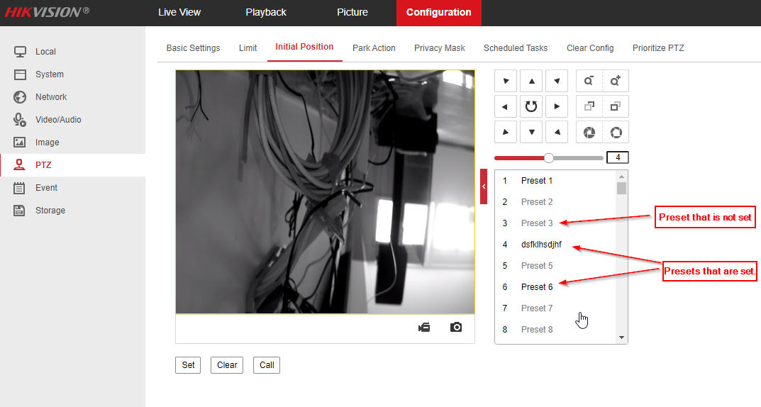

Hello,
I'm not sure is this the right place to ask.
Camera model: HIK VISION mini ptz camera, model DS-2De2A404IW-DE3
SDK: EN-HCNetSDKV6.1.6.45_build20210302_win64 (Device Network SDK)
Question is, is there way that we can via SDK get information what preset is currently set?
To be more precise on web page of camera, under "Configuration->PTZ->Initial Position", there is a list of presets and presets that are already set have stronger black color.
Kind regards,
Renato.
Yes - you click on the preset you want to find out about - and some icons appear next to it - one of them is 'call preset' (From memory is the middle of the three icons) so you can see where it's been set to. The others are 'set' and 'delete' if I recall correctly. Just hover over them to get the exact description.
