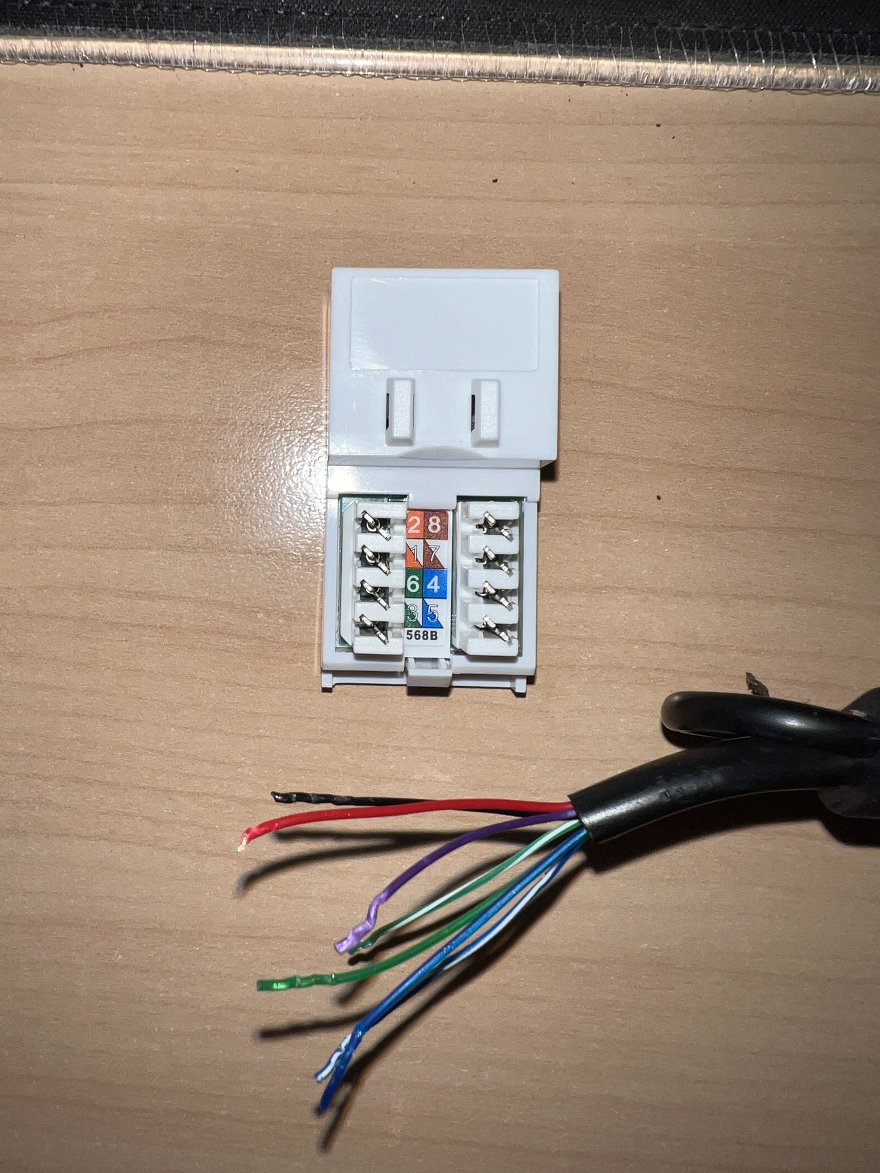

Hi!
I have the above, where the Ethernet plug is destroyed by corrosion (I stupidly threw it away)
In order to protect it a little better, I want to terminate the existing cable into an RJ45 socket.
Problem is, the wiring colours are not Ehternet standard - please see the pic below - which wire goes where please!
john
You'll probably have to try to get this info from the manufacturer / reseller.
I don't think anybody else is likely to know :(
Perhaps they could send you some photos of a plug on a new product?
(showing the core colours / pin-out)

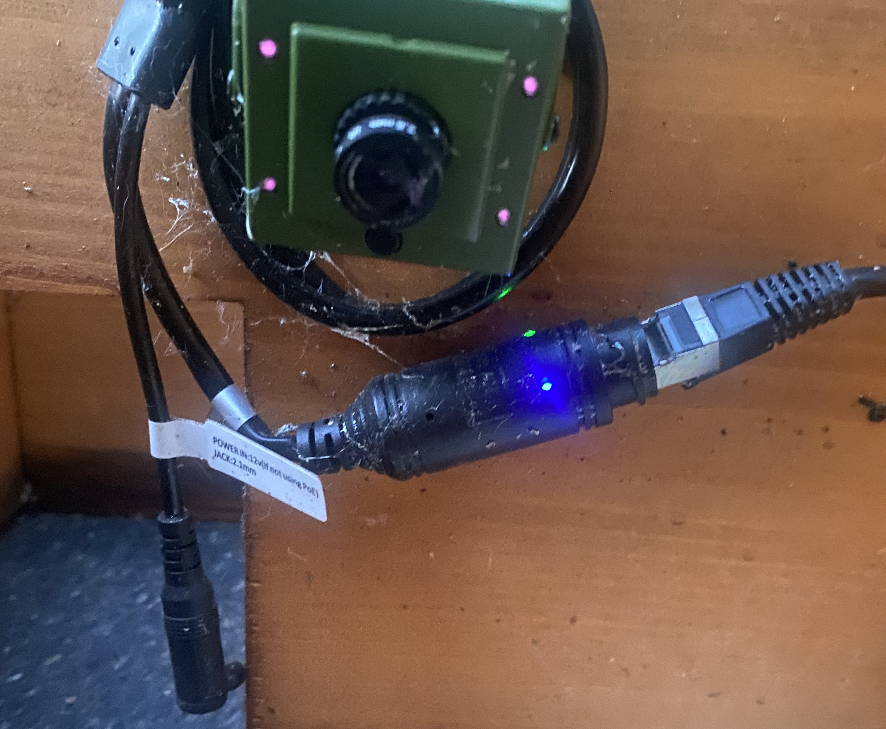

I don't think I have the same model as you, my cameras have a rj45 socket. send a picture so I can see your cable and camera together. If needed are you happy to take the cover off the camera (this could invalidate your warranty) and send a picture of the internal pcb connectors?
Ah yes, it is the same camera - and yes, mine had a socket, not a plug - sadly it looks like you cannot see the colours of the wires in the socket
I've got one on the desk next to me - but it's a sealed socket with no way to see how it's wired.

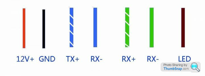

I'm getting closer with the forum on Computing forum at Pistonheads - someone has similar cables:
Yes, I have - no answers yet!
The red and black cables are probably the 12Vdc supply to the components in the rj45 socket assembly. Take the back off your camera and send a picture of the pc. I’ve repaired these cables and think the wires go to 2 mtrj connectors, for Ethernet and dc.
