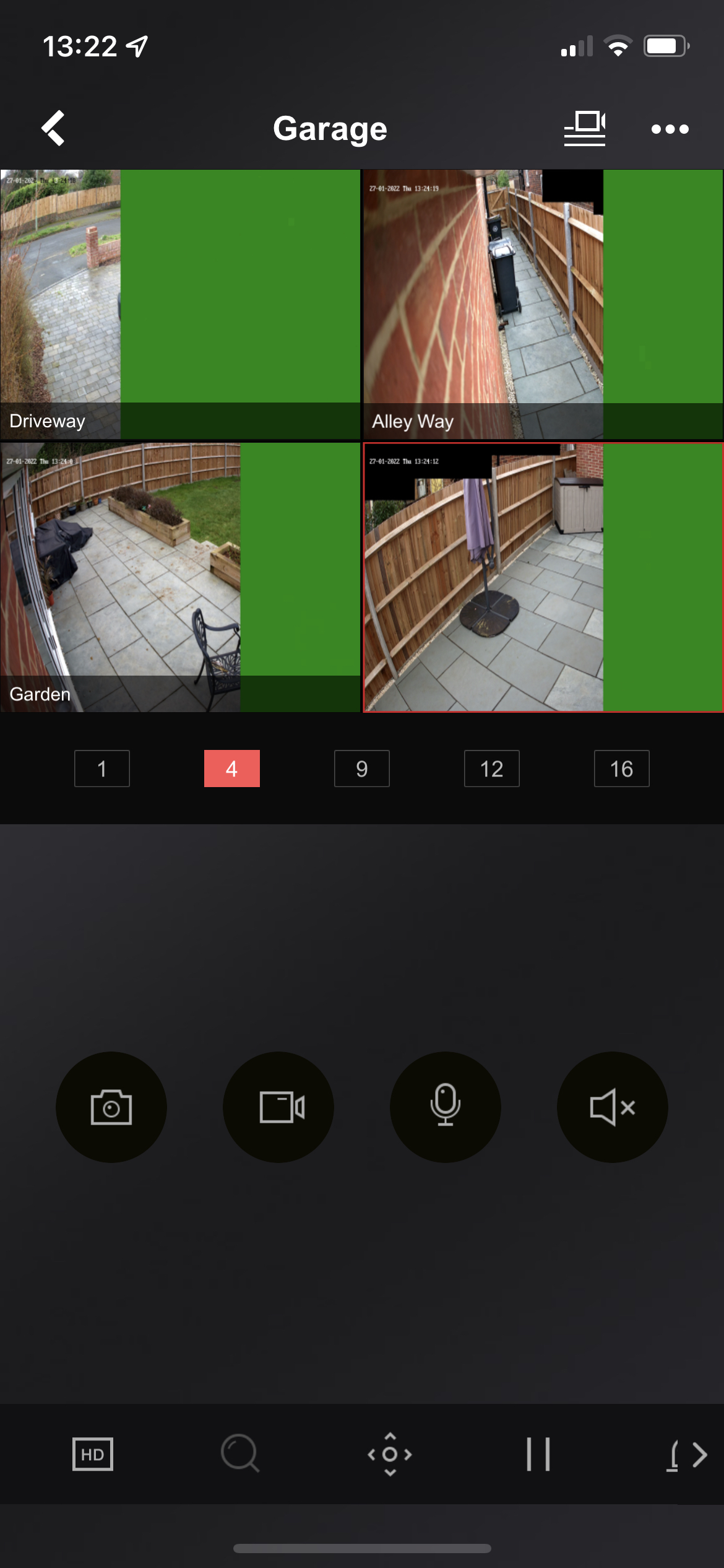

I saw this post/ saying there was a new firmware to install for my cameras. so i installed it. Now i am seeing green boxes on my hik connect app. I have noticed if i change the view from HD to basic the green boxes go away but the live preview isn't great. It never used to do this until i upgraded my firmware.
Do i need to downgrade the firmware? Which firmware would not have this issue?

It's a bug with that camera firmware (and I think some of the new I-Series NVR firmware), it's been reported by a few on this forum.

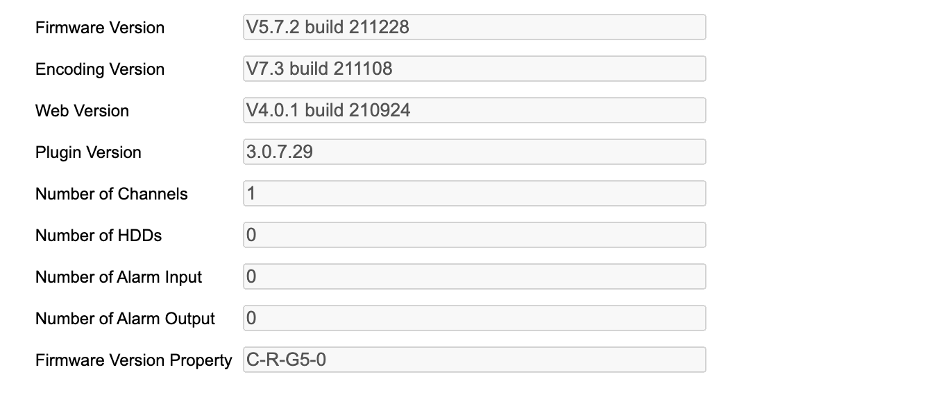

Does this firmware for the cameras solve the problem? - V5.7.3_211222

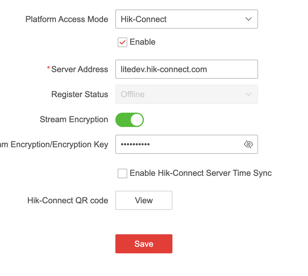

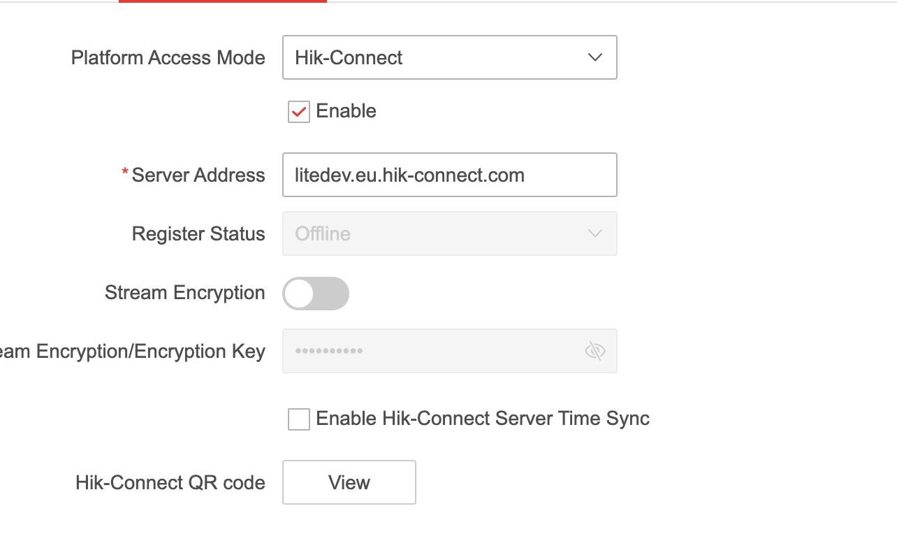

Is Hik-Connect enabled and showing as online in Configuration Network Advanced Settings Platform Access?

What does it have set as the server address on this page?

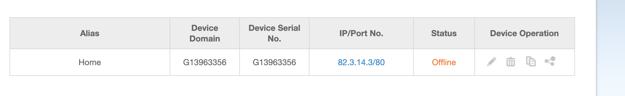

No the status says offline. I thought it was some sort of network issue but i cant seem to change anything that makes a difference.
When you say unbind it. do you mean delete it from here?
I think I've made the situation 100 times worse. I have just removed it in the hik connect account and when i re enter the serial number it says that device is offline.
I think I shouldn't have deleted it as i have just checked my router and it says my NVR isn't connected to the internet. i've tried all the different settings that are out there and seem to not get this NVR back online

Have you changed the address on the Platform Access page from what it was when it was online before?
Are you clicking save at the bottom of Platform Access after enabling Hik-Connect?

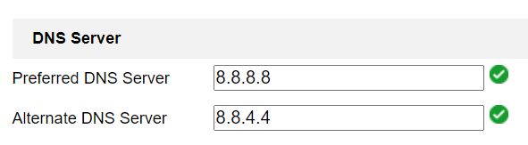

In a browser, on Configuration Network Basic Settings, check that your DNS servers are set to these:
Once the register status is "online" in that Platform Access page, the camera should start working in the app.
I have tried all of that and it looks like the NVR is connected to the network but not connecting to the hik connect servers
If you go to enable Hik-Connect on the NVR directly in Platform Access, does that work?
Try these server addresses too:
dev.hik-connect.com
litedev.hik-connect.com

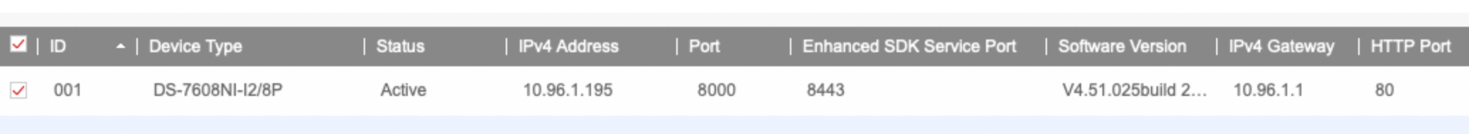

Can you post a screenshot of SADP with the network parameters for the NVR showing please? (You'll need to tick the box for it to show this.)

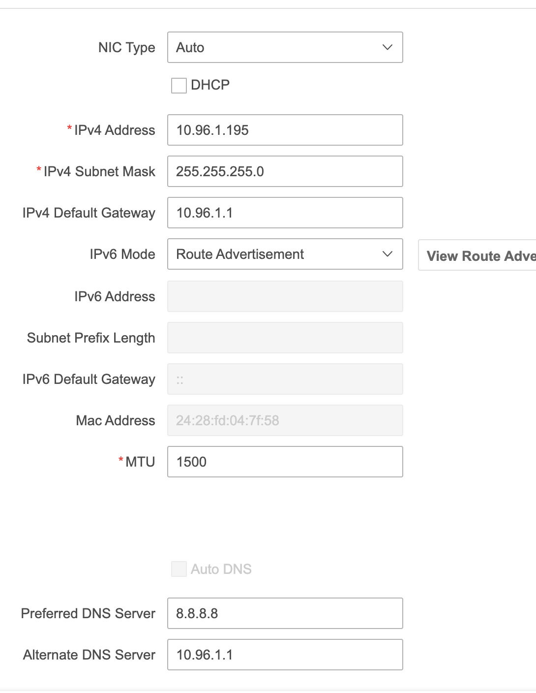

And also a screenshot of Configuration Network Basic Settings TCP/IP?
Here is a snapshot of the SADP tool
and here is my TCP/IP page:
I have tried changing the dns servers to different numbers e.g alternate to 8.8.4.4 and 1.1.1.1 but i know this current setup works because when i go on to the nvr with a monitor and i test 8.8.8.8 i get a dialog saying 0% packet loss and another string i cant remember what it says now but looks like that is working. also just for safety I have told my router to reserve the IP address of this NVR so nothing in theory should get given that IP.
Thanks, those look fine.
I might need to ask Hikvision about it, as it could be a bug with downgrading to this firmware.

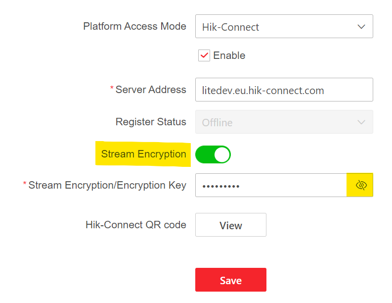

Before I do, can I check that you have turned on the stream encryption again before clicking save after enabling Hik-Connect?
You can check that this is still the same by clicking on the eye icon in the field below this:
Thanks, I'm not sure why the "register status" isn't changing to "online", as it normally should!

Yer i have tried chrome and firefox on my mac. I dont have a windows machine to use. ive even disabled it. restarted the NVR waited 15 mins and then enabled but still offline.
