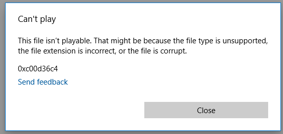

EDIT: I have managed to get the file onto a USB stick but now I cannot play it, I get an error message as per the image that I have just attached. Hope this will help someone provide an answer. The file has been saved and exported as mp4 and I am trying to play it in Windows Media Player. Thanks again.

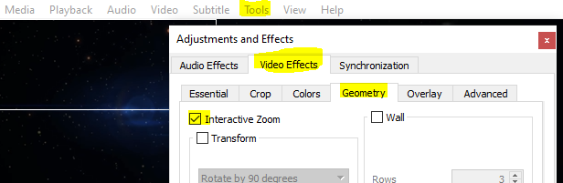

Another EDIT: I have now cracked this. I have downloaded something called VLC Media Player and it works perfectly. Does anyone know if there is such a player that has a digital zoom facility built in?
