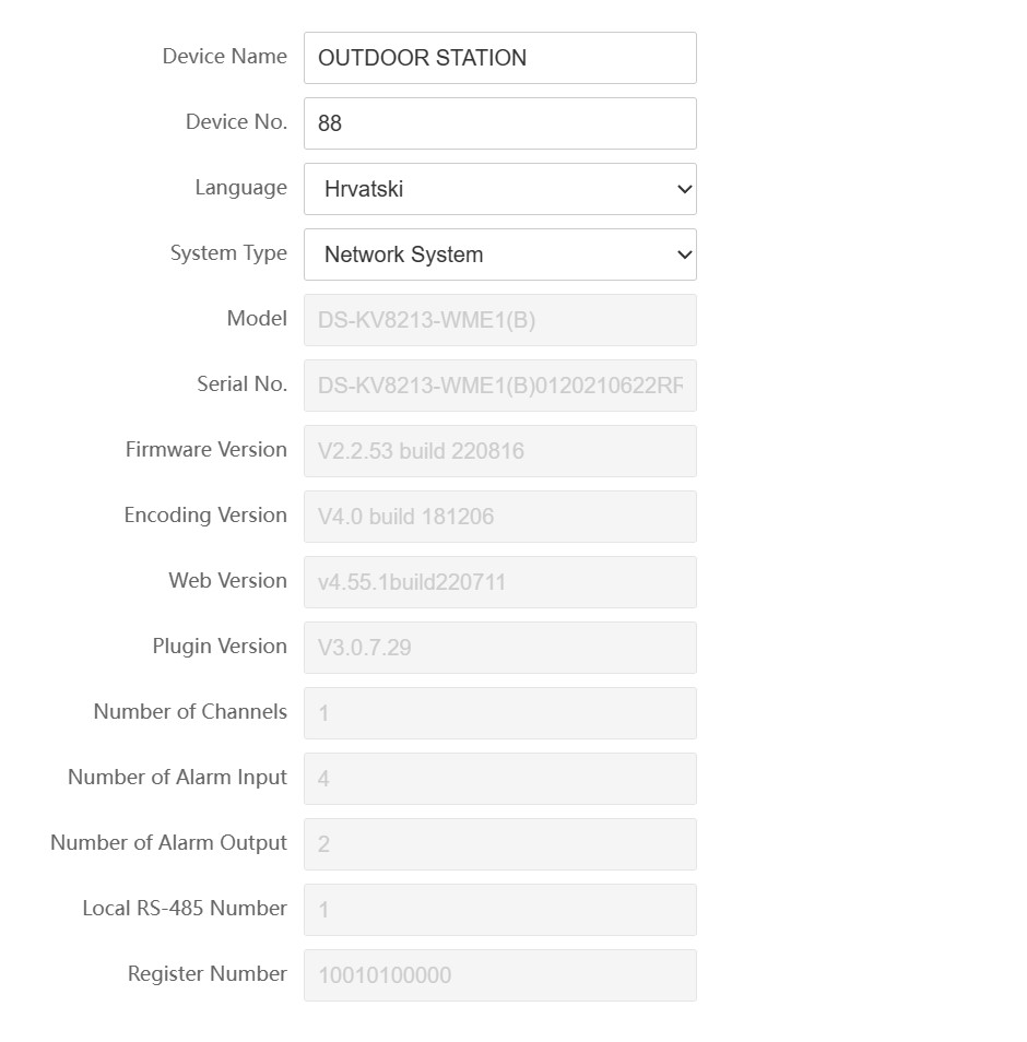

I've seen this problem solved by adjusting the video settings on the doorbell or updating to the latest firmware.
Is the doorbell using firmware V2.2.53_220816?
Can you please also confirm which version of Hik-Connect you are using?
Firmware V2.2.53_220816
Hik-Connect v5.2.2.0517

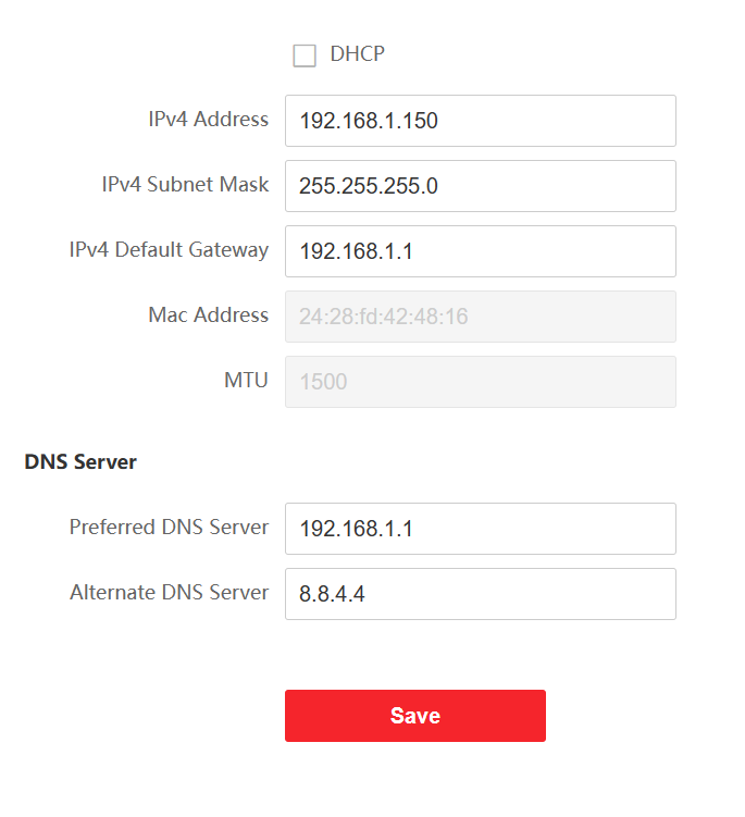

Is there something wrong here?

It looks correct, but double-check that your router's IP address is set as the gateway.
Also, try the preferred DNS server as 8.8.8.8.

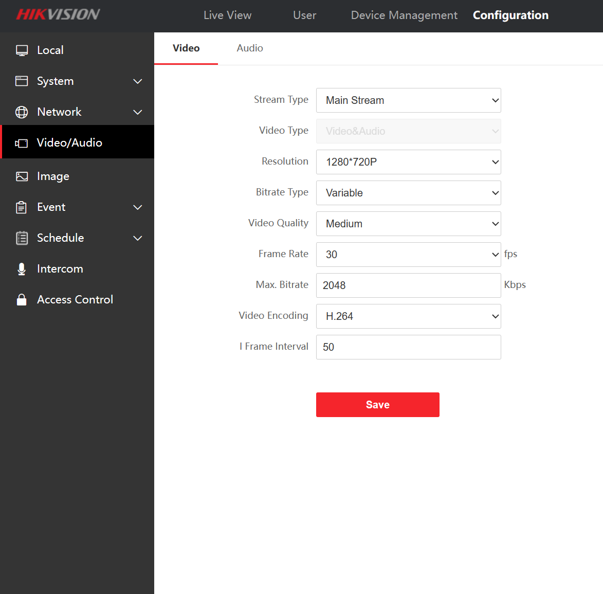

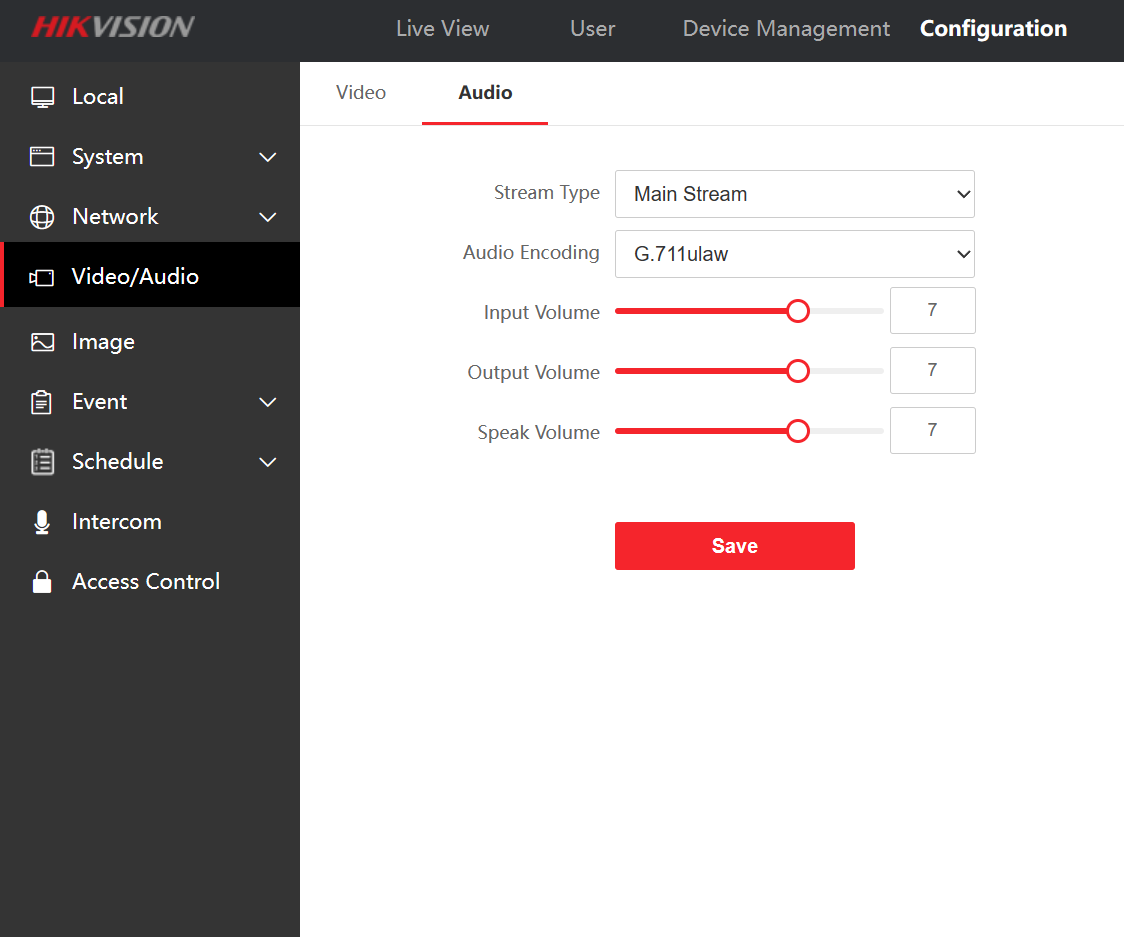

Can you also send a screenshot of your video settings for for the doorbell please?
I will try to set the settings to 8.8.8.8
