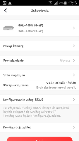

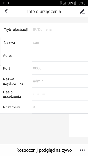

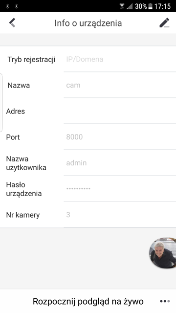

In android app I don`t have encryption option. Look:
1) connection via hik-connect platform
2) connection using IP address (I delete from photo adres)

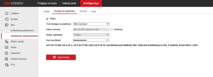

And settings on NVR:
