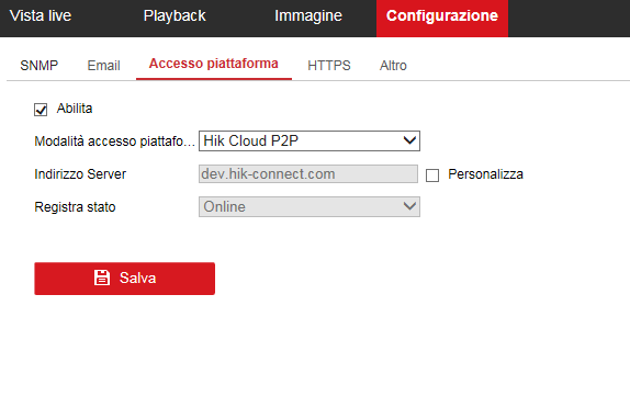

This is the Hik-connect system, at a certain point the notifications were no longer available. As a result he tried to delete the device from the application trying to reconfigure everything from the web interface. As per the instructions, insert nr. DVR serial number, the system finds it, adds it, then asks for the verification code and insert it. At this point the system keeps on communicating that the code is wrong. I state that the code is what you see in (Network-Access platform). Can you help me? thank you Paul.

What model DVR do you have?
Are you running the latest firmware?
Model DS-7604NI-K1 / 4P
Firmware: V3.4.82 build 160914.
It is likely that I have the old version. I'll probably have to update the firmware, right?
