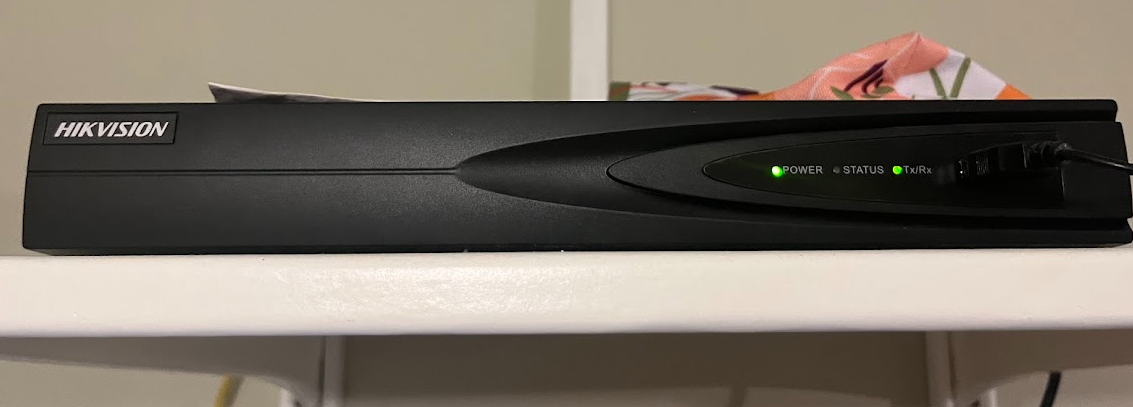

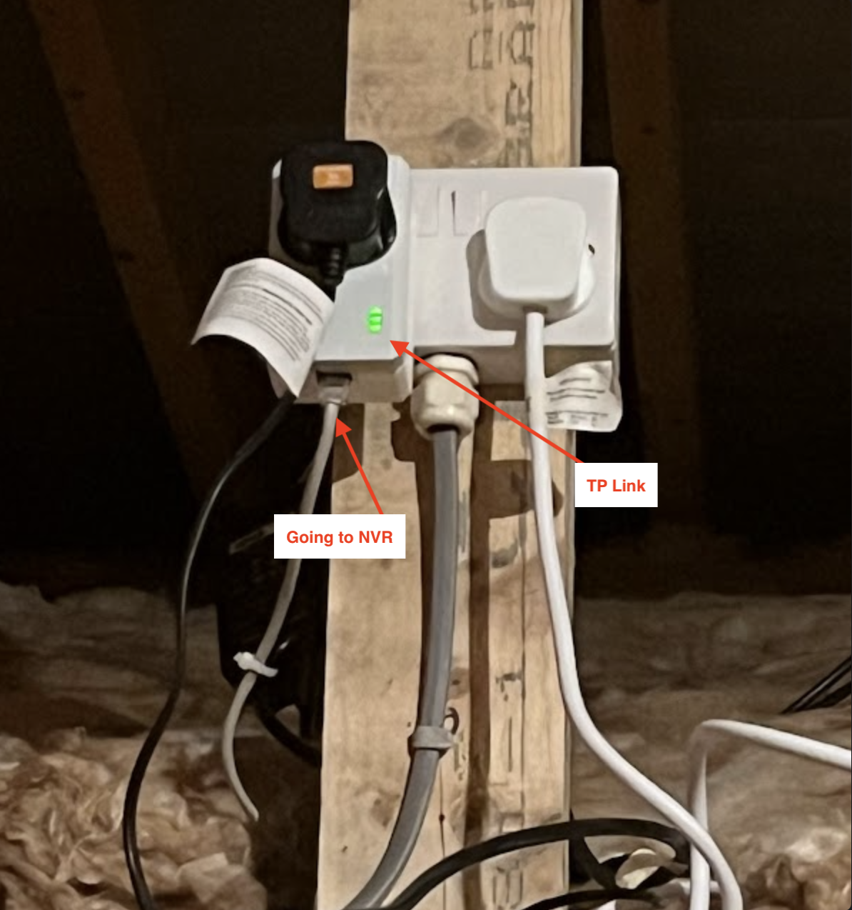

Ok so these are photo's of the setup as best I can take them. Most of the equipment, plugs, wires are in the attic. It's a load of wires up there.
The wires come down to a utility room where the NVR and TV screen is.
The back of the NVR has 4 ethernet ports and there are connections in 3.
There is one internet port and that is connected to the TP link in the attic that also only has one port. It is this TP link port that I connected the laptop to check if there was a signal in that TP link.
I hope that all looks like something you recognise.
That box in the loft is your TV aerial amplifier/distribution and has nothing to do with the CCTV.
If that's the case everything goes into the back of the NVR in the utility room

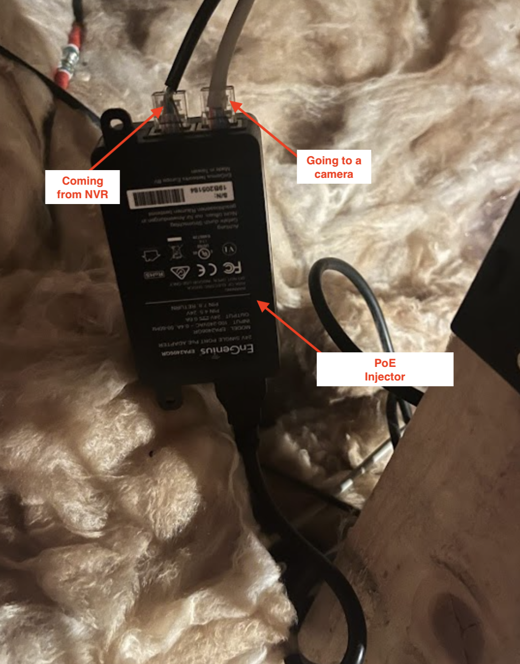

Yes it looks as though your IP cameras are connected directly to the NVR PoE ports. As said the box with all the coax connections is TV distribution. I can see that the TP Link looks to be working with all three LEDs on. I'm not sure what the passive PoE injector is being used for (the 'Engenious' bit with two network connections).
In order to prove there is a connection through the TP Links (or however it is connected...are you 100% that the TP links are for the CCTV and not something else?)

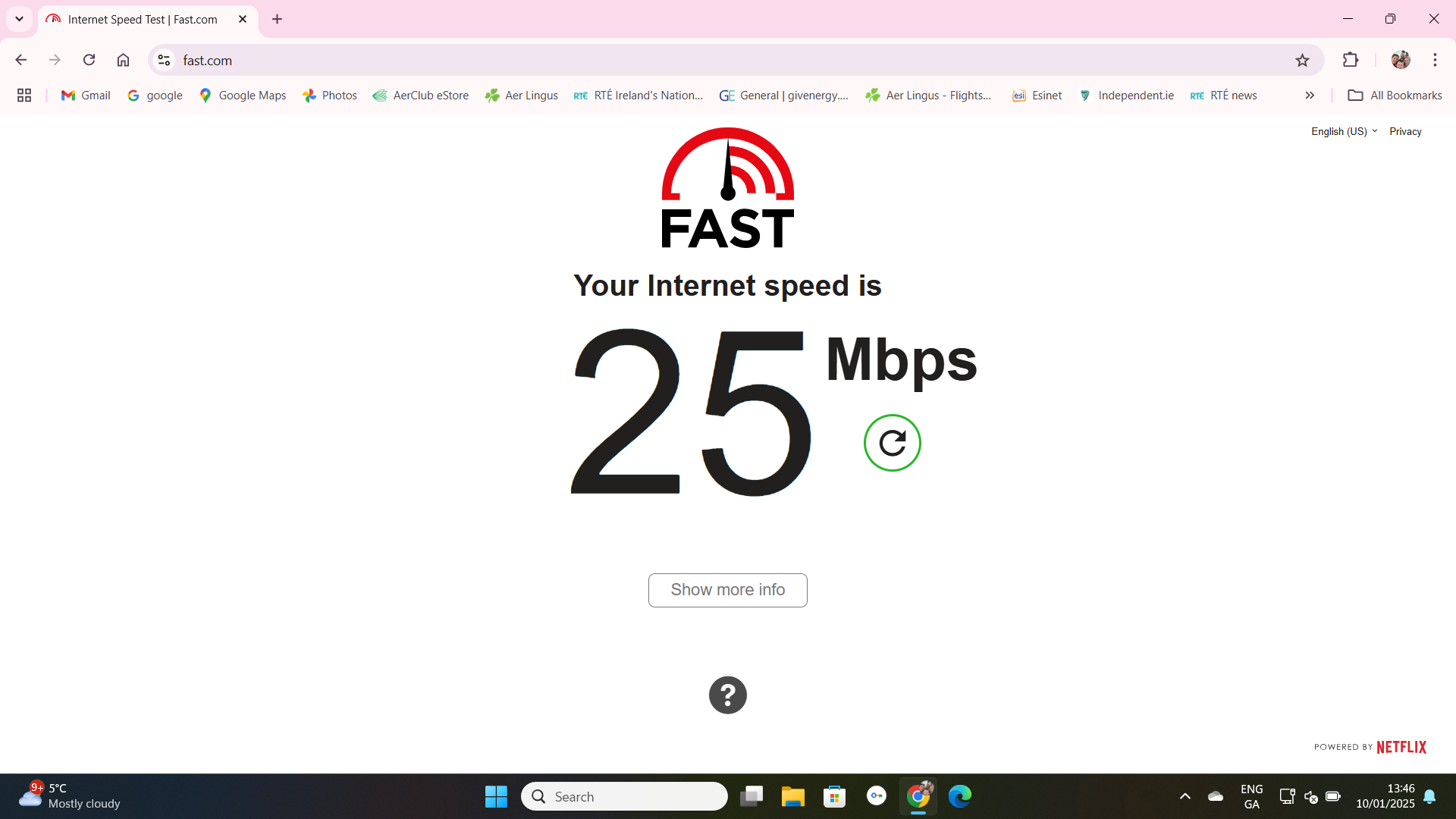

Pull the single LAN connection from the back of the NVR and connect that to a laptop. Ensure you've an internet connection by going to Speedtest.net and post the result. Using that connection will prove there's a valid connection end to end.
Just plugged in laptop as directed and yes there is a connection in the ethernet

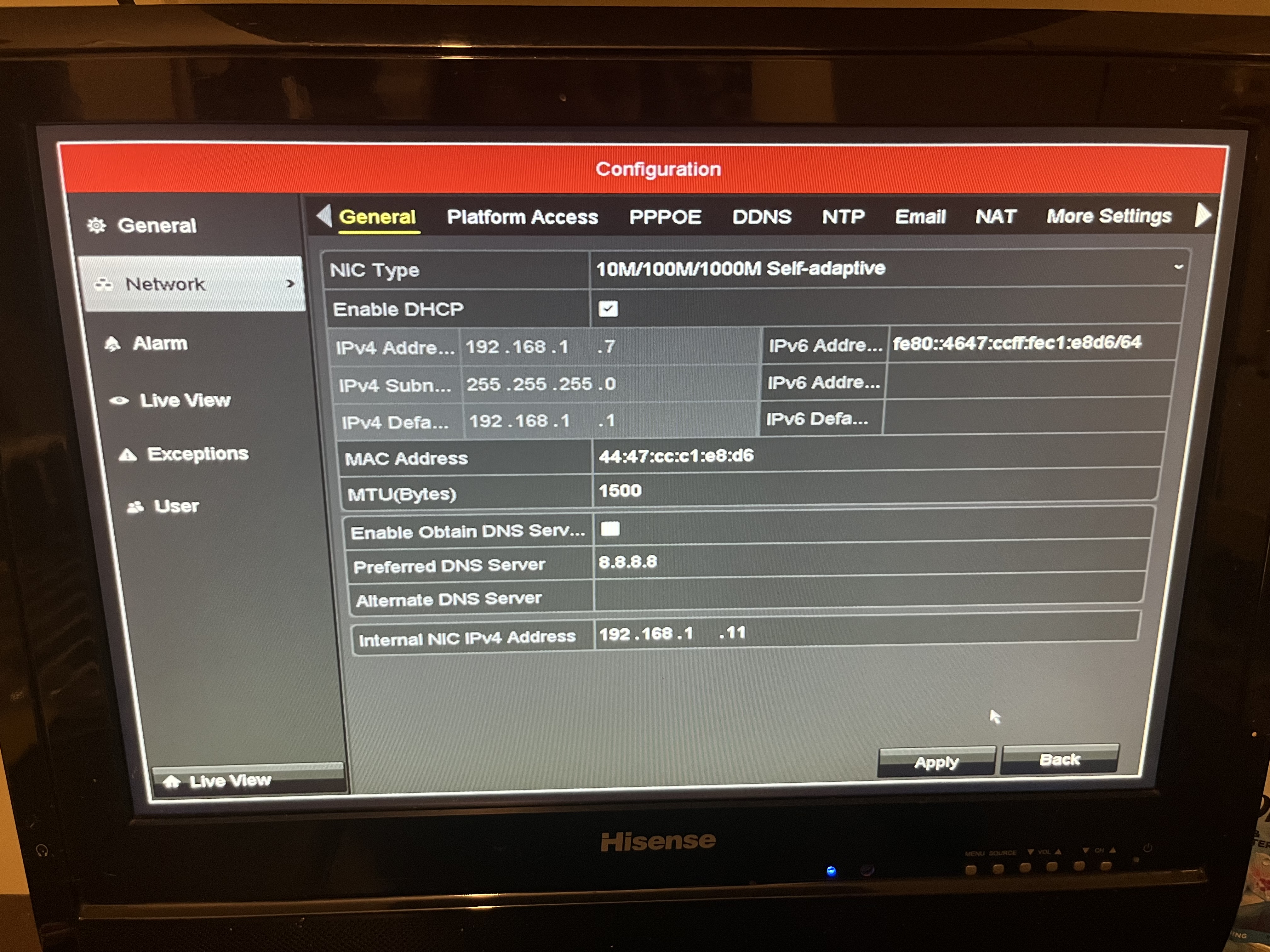

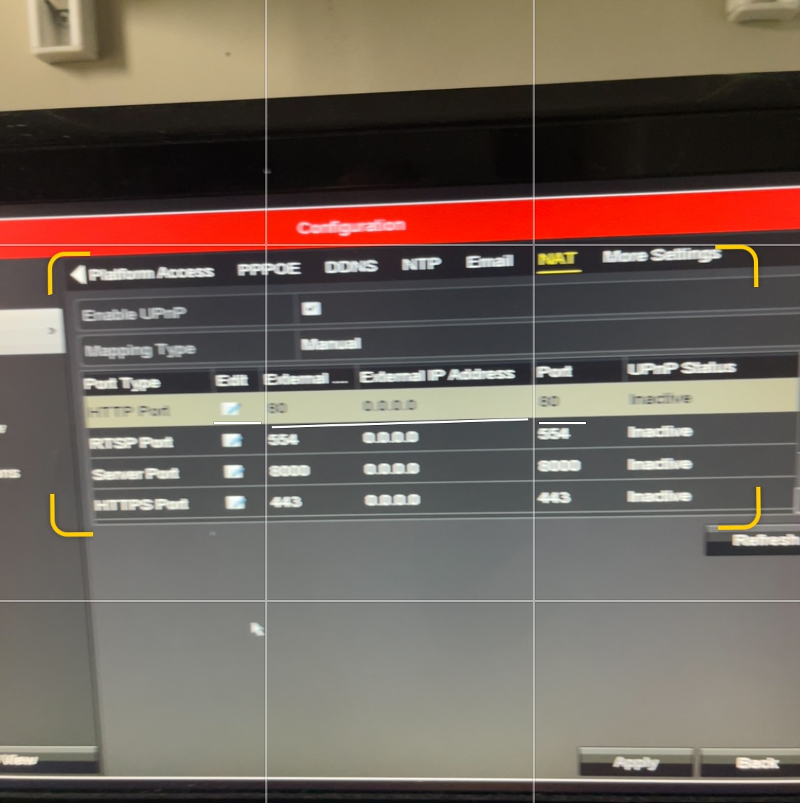

On the Network Settings can you click the 'NAT' tab at the top and ensure that it is switched OFF. If it is on, switch it to off and save.

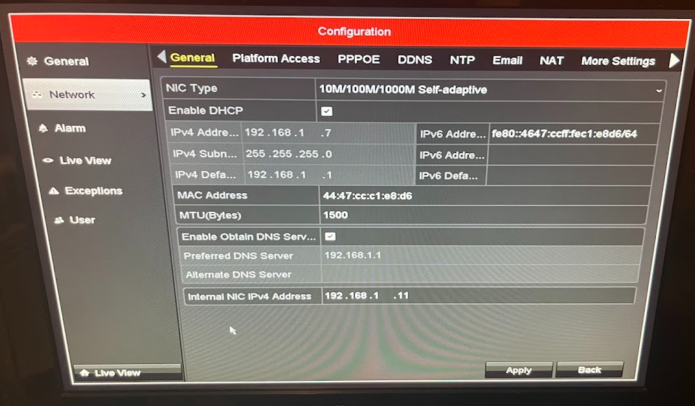

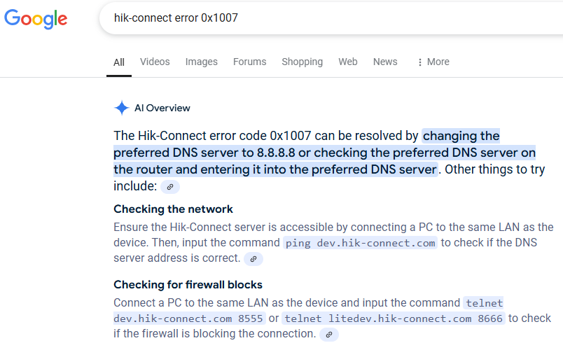

It has come back online. I changed the DNS TO 8.8.8.8 and suddenly it went online. However now twice the NVR has re-booted ??
Disabling UPnP is what will have sorted it. The NVR will have been trying to map ports that may have been use. If it does reboot again, reboot the router when you can as that will clear out any previous sessions.
Looks like it's for one of the cams. Why I'm not sure. Maybe the cable wasn't long enough and that's what they used as a solution.
I think also unticking the UPnP was why it was fixed. It hasn’t rebooted since so fingers crossed it’s all good now.

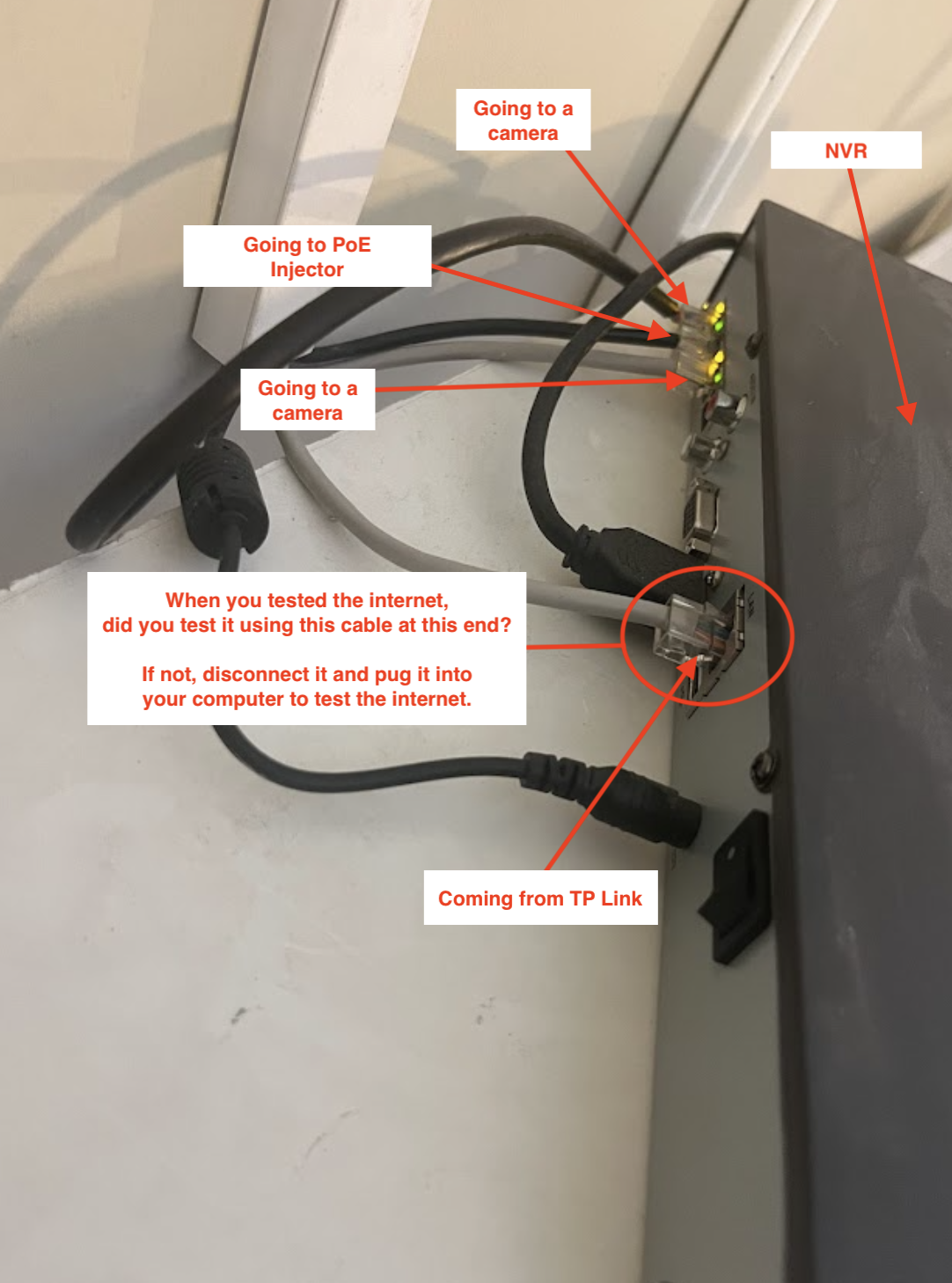

Had these images done before I realized JB got it working for you. Nothing to do on your end but I'll attach the photos as to how I believe everything is connected. (Incase you want to know)

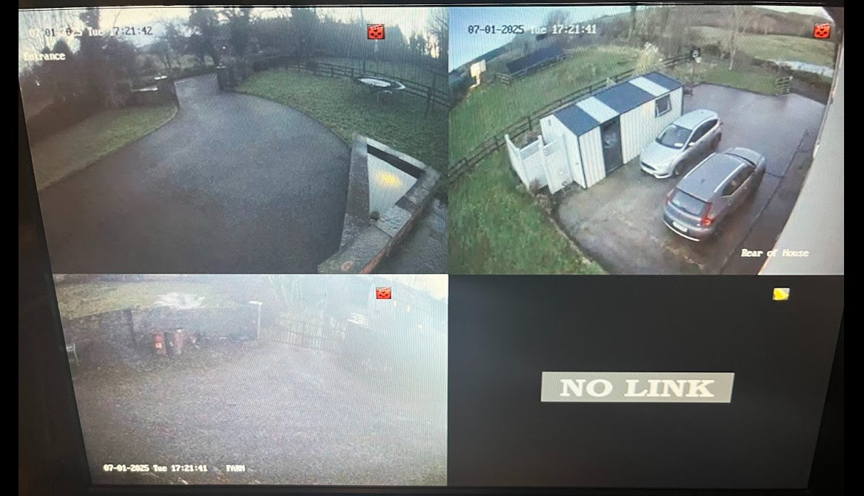

I can see the camera's from the TV which is hardwired to the camera's however I cannot see anything on the app, it just says devices offline.
