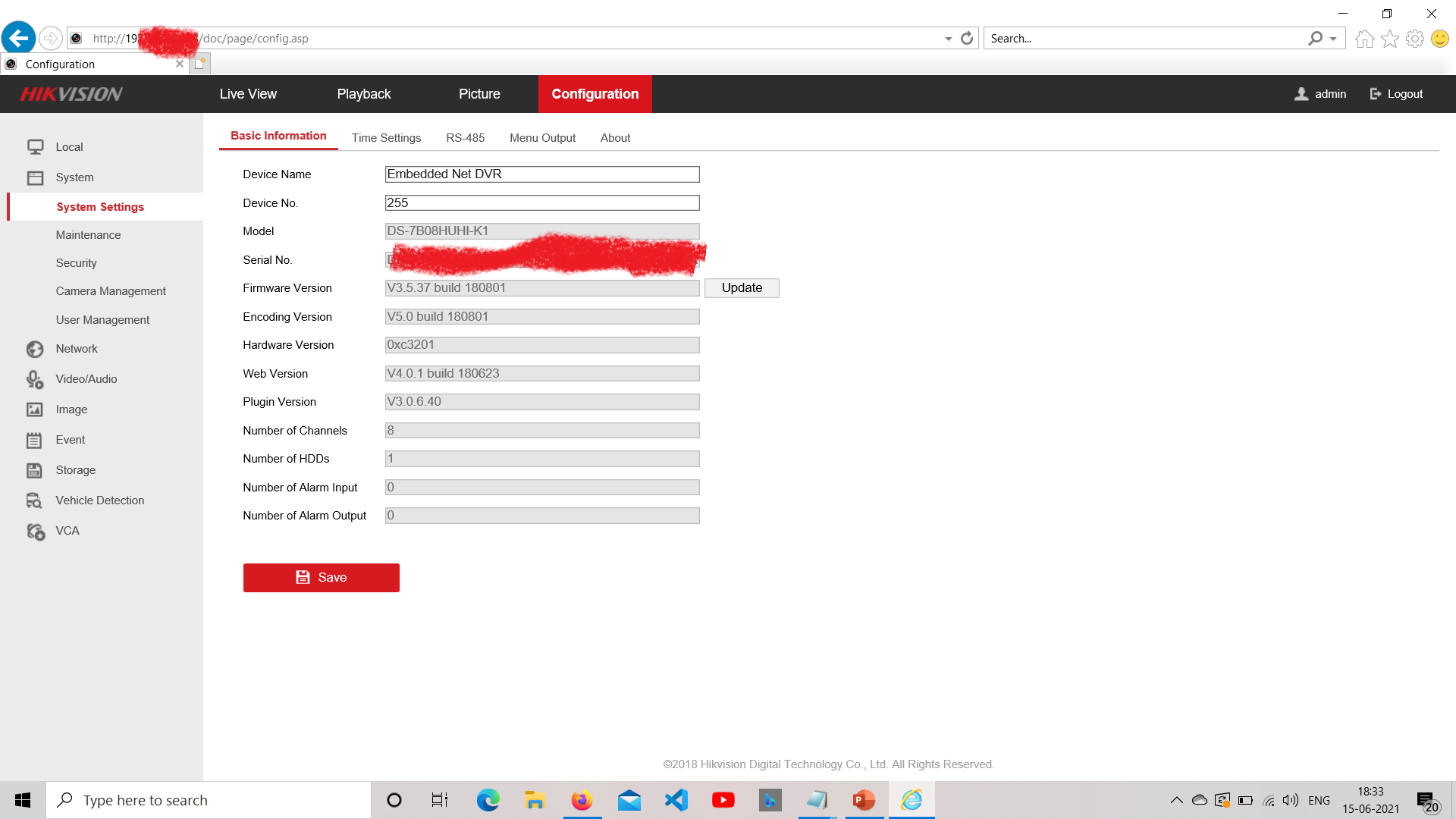

Initially, when I am staring the device for the first time, I gave admin password, security questions, Unlock pattern and other settings. Now my device is locked at these settings. I am unable to change them.
I tried changing my network settings/firmware upgrade/Adding users/any other change I do. I am getting settings were succesfully saved notification. But after Reboot all settings were unchanged. Please help me.
Hi @venkatnrit
It is a DVR model we have never seen before and I can't find any firmware that relates to this model, so all I can recommend is that you go into Maintenance and hard reset the DVR to start from scratch and set a new password, unlock pattern, etc...

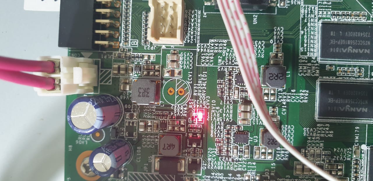

By the way, I am seeing a red indicator on the motherboard. I am attaching the screenshot for your reference. Please let me know if this is of any use to solve my issue.
I have also tried replacing CMOS.
If there is any way using pins on the motherboard if I can reset the DVR please let me know so I give it a try.

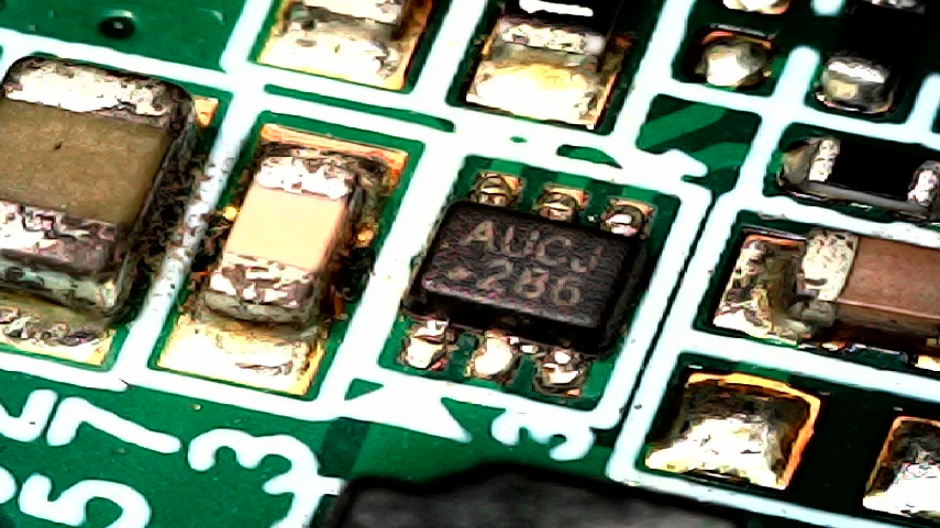

Hello @venkatnrit,
I actually have the exact similar motherboard with a shorted buck converter.
The components are fried up and I am unable to read the markings on top of them.
Could you kindly check the markings for me.
I am referring to the below,
You will find a marking written on the two chips like AUC. It could be different. This is why I need to get them confirmed before ordering.
Hope you could help me out.
Thanks a lot.
