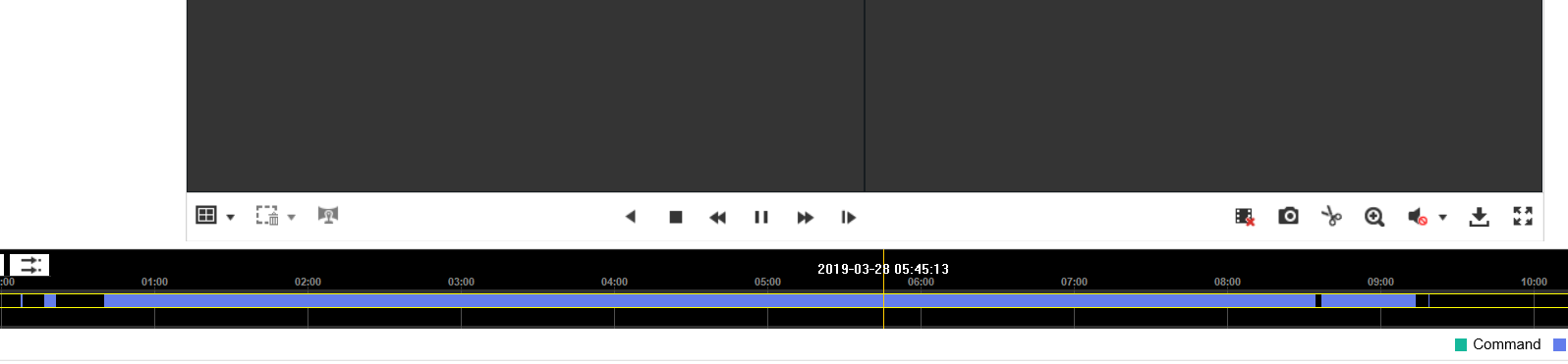

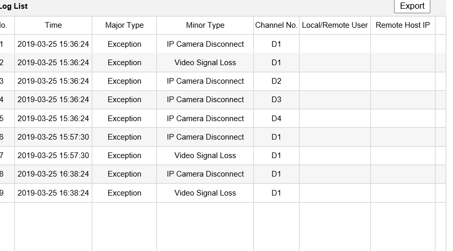

Hi, I have an issue with a DS-2CD2155FWD 5MP dome camera disappearing from the NVR. The camera was fine for 2 weeks, recording and live view, then I noticed i was getting "video loss" alerts from the camera multiple times a day. See image..Yesterday the camera went offline and stayed offline since. This is on the latest firmware, as is the NVR. Both NVR and dome camera purchased from use-IP.

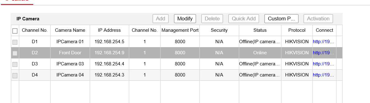

Current state is "Offline : network abnormal" in camera management. (see other attachment)
However the camera is dead on the network - I've run a NMAP scan (same function as SADP) and it finds the NVR and other camera on the POE network range, but not the problem camera. It seems to have no IP in the normal range, so no idea how to discover it.
Setting to manual/plug and play seems to make no difference, it shows "offline: connecting" then back to abnormal.

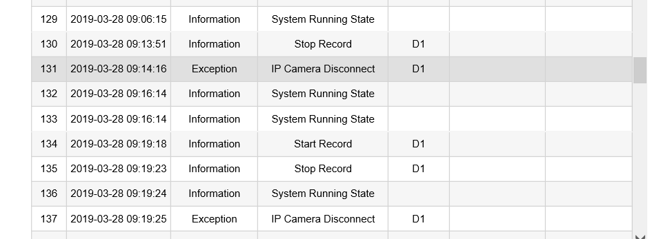

So today I checked the cam again ( since posting on here last night) and it came back online itself for most of the night, then died again around 9am - see the attached images. It just gave a video loss and recording stopped.
