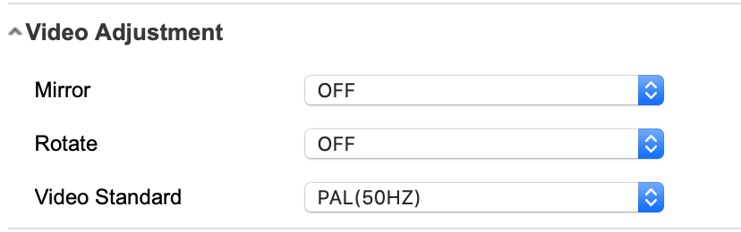

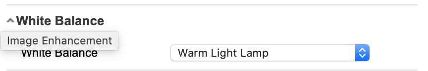

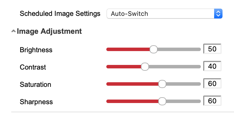

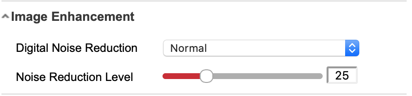

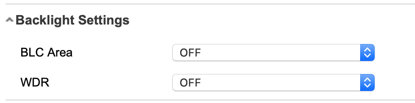

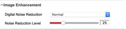

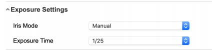

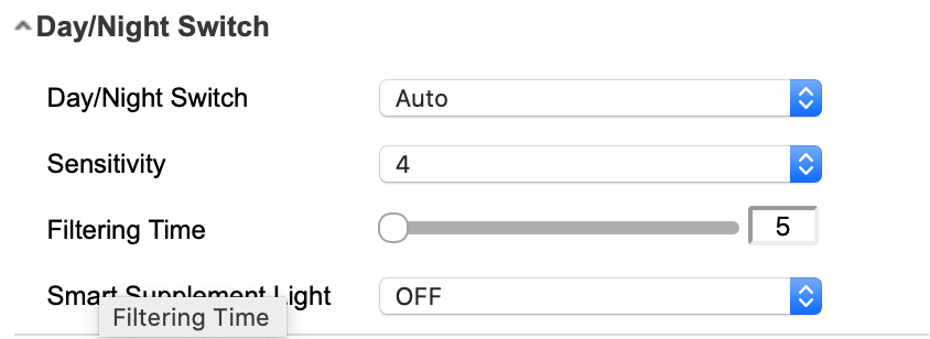

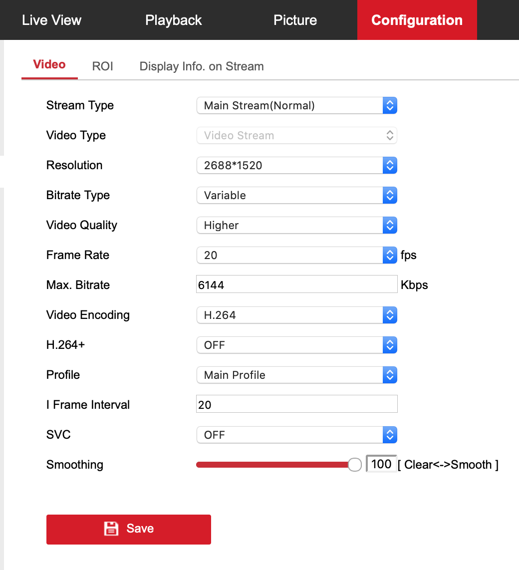

What settings should I adjust to reduce the glare from car headlights during the night?
Is there a good thread that explains in layman's terms what all the video/image settings actually mean?
Please see attachments for the current image/video settings.
Hi @Murfy92
To help reduce glare we usually recommend using HLC/WDR or speed up the exposure time (1/100, 1/250, etc...), but both of these settings will likely make the rest of the scene much darker.
@Murfy92 as @Dan says, I use HLC which is very effective in reducing glare from car headlights, the darker image is acceptable for me.
