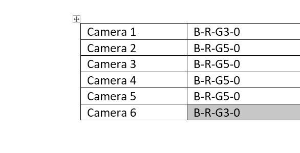

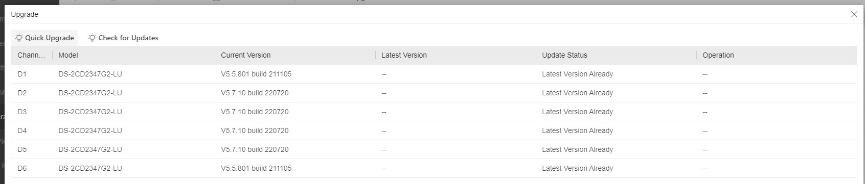

Hey guys,
New here and wondering if you can help as I'm having similar trouble upgrading the firmware for my six "DS-2CD2347G2-LU" s' to the latest version 5.7.10:220720
I downloaded the latest firmware from the Hikvision EU website and successfully applied it to 4 of my 6 cameras, but 2 just won't upgrade give me the same "Upgrading failed" error above.
Could this be because two of the cameras are earlier models? It feels like I've got two different firmware streams to worry about for the same model camera?
Gotta admit, I find this really confusing. Thanks in advance for your kind support.

@JB1970 cracked it with his tip above; they are different Firmware versions, jeez!
