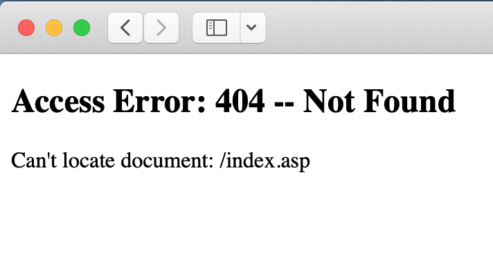

I currently cannot access my DS-2CD2347G2-LU through the browser. I am on Windows 10 and have tried viewing the page using the Internet Explorer option but no luck. All my other older cameras can be accessed.

What exactly do you mean by "cannot access the camera"? Can you log in to the camera but can't access any settings or can you not even reach the login page for the camera?

  2. I cannot reach the login page for the camera, see screenshot.

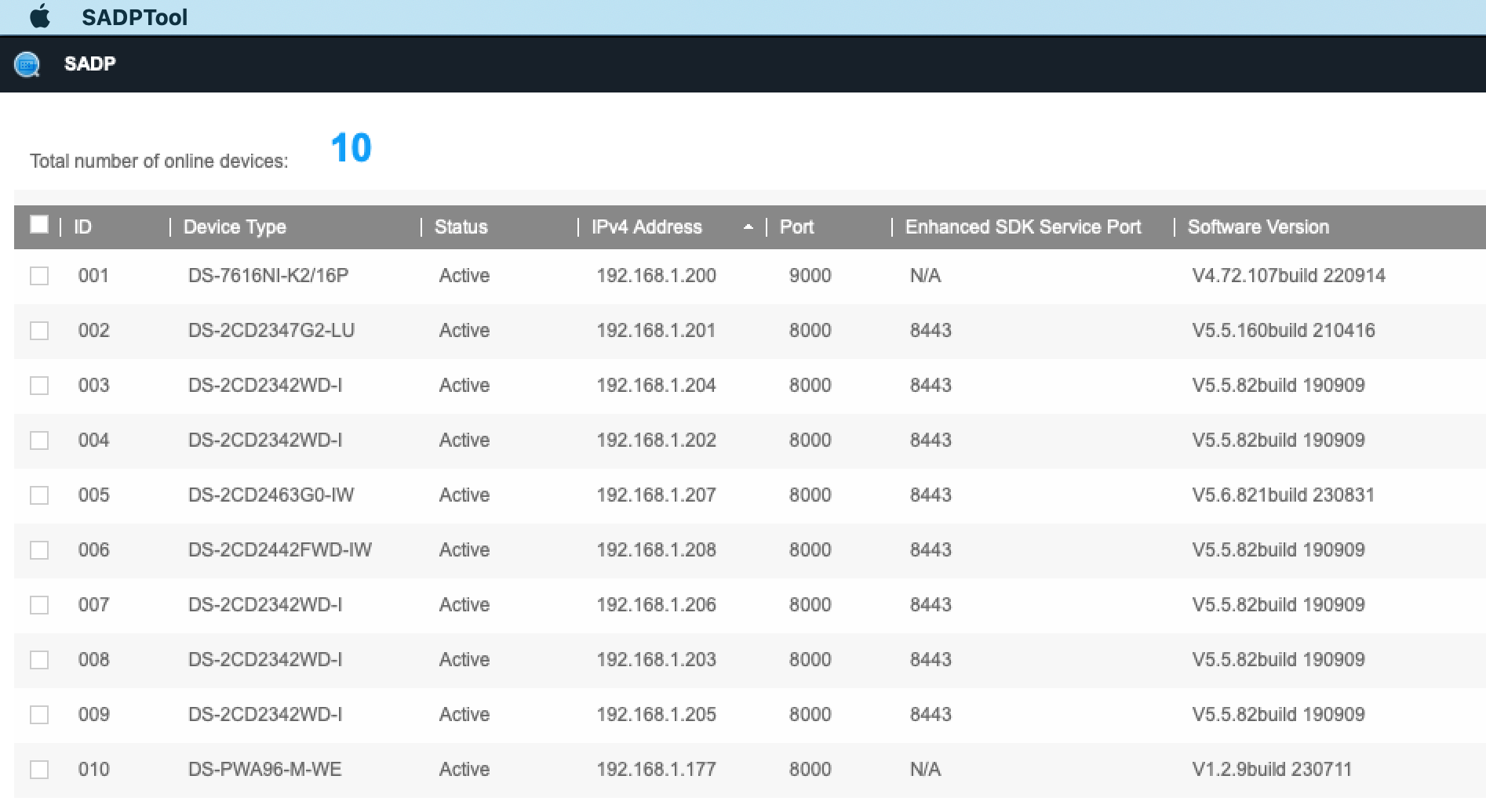

Can you share a screenshot from the SADP Tool showing the IP addresses of your NVR & cameras?

  1. I've tried different browsers Safari, Edge, Chrome and they all give the same error page.
  2. screenshot attached
