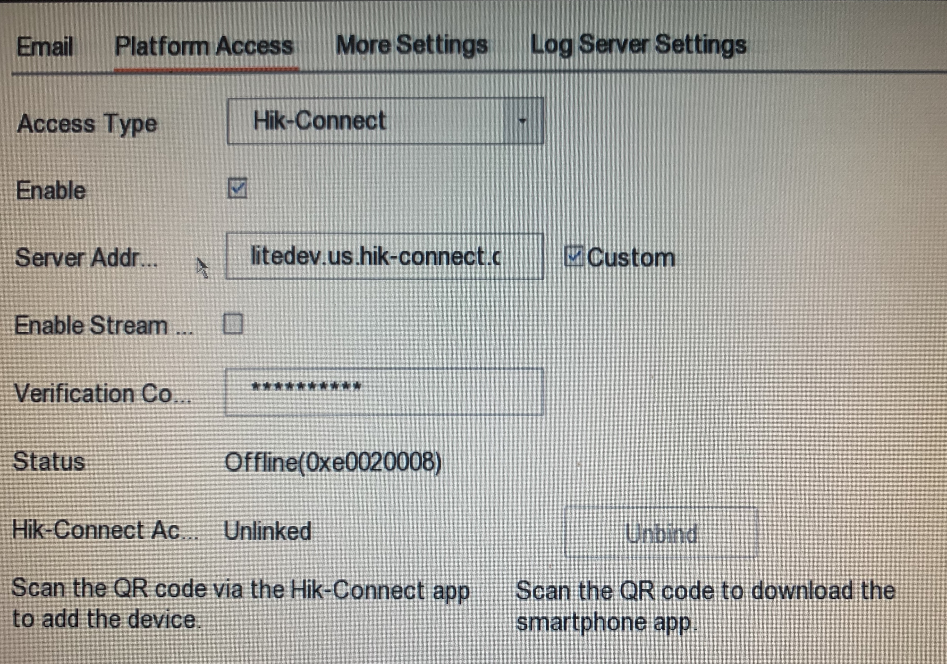

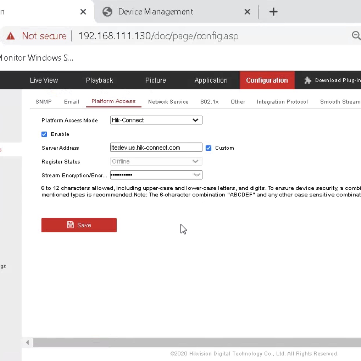

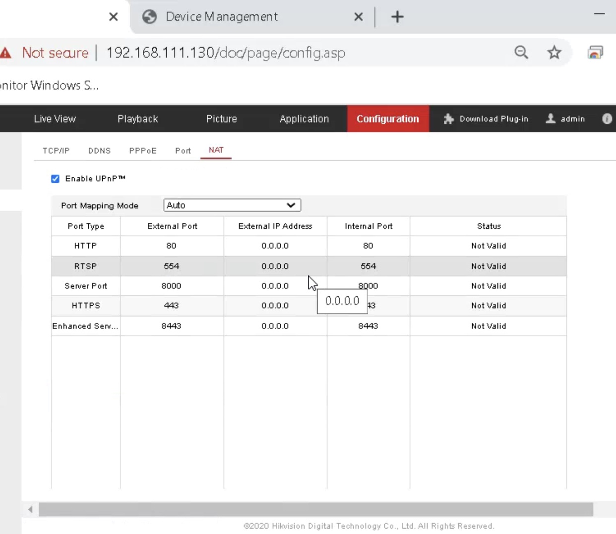

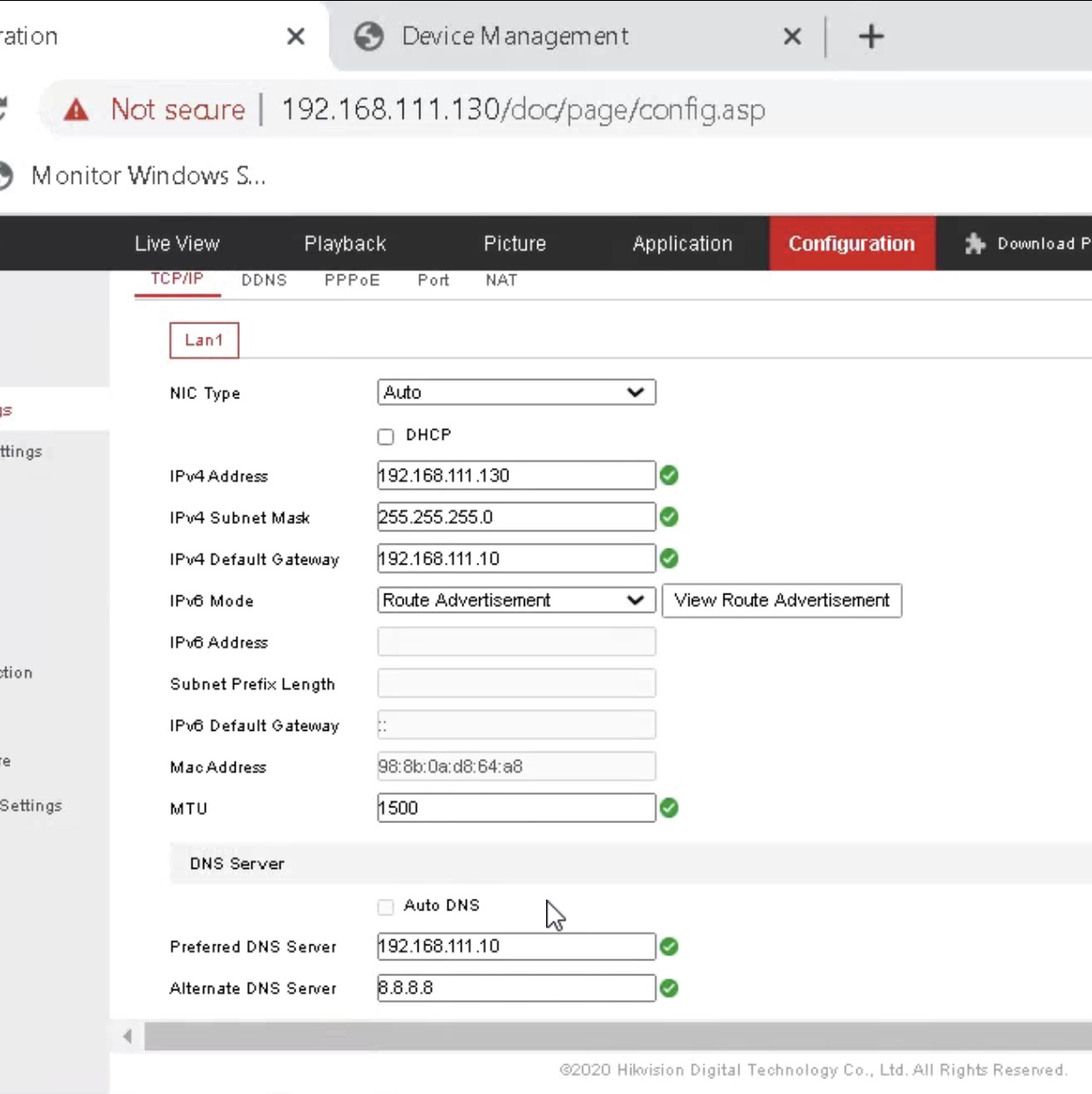

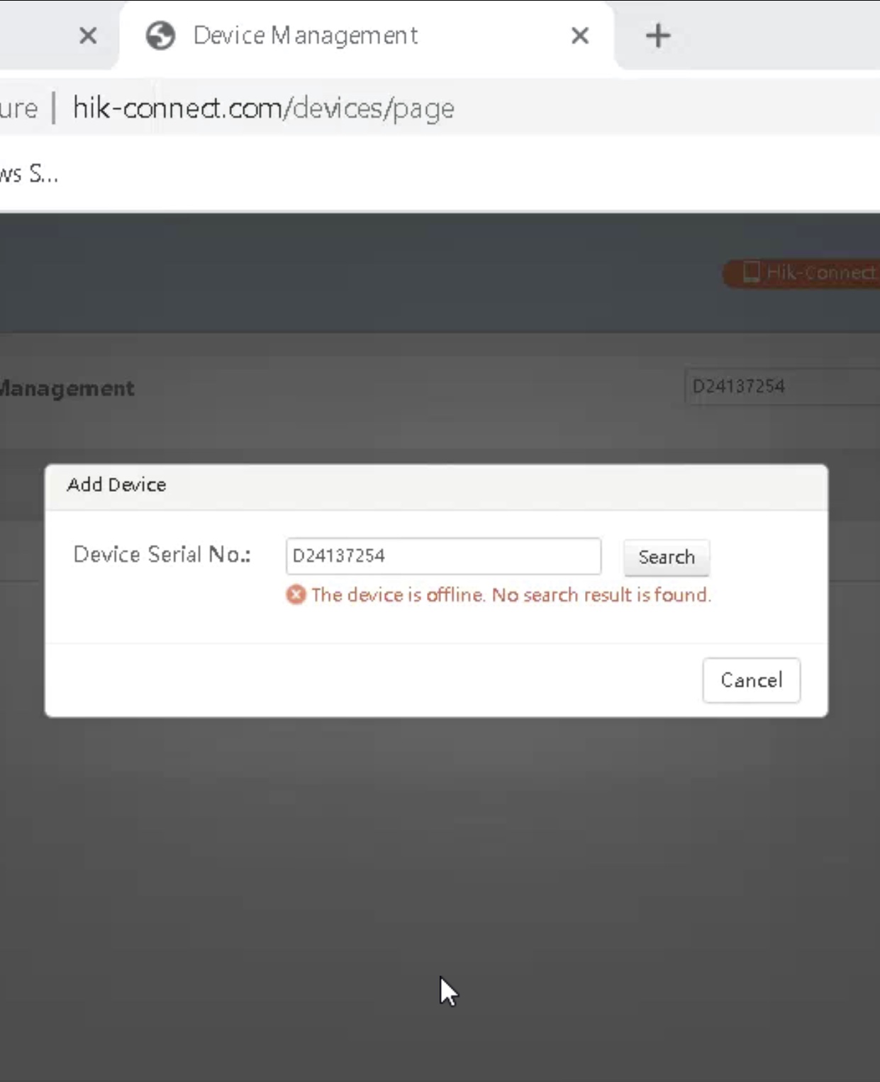

Hikvision DS-7616NI-I2-16P Hik-Connect offline. No settings were changed. What is causing this?
Hackintoshihope
Just a few weeks ago my Hik-Connect app stopped picking up my device and ever since then I cannot seem to get it back online. I’ve attached several screen shots to attempt to help with troubleshooting. Not sure what the issue is. Could any please help? Thanks.

Put DNS to google's 8.8.8.8. That's first step, second ( just for test) enable DHCP and see do your status change.
Exact same issue here, started after a firmware update yet despite reverting and resetting the entire NVR Hik-Connect remains offline.
