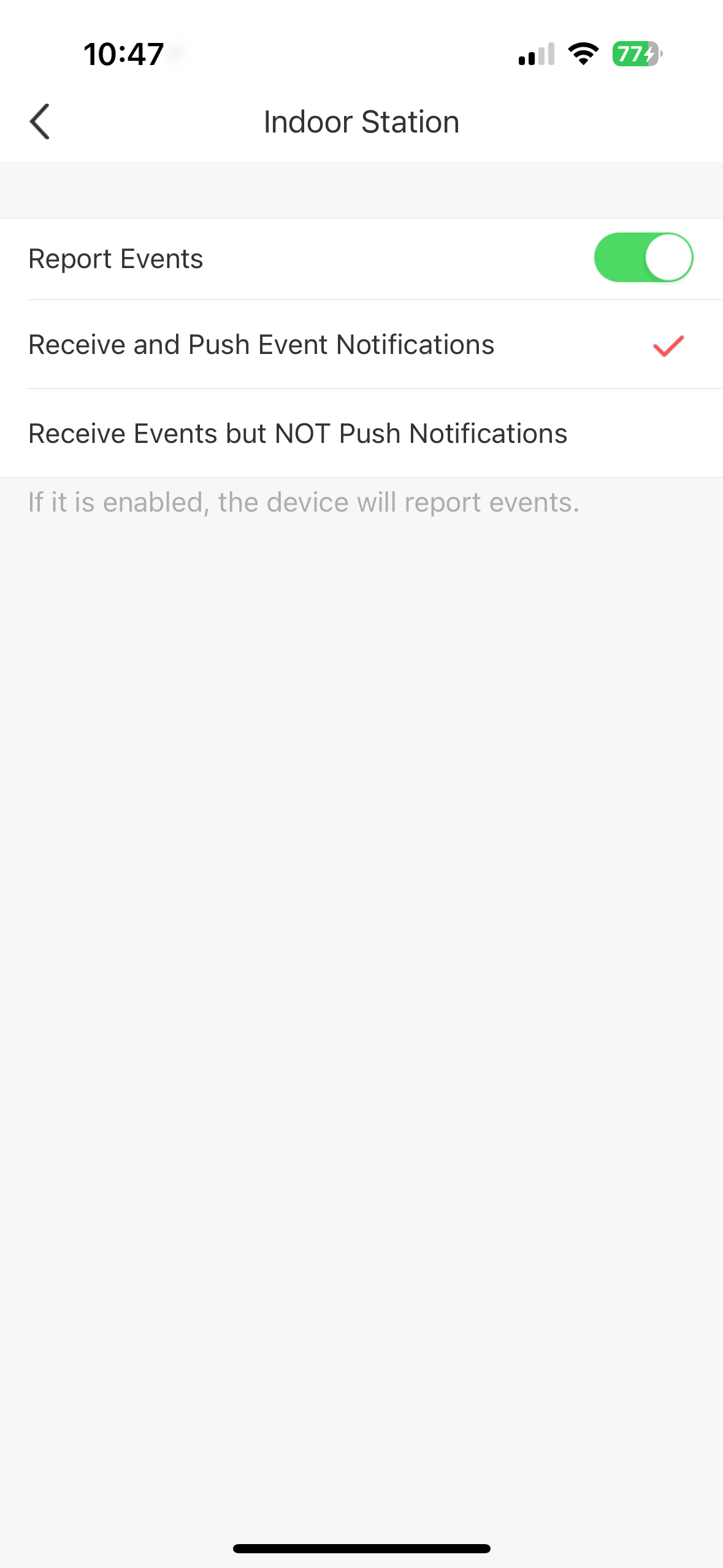

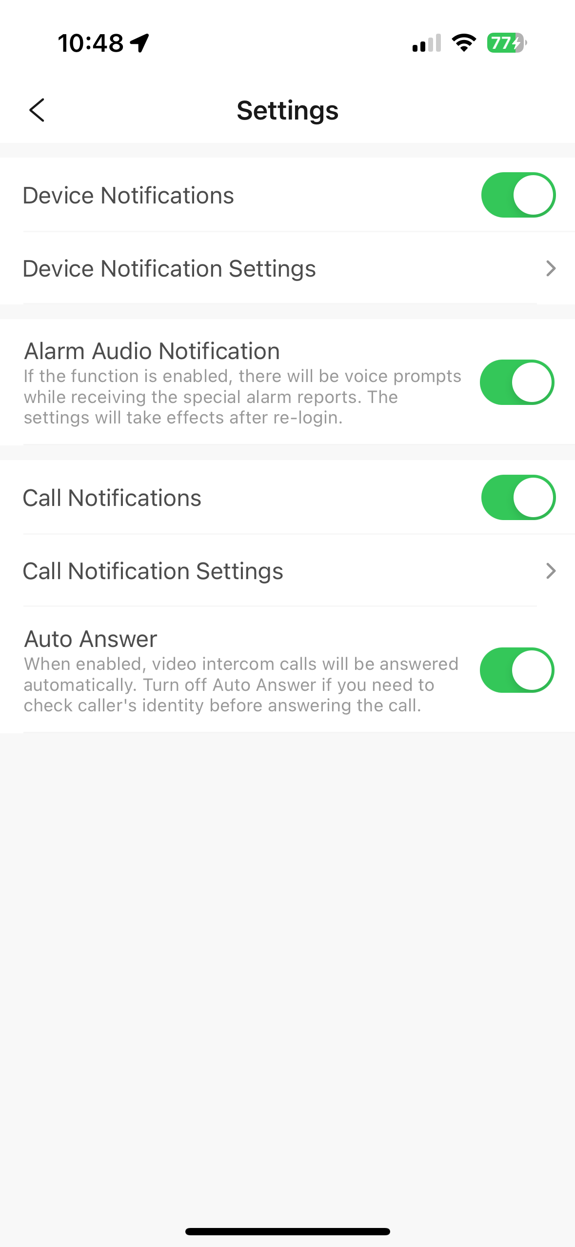

1: i cannot get motion notifications on my monitor or even my hikconnect phone

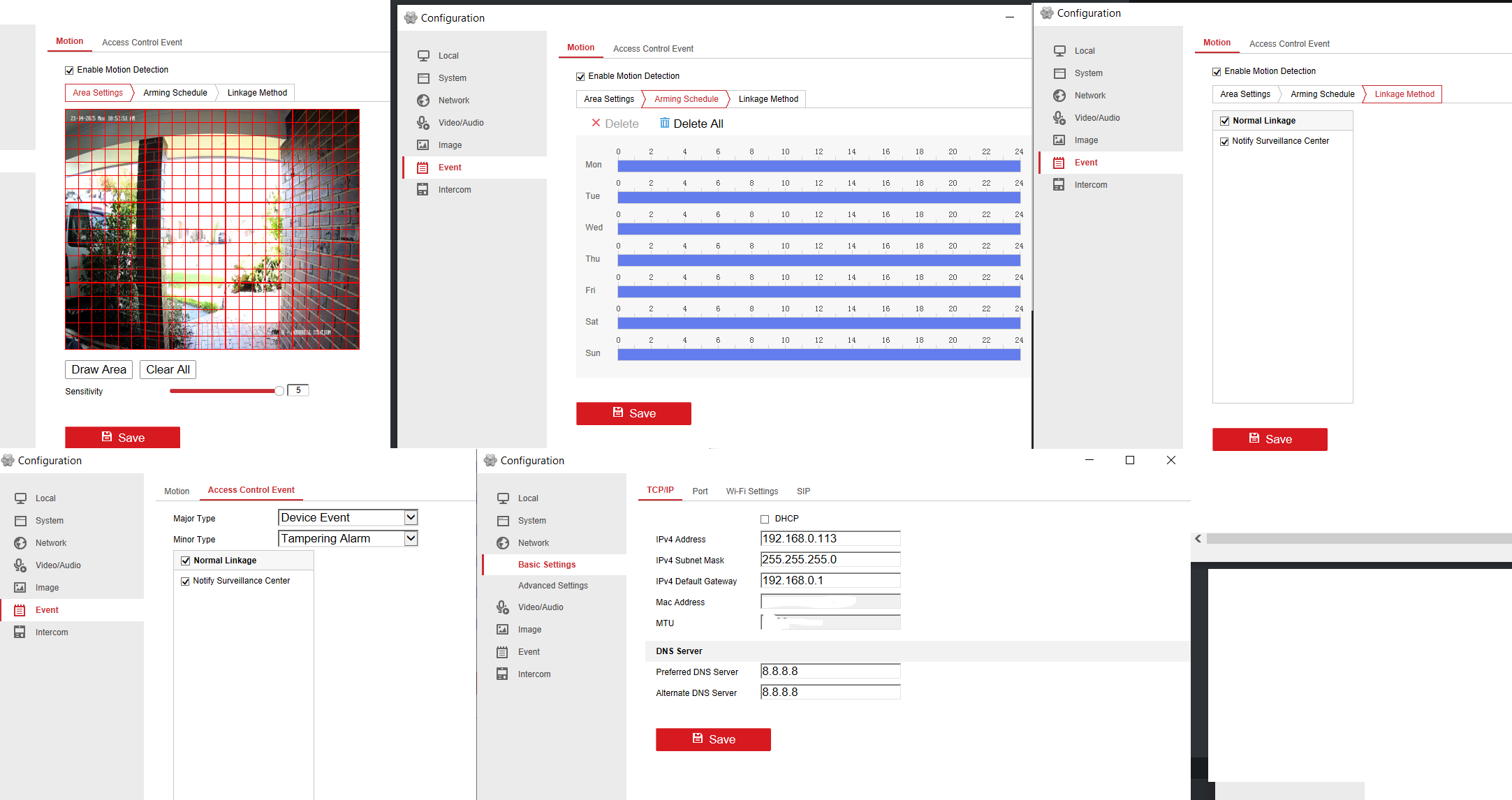

On doorbell settings in IVMS
I have selected the whole grid in red square boxes,
schedule for 24/7
linkage enabled to normal linkage and notify surveillance center
access control - device event: major, tampering alarm: minor
sensitivity on 5 (just for testing)
Hikconnect has been set up with notifications enabled for the doorbell

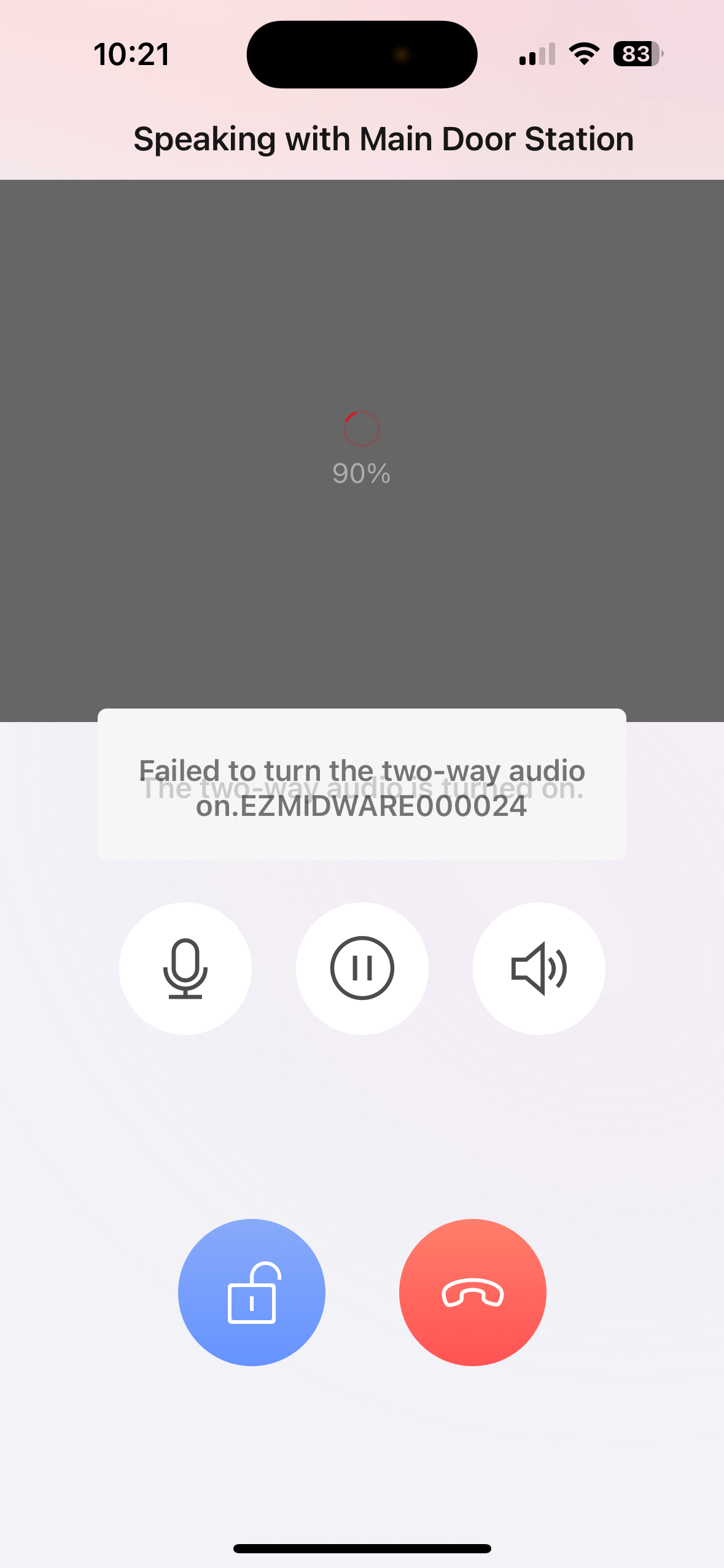

2: when i press the doorbell, and answer via my phone the two way audio fails.

Does DNS settings have a play in this
