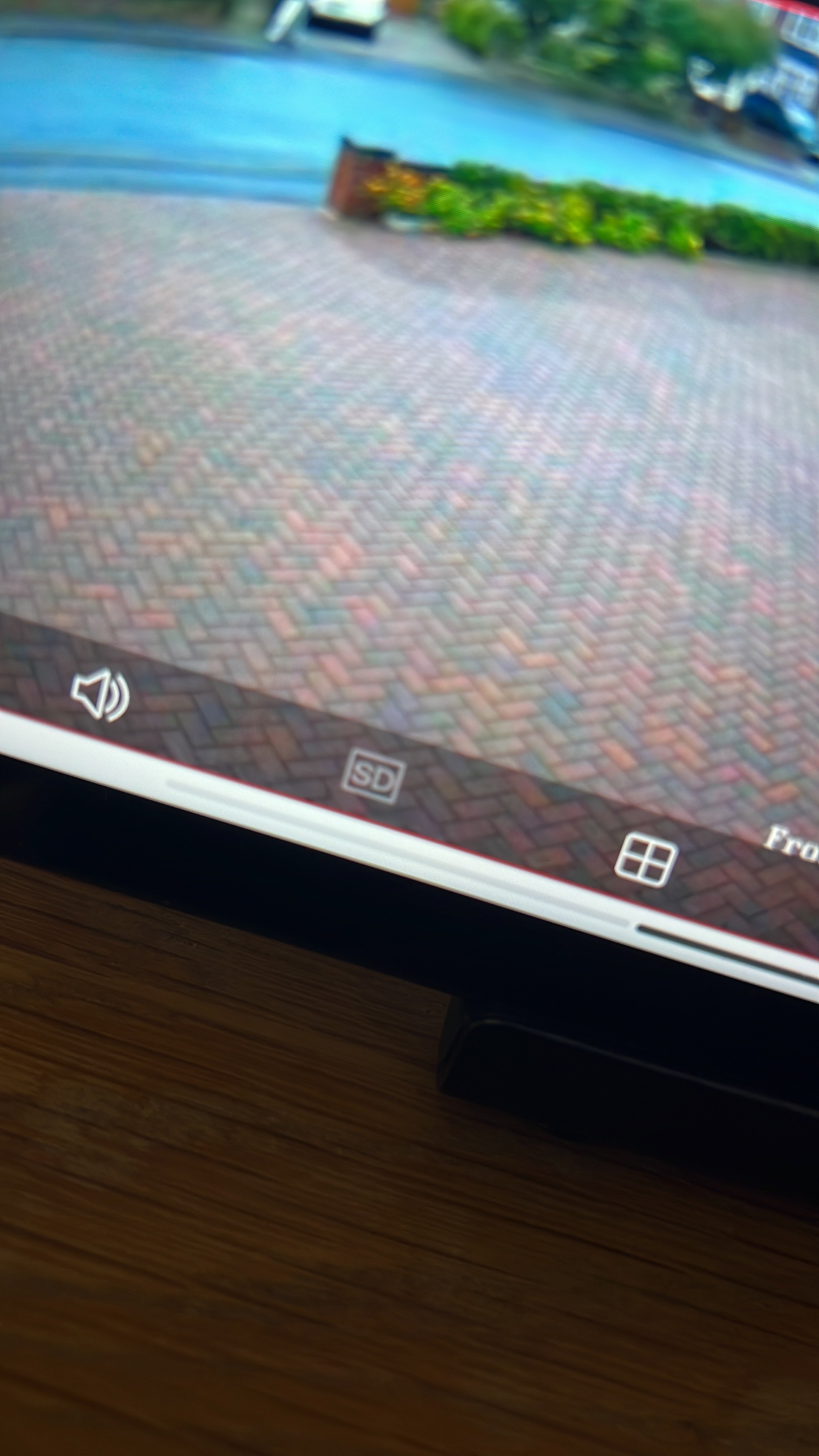

I’ve recently had a Hikvision 8MP 4k camera set up installed, with an always on display enabled on a tablet. It’s been working fine but today I cannot view the multi camera split screen on HD as it is greyed out. When I change view to single camera then it automatically changes it to Hd, but when I change back to a 4 camera view then it goes back to SD with no option to change. Anyone know why this is as it’s been working fine for the last week? Thanks

I think this has been done as a default now in Hik-Connect, to use the sub-stream when displaying multiple cameras. HD for me also greyed out. I would say that this is to reduce overhead and potential issues trying to display multiple cameras at one go.
Yes, my installer has confirmed the same. I only use on a small tablet screen so from distance you can’t really tell the difference but close up u can.
