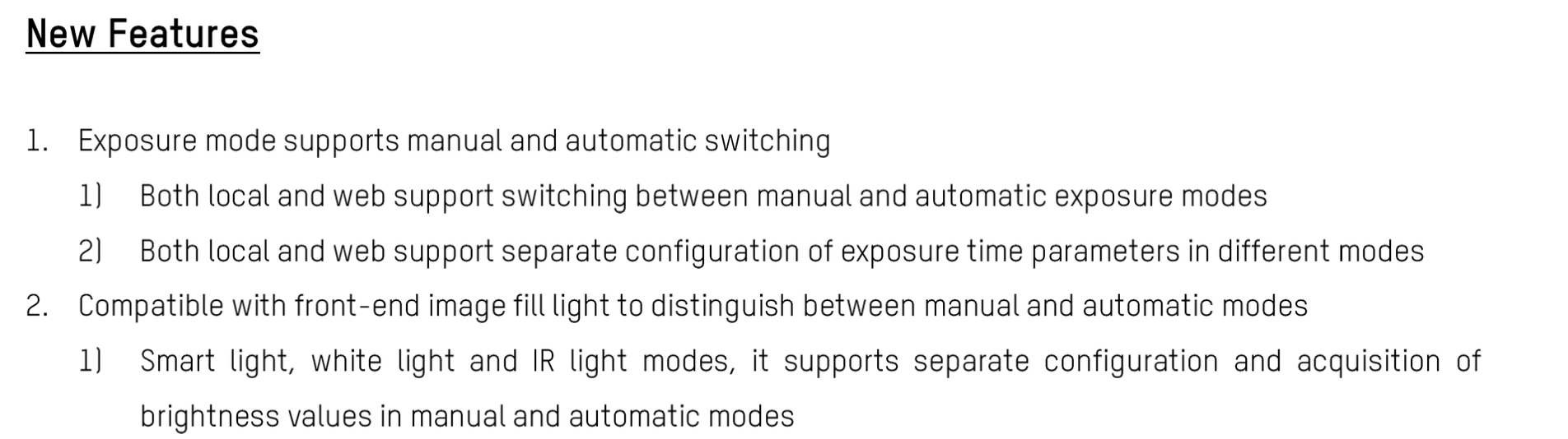

I think I noticed it on V5 on my VPro but I haven't tested/checked it since the last update. A bit of a long winded explanation follows......
On previous camera models the exposure time setting is not fixed per se. If you set it at 1/50sec then 1/50sec is the longest it will go but it can go shorter (to prevent the image whiting out). So setting the exposure time via the NVR with the older model camera was fine.
On the newer ColorVu 3's you have automatic exposure selected by default and you can adjust the range. It's basically the same as above but you can set both the longest and shortest exposure time for better control. Manual exposure on the ColorVu 3's is a fixed setting so would only be used in a constantly illuminated scene.
In my setup a G3 was set to automatic exposure with a range of 1/10,000sec to 1/50sec. In the NVR I made an adjustment changing exposure time to 1/100sec. When I checked the camera I expected the range to now be 1/10,000sec to 1/100sec but it remained unchanged. However when I switched the camera from auto exposure to manual I found that the default manual exposure was now changed to 1/100sec (even though it was not in use at the time of the change). It's as though the NVR exposure control was mapped to adjust manual exposure on the camera even though auto mode was in use.
I guess that this could be an issue for multiple NVR firmwares where cameras with the auto exposure capability are deployed, until NVR firmware is updated to suit newer cameras. I did notice the changes in the screenshot below for the latest firmware on the 76xx-NXI-Kx/P NVRs (4.84.100) which may fix it:
So when altering a ColorVu G3's exposure time via the NVR it's worthwhile double checking that it has changed the longest end of the range for auto exposure in the camera.
